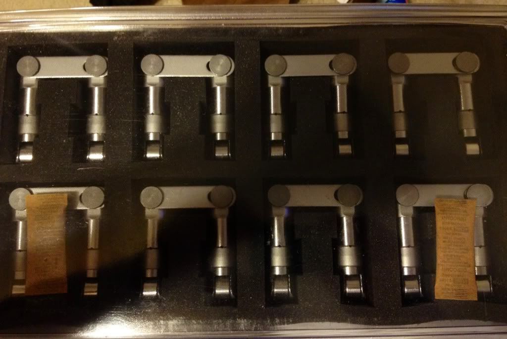

Morel lifters also come in a good looking package. If they were thrown in a box or something, that could be the issue. But they are all separate in the packing I got.

Yup they package the **** out of them. Now if you take them out and leave them outside of packaging for a day or so you'll get light surface rust. But a cloth, oil, and some elbow grease will knock it off. Post up some pictures.

No, that's not normal at all. They should be delivered as Jake has illustrated. Clean and rust free. Someone probably sold you some returned inventory or something.

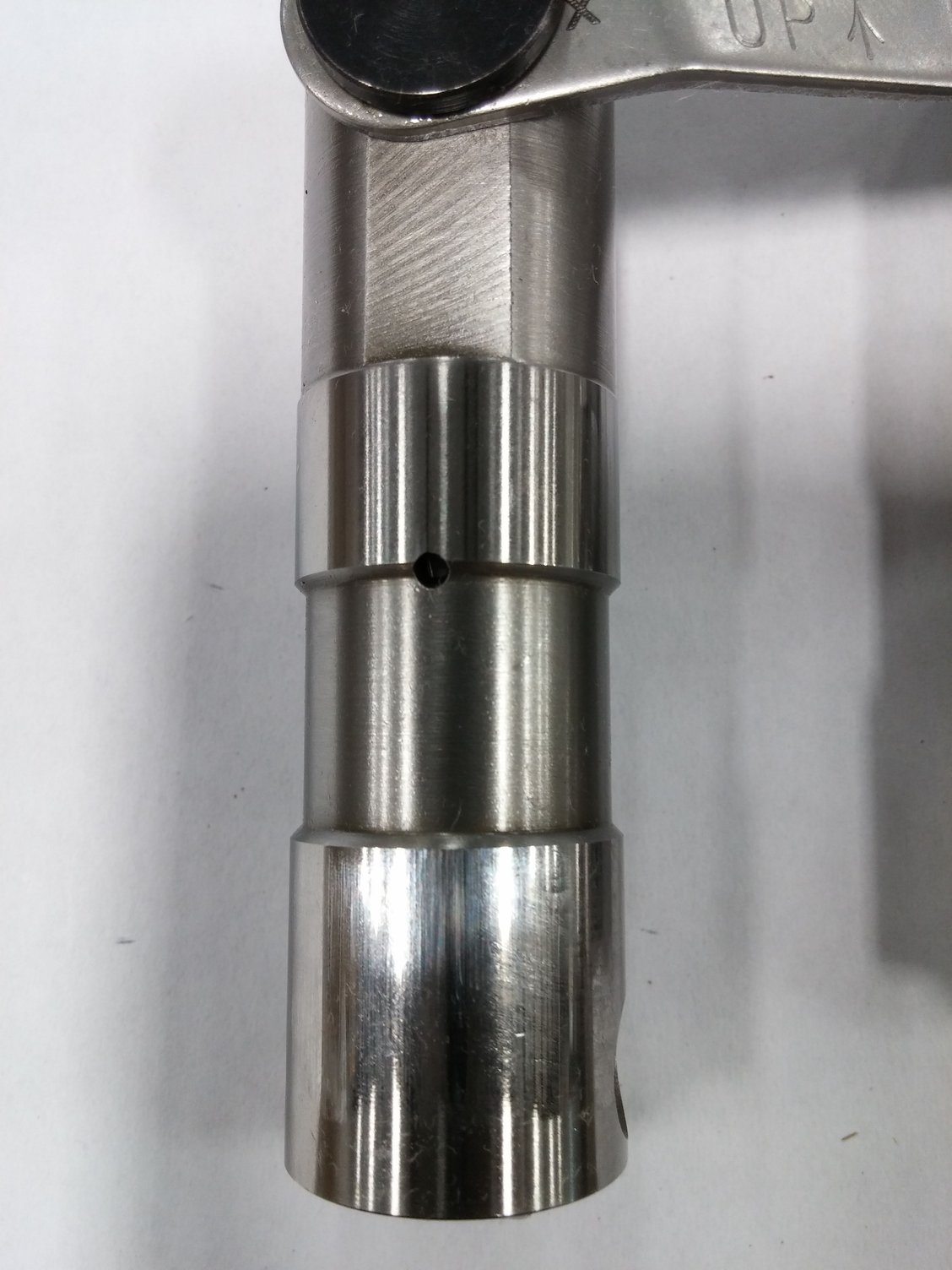

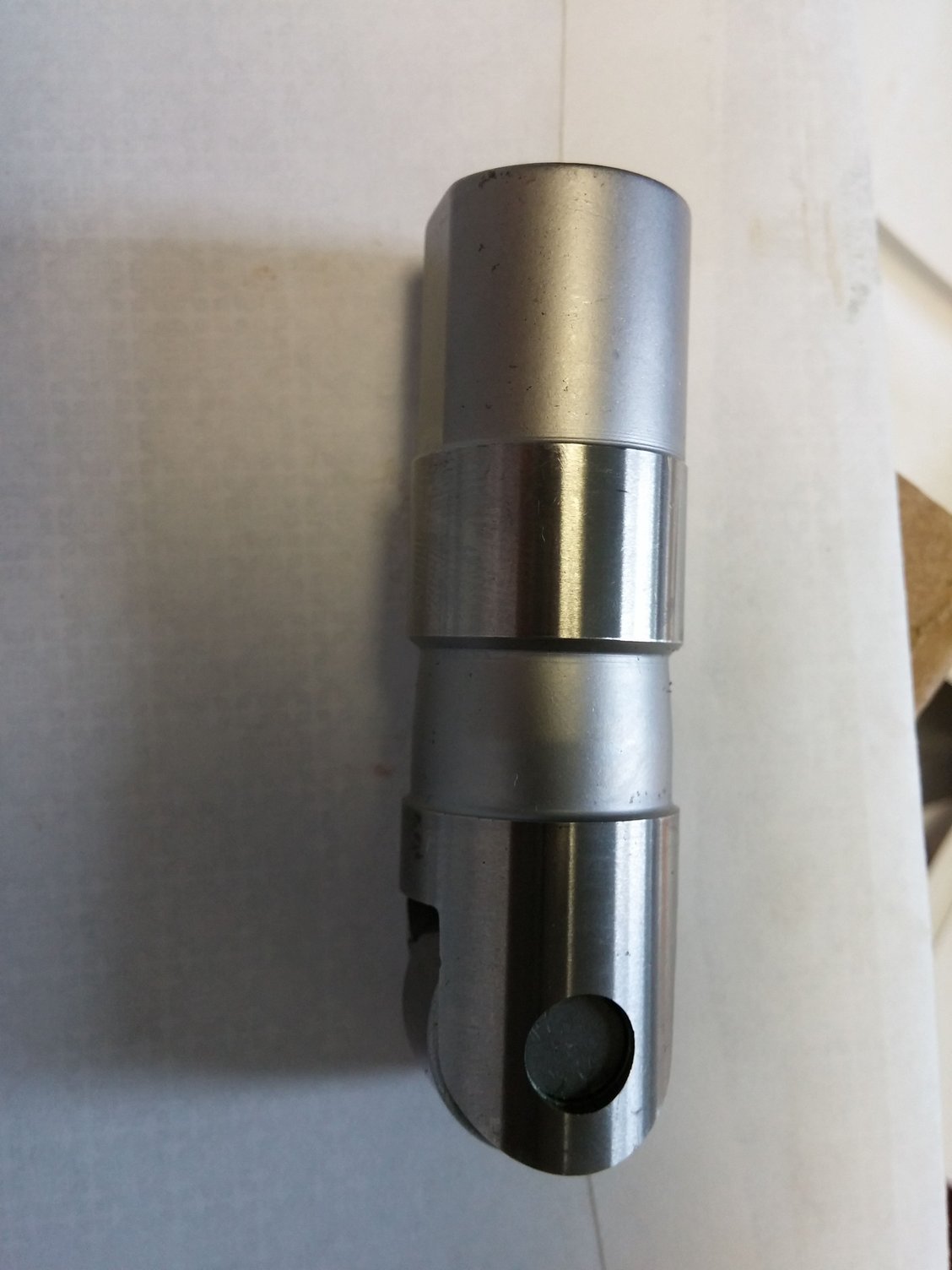

Picture of the worst one:
Picture of the average lifter:
Clearly you can see they have not been run. I told the vendor if the customer did not want them to send them back. I also said if he wanted I would give him a break on pricing if he wanted. The date code on this lifter set is 5/11/15.
We pulled on 4 sets on the shelf and they all show signs of the tarnish. All the same date code.
I am at a loss on the "dirt". I can't find it.

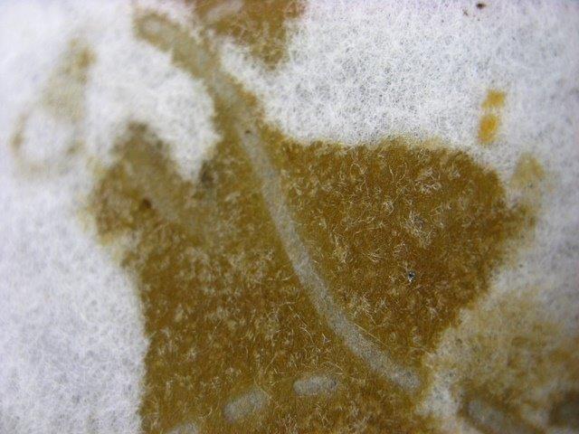

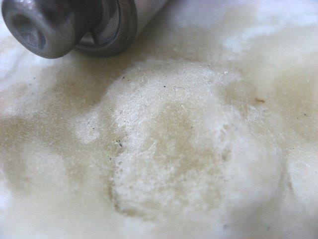

The "Worst" lifter I took out in the shop and used the following:
WD40
Card Board from a white unprinted box. In 8 minutes of cleaning the lifter it now looks like this:

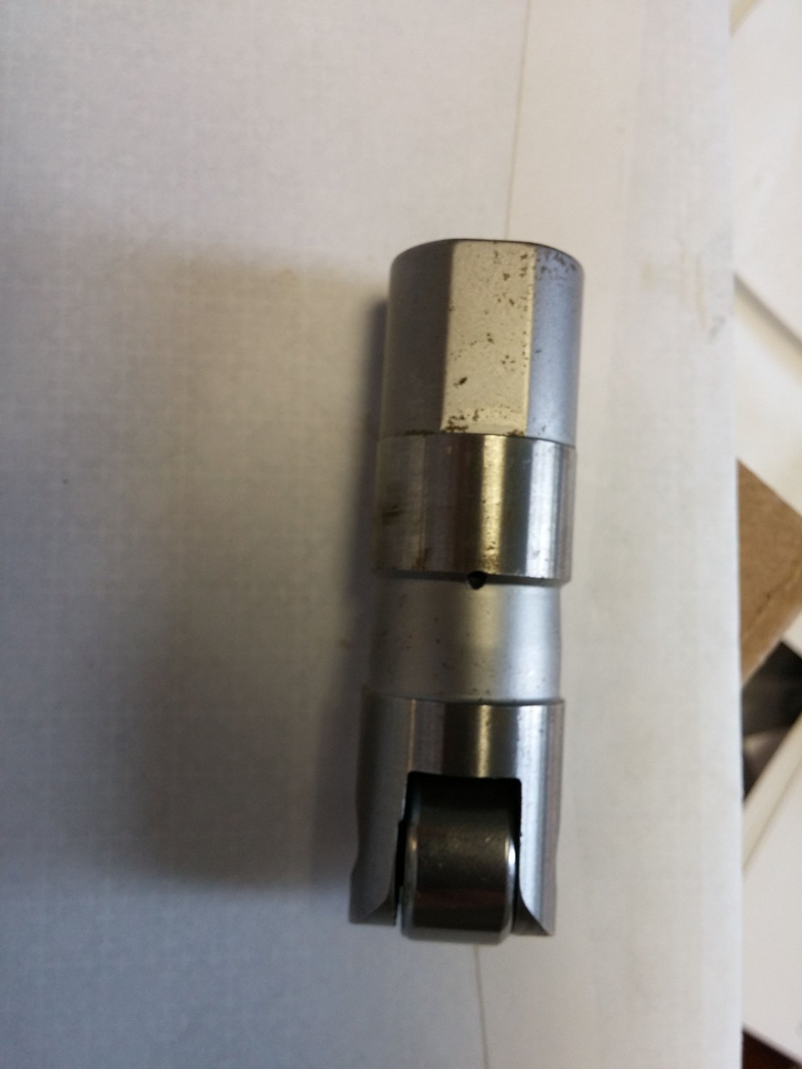

This is what a lifter looks like when it has been run......

I have inspected the entire set sir. They have never been run. There is nothhing the catches the fingernail that my 46 yr old eyes can see with a set of CVS $20 foster grant 1.5X readers. The "Crud" you speak must be the foam "lint" that is in the packaging. Morel spent a lot of money on that package and it works great but the parts must be cleaned when they come out.
Now should they have tarnish, no. It's a battle with a fully machined part in a non HVAC warehouse. But as you can see just a little elbow grease and the lifter cleaned up. I took care of the LS1 Tech vendor and told him whatever he needed to do to make you happy.
This is the set that was returned. As you can see it has the shipping date clearly on the label:
Good or bad I own up to either. My reputation means more to me than the almighty $. So I am not going to ignore a post like this. I took care of my customer.
For the record I buy direct. I do prefer to be off the radar. If you knew I was the supplier then all you had to do was pick up the phone. 28 years of being in this industry I still pickup the phone.
