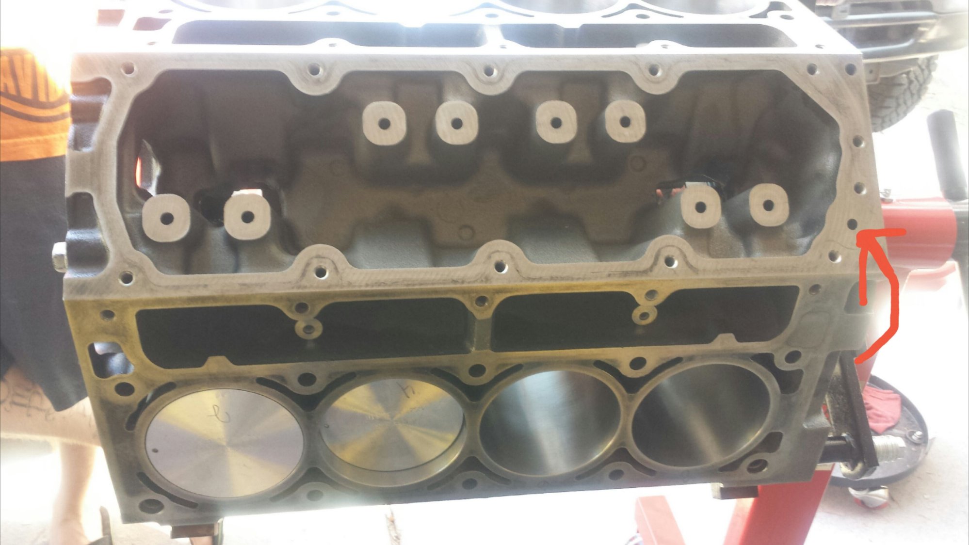

This is the motor before it went in. Pressure sensor looked kinda funny to me, is that right? It's a gen iv lq4 with donor parts from the 04 gto.

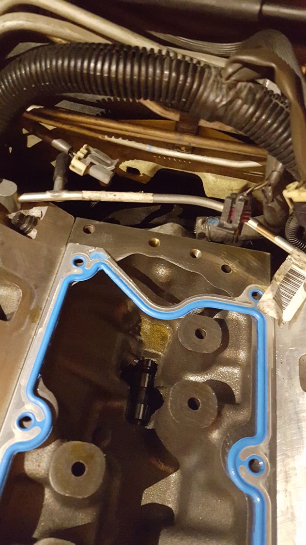

So the oil pressure sensor is supposed to go into this hole correct?
Old Aug 22, 2015 | 12:11 PM
z28mobbin's Avatar
Joined: Nov 2011
Posts: 20
From: Las Vegas, NV
Originally Posted by shoeboxvette
Possibly the wrong gasket for the valley cover?? They have a couple of designs.
And the winner is...... shoeboxvette lol.
What a stupid mistake lol but i appreciate the help and ideas and all. Thanks everyone.
