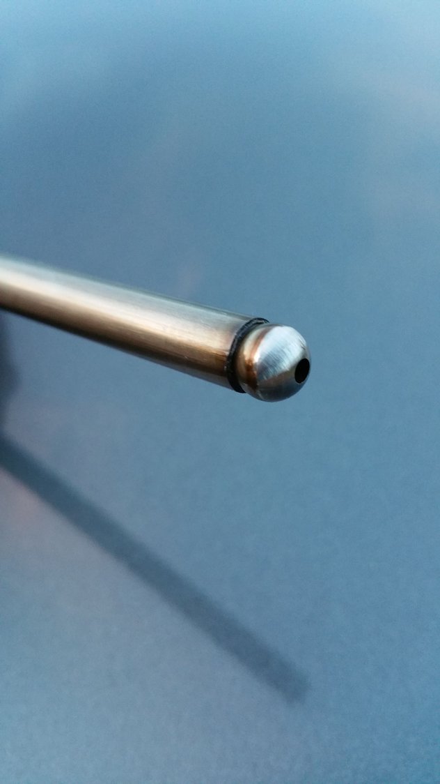

70k miles. Engine has loud tapping noise. I bought it with the noise already present. So far only thing I see is one pushrod that looks scuffed compared to the rest that look polished. I haven't gotten the heads off yet.

It's worn, it's relatively common - that pushrod and usually the rocker as well should not be reused.
Use better oil when you get it back together.

Most likely you have a dirty blocked lifter not feeding enough oil to the push rod-rocker assembly. You gotta run something to clean the system, replacing that won't change a thing it will just wear again until you get oil up there.
