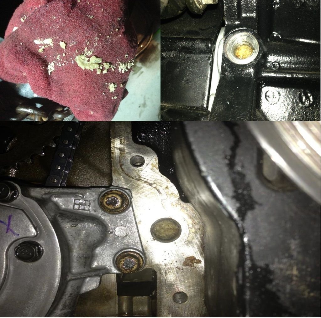

Make sure you change the oil filter asap as it will be clogged with the vaseline and any other assembly lube/greases

Fired it up and had 55psi at idle!!!
Old Sep 20, 2015 | 08:41 PM
dburt86's Avatar
Joined: Jun 2015
Posts: 498
From: CT
Got it hot, bleed the coolant and changed the oil. Found a huge mass of vasoline sitting on top of the filter. Wont be doing that again.
Took it for a short ride, get it the gas station and check the pressure and its like 5-7psi.
Bring it back to the shop, still 5-7 psi. Engine sounds great, has good power and pressure rises even barely touching the throttle.
So i shut it down and restart it like 4 mins later and the car has a steady 25psi at idle. I let the idle car idle for 10-15mins and the idle stayed consistent at 25psi at idle.
Not sure if its the guage or just more vasoline was messing with the pressure for a while, or whatever it was, but hopefully it stays at 25psi.

Yeah guys, I don't know where or when in history it became "a thing" to pack an oil pump with Vaseline or grease but it's not a good thing nor does it help anything. An oil pump can't pump oil when there's some sort of grease in it. Imagine-a freshly built engine that can't get oil because of this stuff in the oil pump.
dburt86, now that you have good pressure and you're flushing the rest of that stuff into the second filter, time to perform one more oil change. Reach for a better filter such as Wix, Hastings, Mobil1 Extended or K&N.

All I know is that when I took the filter down, there was a 1x1x3 mass of vasoline on top of the filter. Looked like a huge slug.
Paul, I think ur right. I'm gonna do one more change with good oil and good filter.
Any thoughts on the intermittent low pressure? If it's not the pick up oring, then what else could it be?
