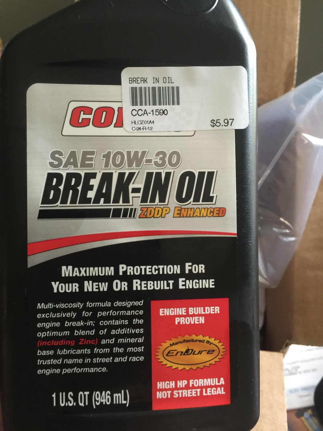

Went with Comp cams break in oil instead, several people I know have used it with good results. Was going to try Joe Gibbs but I had an order with Summit Racing, added this to it.

ZDDP! Mmmmmmmmmmmmmmmmmmmmmmmmmm........................ , yummy!!
