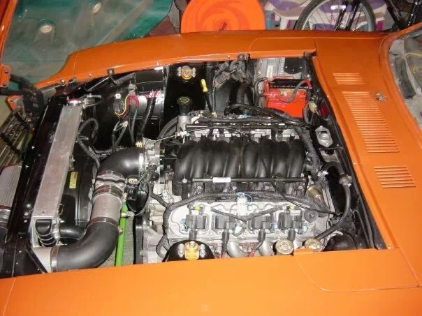

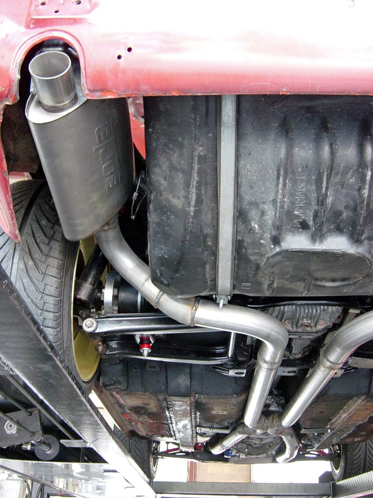

Already have the valve spring tool, Balancer installer and remover tool. Plus I made in front cover center tool I made from a old balancer from a 04 CTSV I had.
Car has 1 3/4" headers and a custom 2 1/2" mandrel bent duel exhaust with X pipe and Borla mufflers.
I did the ported oil pump and double chain when I put the Z06 cam and springs in.

Also use a Camaro gas tank.. <br/> And Q45 rear end (3.55 posi gear) with CV joints and aftermarket axles.
