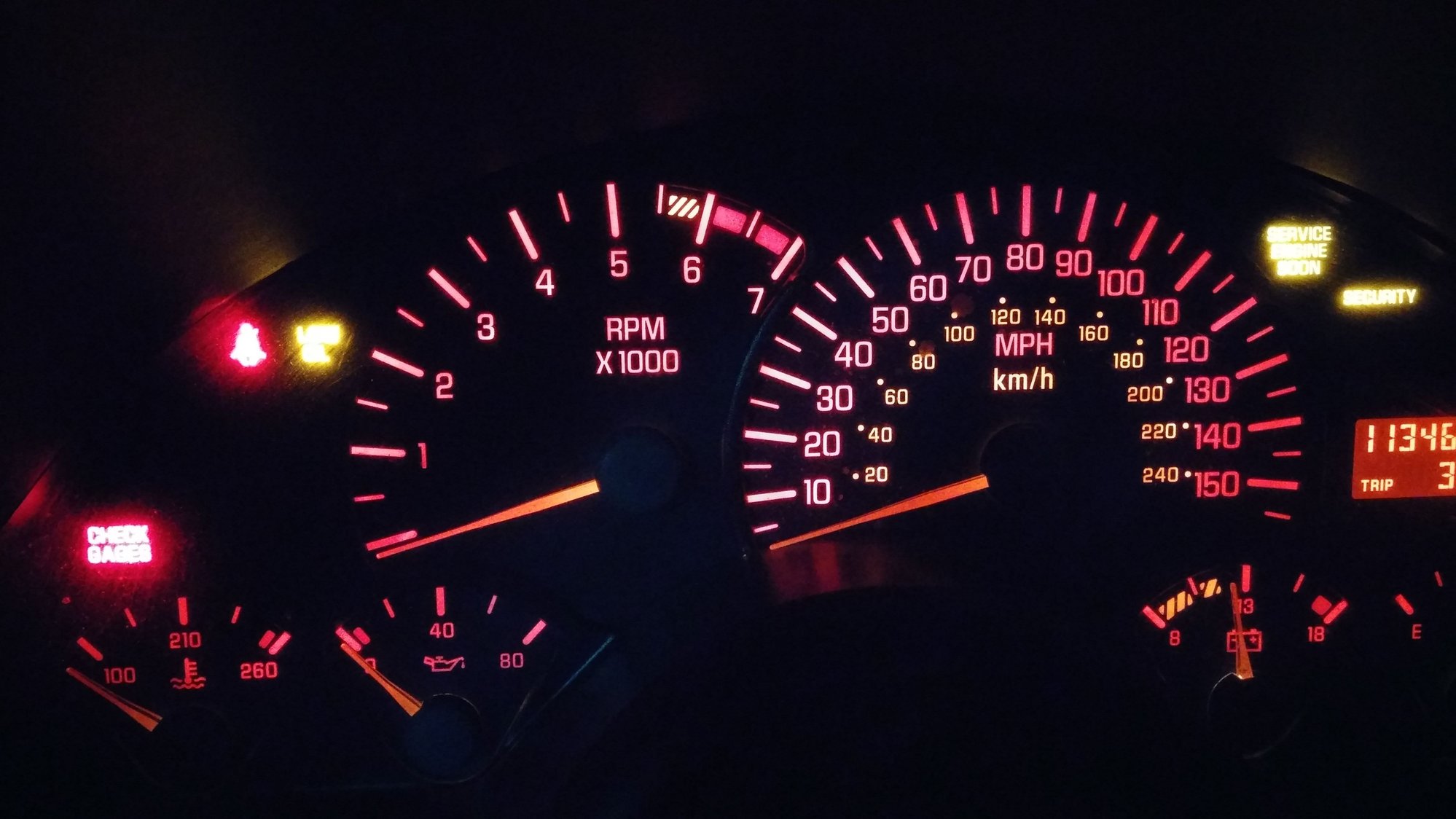

I have a '01 ws6 6-speed. Leaving work and tried to turn on the car. All I hear every time I turn the ignition is a thud. I fear that I might have lost oil causing the engine to break? I checked the oil and it was low, not empty but low nonetheless. The battery should be good its a year old. I don't hear clicks just a "thud" sounds. The pic is the cluster when the ignition is ON position. Had to leave the car at work. The low oil, security, check engine, check gauge light are on.

Pic of the cluster doesn't give any info. Its not running. Pull the spark plugs and try to crank it again with no plugs in it. You may have a water or fuel leak filling a cylinder and hydro-locked it.
