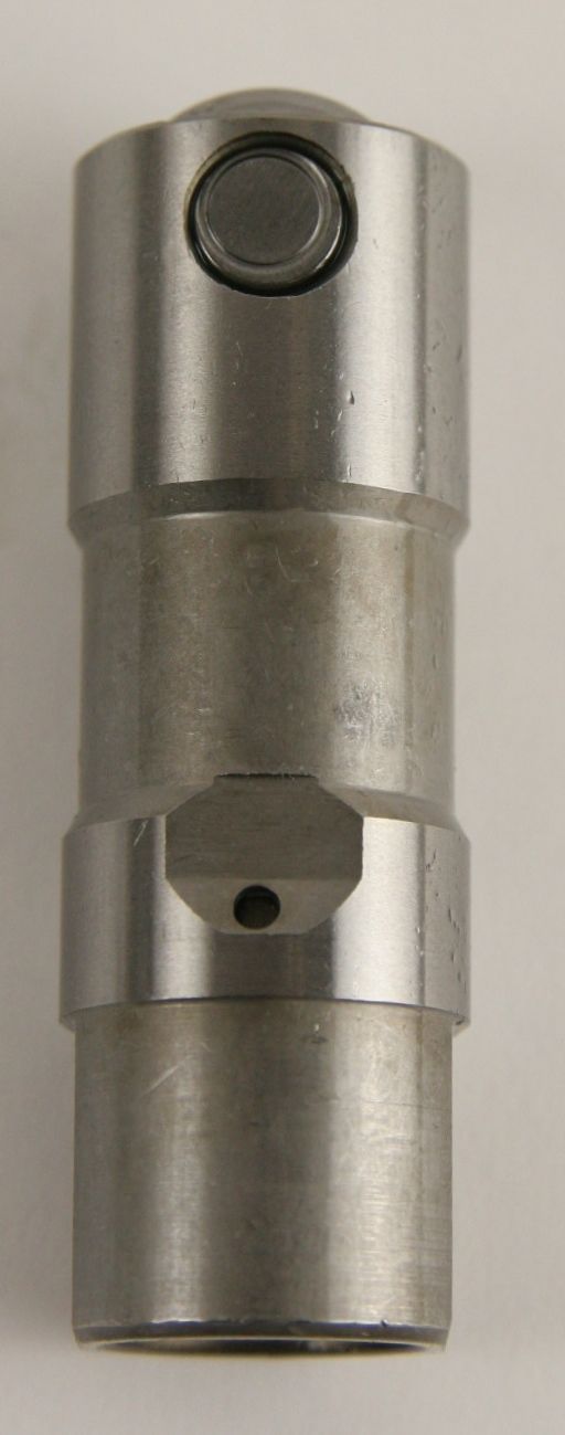

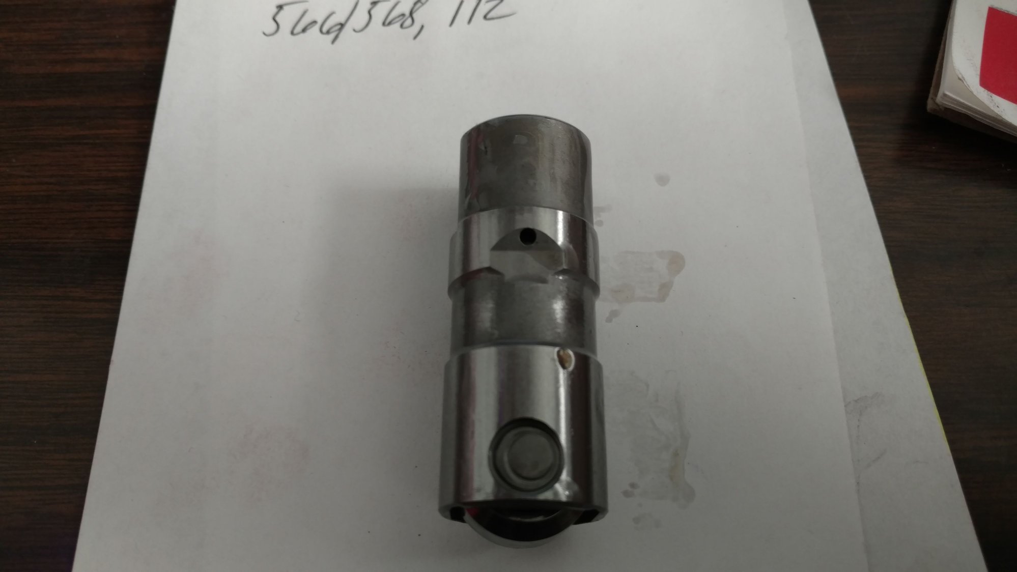

Old Dec 29, 2015 | 10:54 AM
bagged67camaro's Avatar
Joined: May 2010
Posts: 92
Old Dec 29, 2015 | 10:57 AM
Joined: May 2010
Posts: 92
You can tell the difference in length just by the pictures.
Old Dec 29, 2015 | 11:55 AM
Havoc40's Avatar
Joined: May 2011
Posts: 157
That's crazy. It's a Delphi lifter...just shorter. I'll have to dig through some prints and try to figure out what that's for. Could possibly be for one of the V6 engines, I know they had a few lifter revisions throughout the years.
