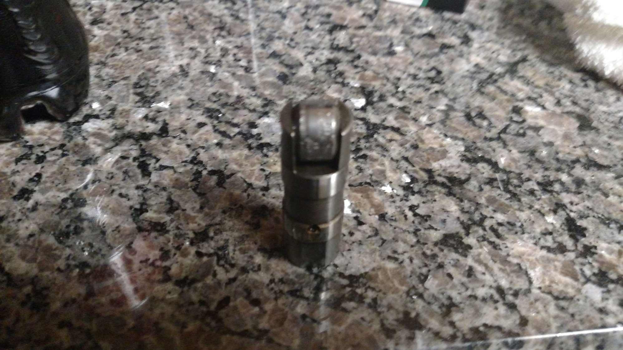

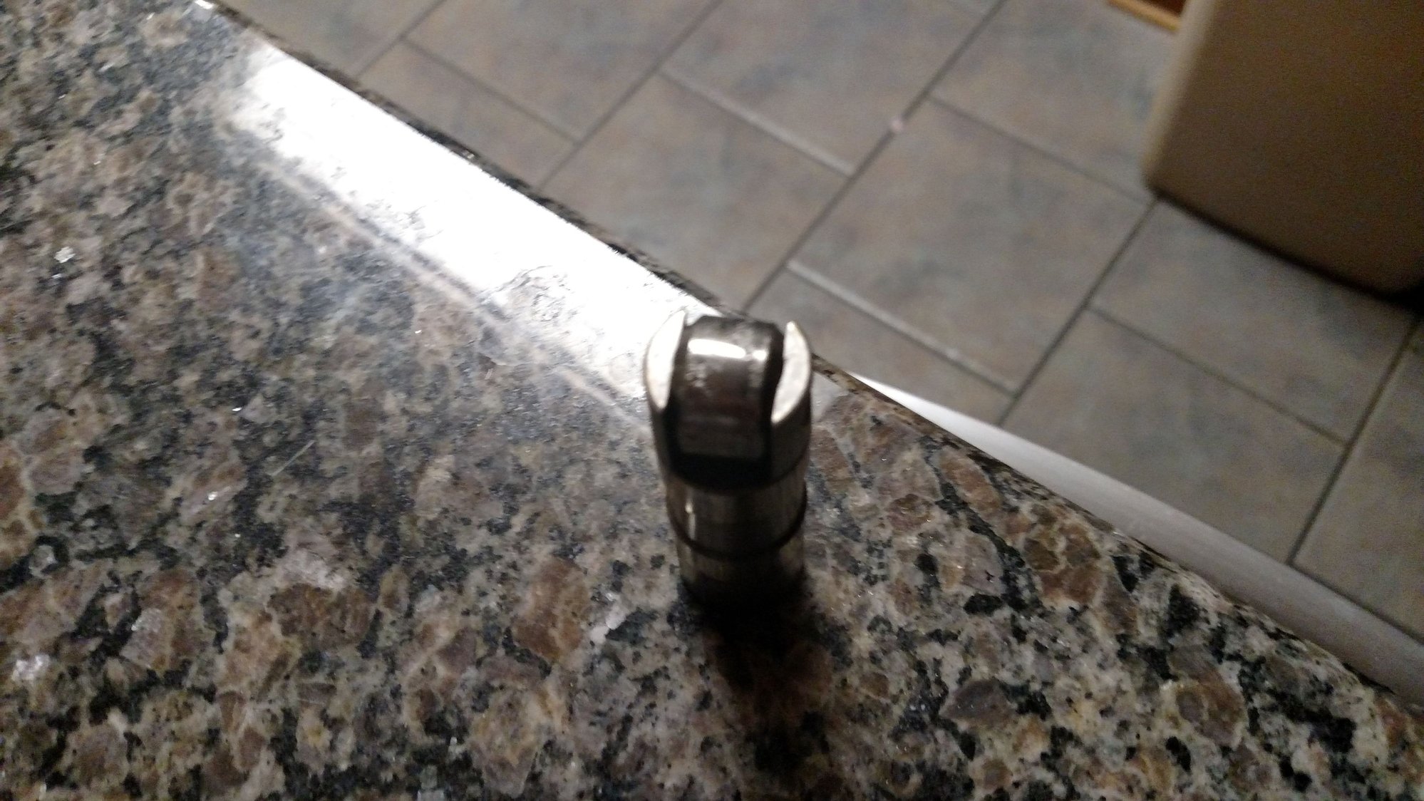

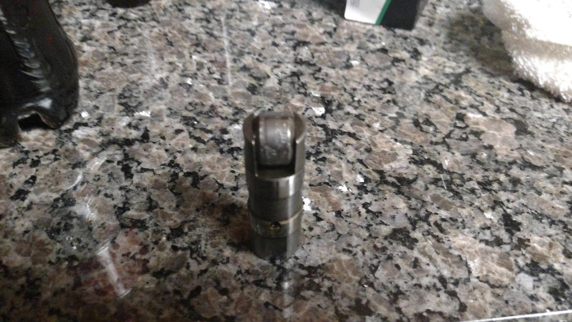

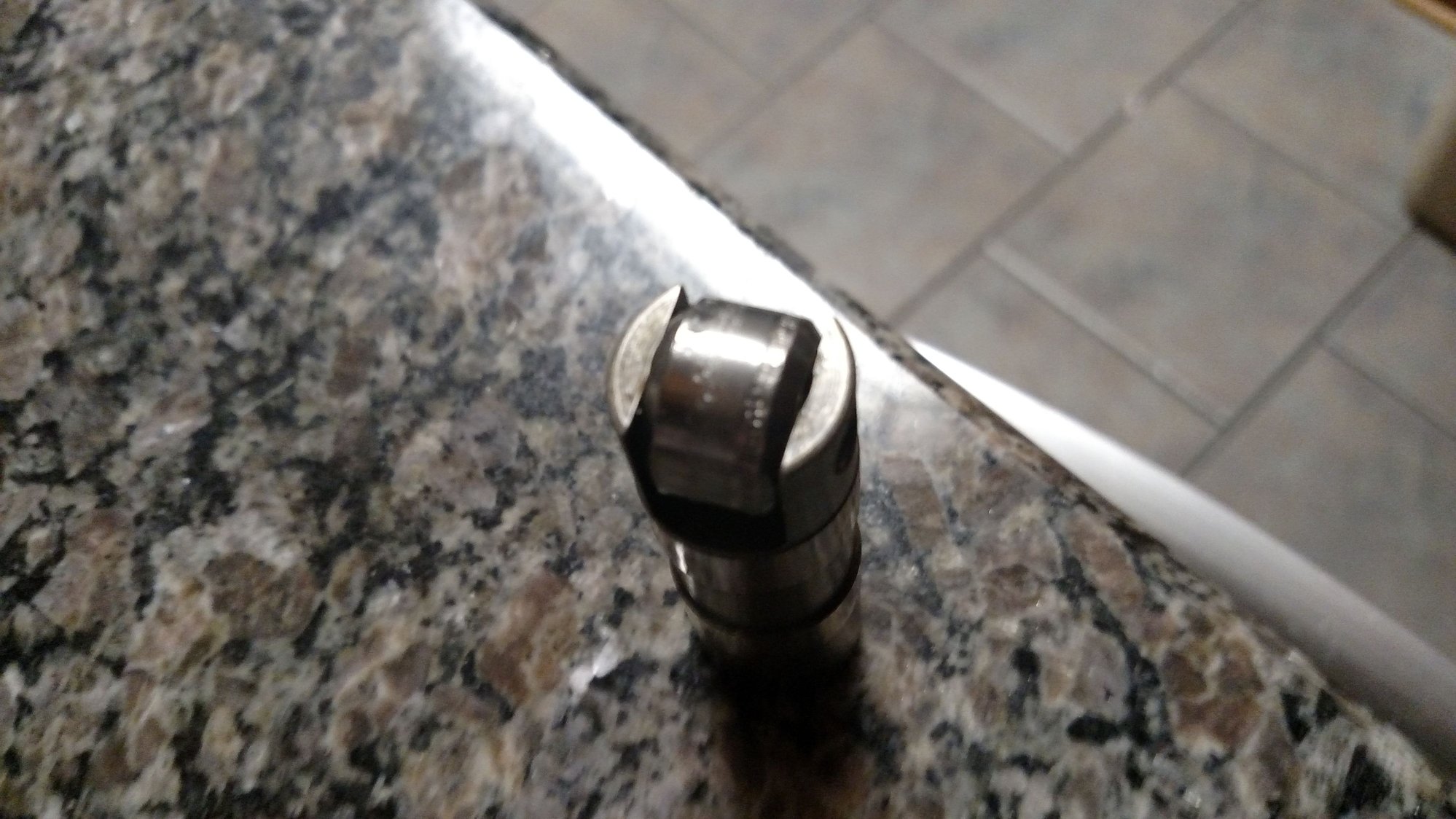

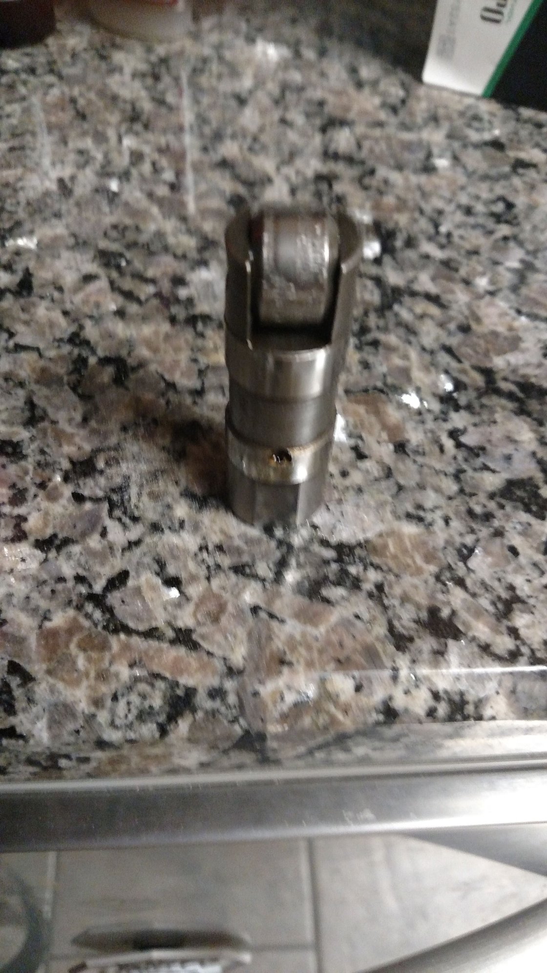

Ok so I didn't get much done today I have been very busy doing other things.
But what I did find was pretty much confirmation of the problem.
Here is a picture of the intake lifter for the #6 cylinder.
The roller has been eat up.
Old Jan 4, 2016 | 07:02 PM
2001 Z06's Avatar
Joined: Jan 2016
Posts: 52
Sorry for the crappy cell phone pictures.
Well I was thinking just leave the bottom end in place and freshen up the heads.
Now I now I will have to tear into the bottom end.
So what would you do?
Would you just pull the cam and replace the cam and freshen up the heads?
or a complete rebuild?
This roller lifter was on the intake side and the divit on the top of the piston was on the exhuast side. ?????? is it possible that divit is old? and the heads are ok?
And all of this is from a bad cam? But that wouldn't really explain the low compression on that cylinder would it?
I don't know if I should scratch my head or beat it on a rock.
Joe

I would totally check to see if the #6 exhaust valve is bent, like Darth_V8er said with a drill, if so then you would know if that divot is old or not and thus low compression, also need to look at that cam lobe too, that could cause low compression on 6 too, if the intake lobe is worn down, it doesn't look as if it is too much by how the lifter looks, it has no flat spots, but im sure it is all dinged and maybe pitted, but no telling for sure tell you get it out and have a look at it...
And as for the rod and mains those bearings should be looked at.. it was hard to turn over for a reason, whether it be seized bearings or simply bad battery, can't tell now with a new battery since its apart, so the bearings surely need to be looked at, if what the PO meant by it lost power and then couldn't start it, as in it wouldn't turn over then it very well could be bearings
I mean you could wait or even just throw the or a lifter back in slap the head back on with old bolts just for testing (make sure to put the head gasket back on too) and use new or known good battery, turn it over and if spins normally, then prob the bearings are ok..

Replied in your other thread. My guess is its part of a batch of bad cams that had a bad heat treatment on it. Others have seen similar issues. You can search for posts by Damian who runs Spartan Performance. Fix the bent valve, freshen up the motor with new rings and bearings go with a 224/228 112 cam and call it a day. If you want to get crazy have the stock heads CNC'd or leave them like they are and you should still be in the 450 RWHP with stock heads. If the car is already tuned, then you may want to see what cam was already in it otherwise you may have to have the car re-tuned.
