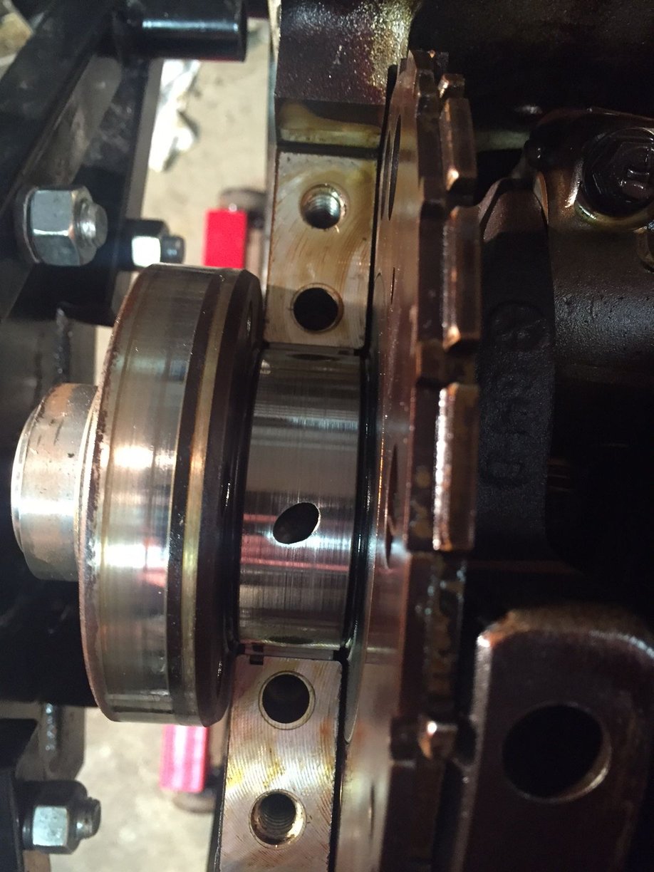

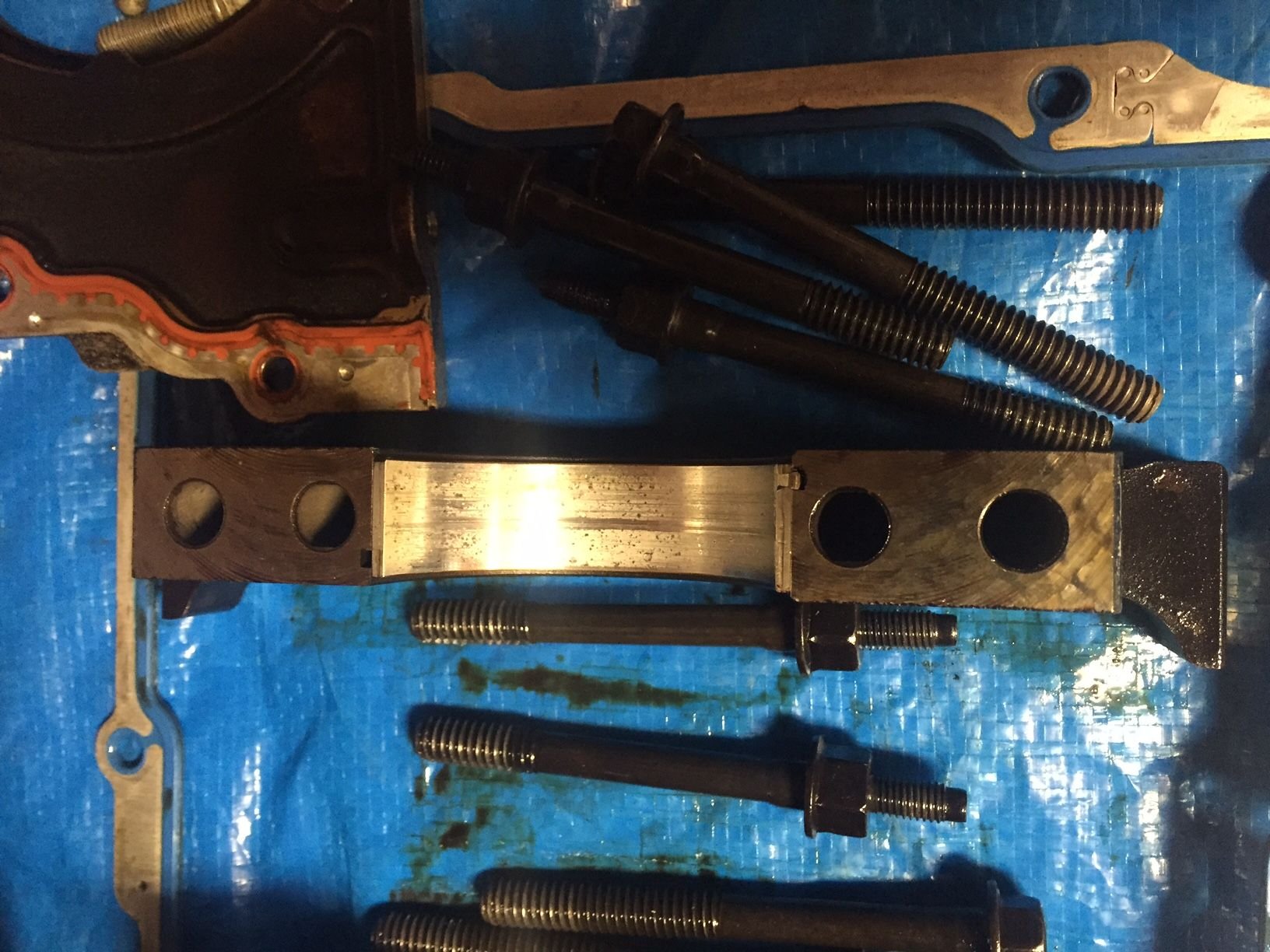

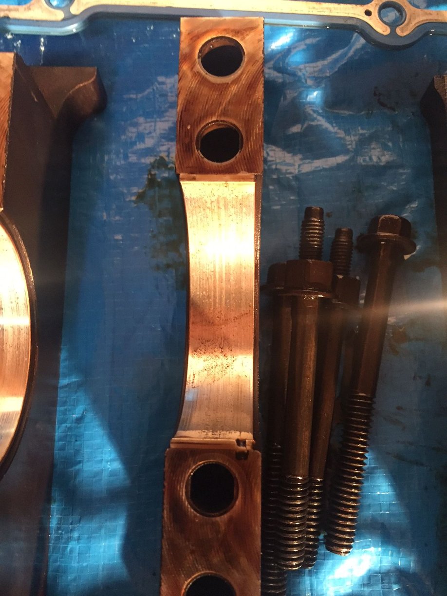

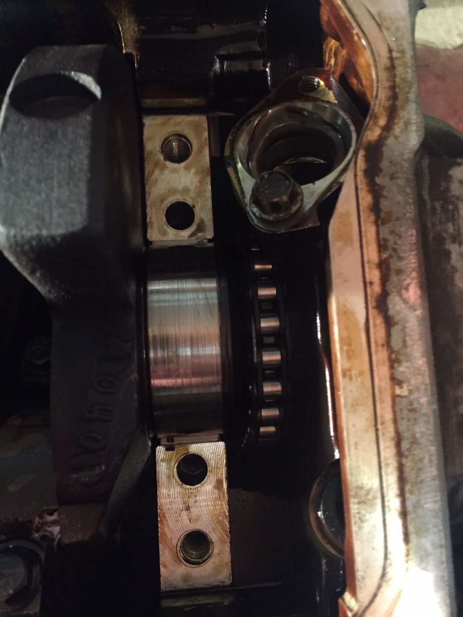

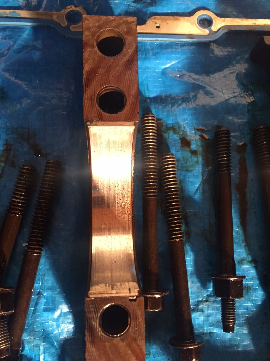

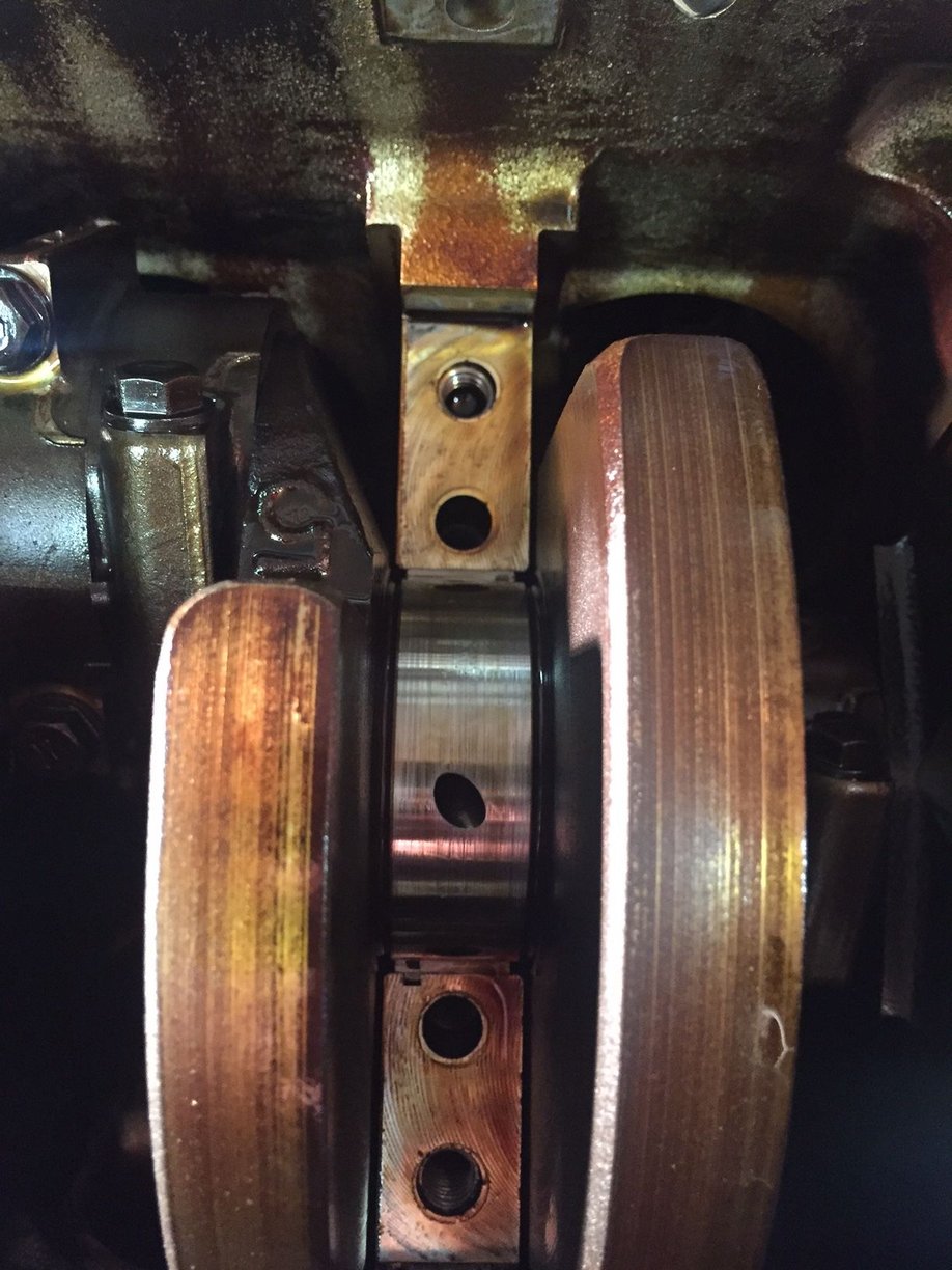

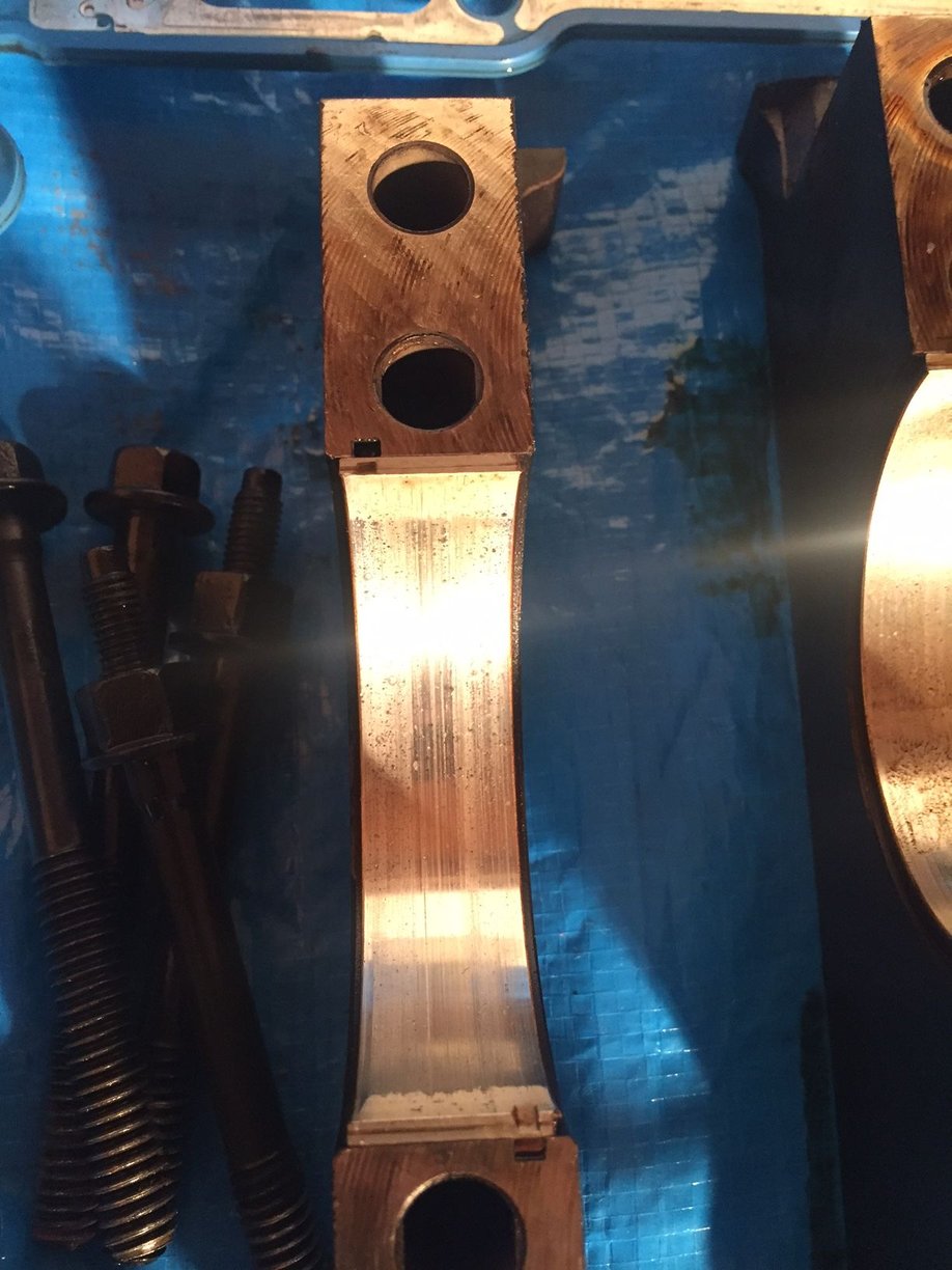

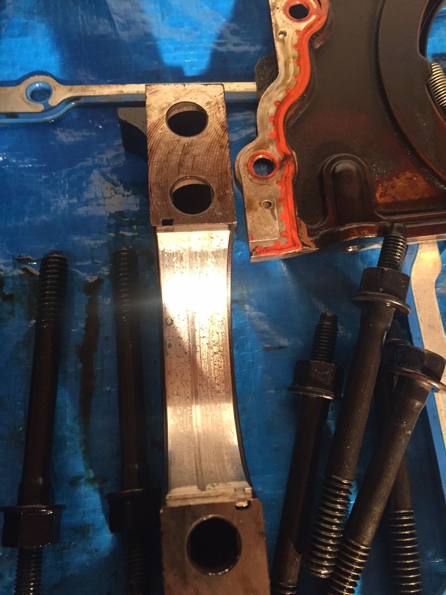

So I've been a long time LS fan owning a several LS6 cars and now this LS1 swap 944 for the track. I've built it from the ground up and got it on the track for the first time this last Oct. Over the winter I've been making upgrades/sorting out little things. Upon removing my LS to do a clutch swap I found some unsettling indications of what I think is bearing wear. My plan is to replace the bearings and do some refresh upgrades including oil pump, front and rear cover gaskets, rear main seal, new main bearings, polish the crank and maybe rod bearings. Wasn't planning on touching the cam, cam bearings or rings (had really good compression and oil pressure despite 80k on the engine).
Anyway, two big questions:
1. Based on the photos below, in your experience does this look like I'm onto something?
2. Can I leave the pistons/rods in the engine when I remove the crank, and them have it machines and replace it without pulling the rest of the block apart? I wasn't sure what the consequences/risks of that might be.
I've wrenched a long time, but I'm new to internal engine work. Would love your thoughts and sorry if I'm actin' a noob right now. Thanks!

Looks like you had some debris in the engine. Lots of trash embedded in the bearing. I would take the engine completely apart and clean everything really well. If you just replace the bearings and slap it all back together, you're probably going to have the same problem again.

Probably from lifter wear, what does the cam and lifter rollers look like?

I'm the type of person that if I'm going to do it, I'm going to do it once and do it right the first time around.. just take everything apart and get that block cleaned up well. never know what lurks in the dark.. time is valuable and don't spend it on doing 1 thing twice
