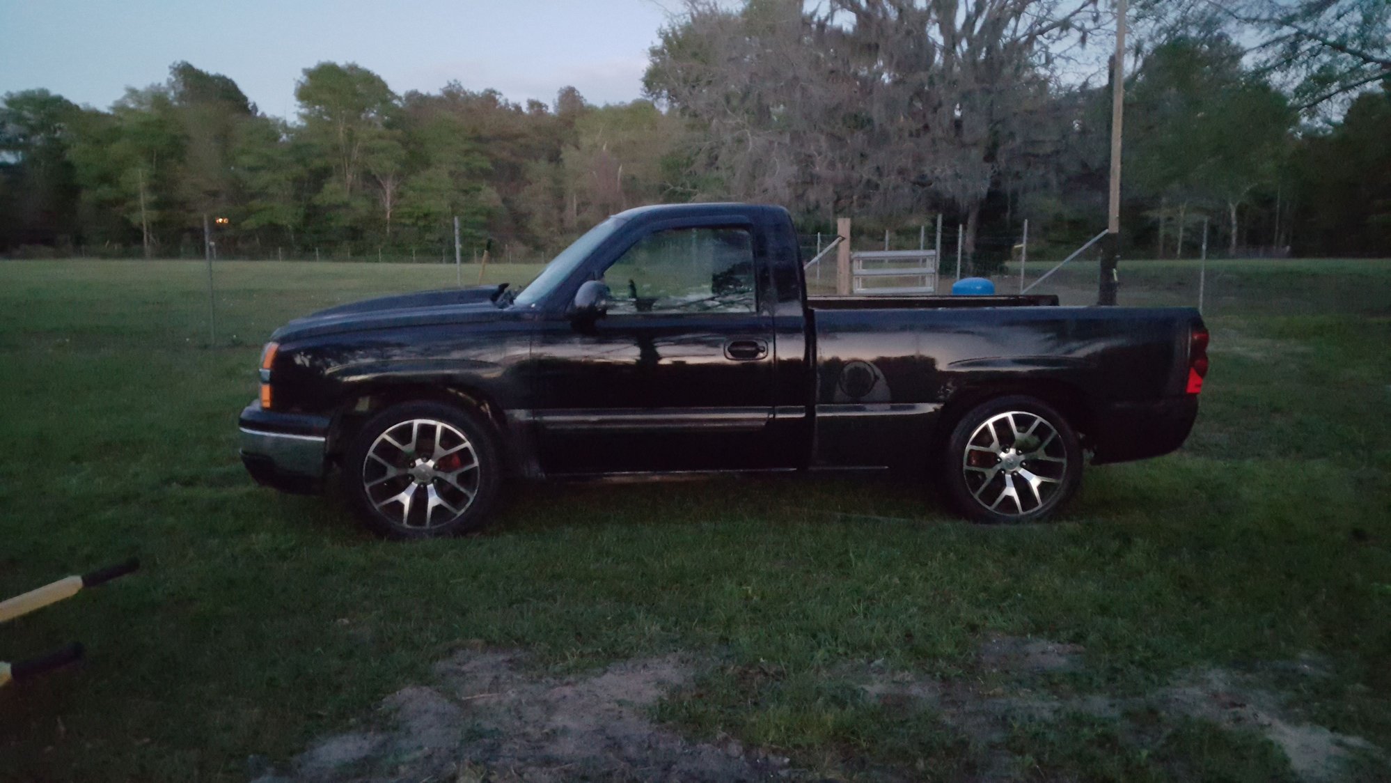

Hi all,
New to the site and a new build. My question is thoughts on a cam for stage 1 of my rcsb sssilverado clone.
Stage 1:
Z71 with autotrac 2 speed transfer + all wheel drive capability lowered 4/5
2014 option rims - 20x9 295 50 20
Stock lq9 with tri y long tubes, cai, and cam,
Spring, rocker trunion upgrade.
4l65e, hydro boost with twin piston calipers
Big radiator from escalade and twin e fans wired with two relays.
My thoughts on cam are between theese three:
1) 216/224 551/551 lsa 115 5a
2) 218/224 553/553 lsa 113+3
3) 224/230 553/547 lsa 111+2
This is my daily driver, I really dont want to lose alot of torque down low yet would like to wake things up a bit. Will I have any ptv issues with the flat tops and opinions on 1.8 non adjustable yella terrors to go with upgrade
I have hp tuners and will be tuning myself.
A question there also. The lq9 is in a 02 escalade I just aquired, my truck is 04. Will I be better to keep 04 pcm and load lq9 tune or keep lq9 02 pcm and repin for my truck.
Any advise or opinions would be appreciated, just remember this is a heavy truck and drivin in town and long highway miles daily - 1.5 hr commute one way and
Redlight driving during the day. Whereas gas milage is not major concern, I would like to keep at least 14/15ish combo for now.
Thanks in advance for any comments.
