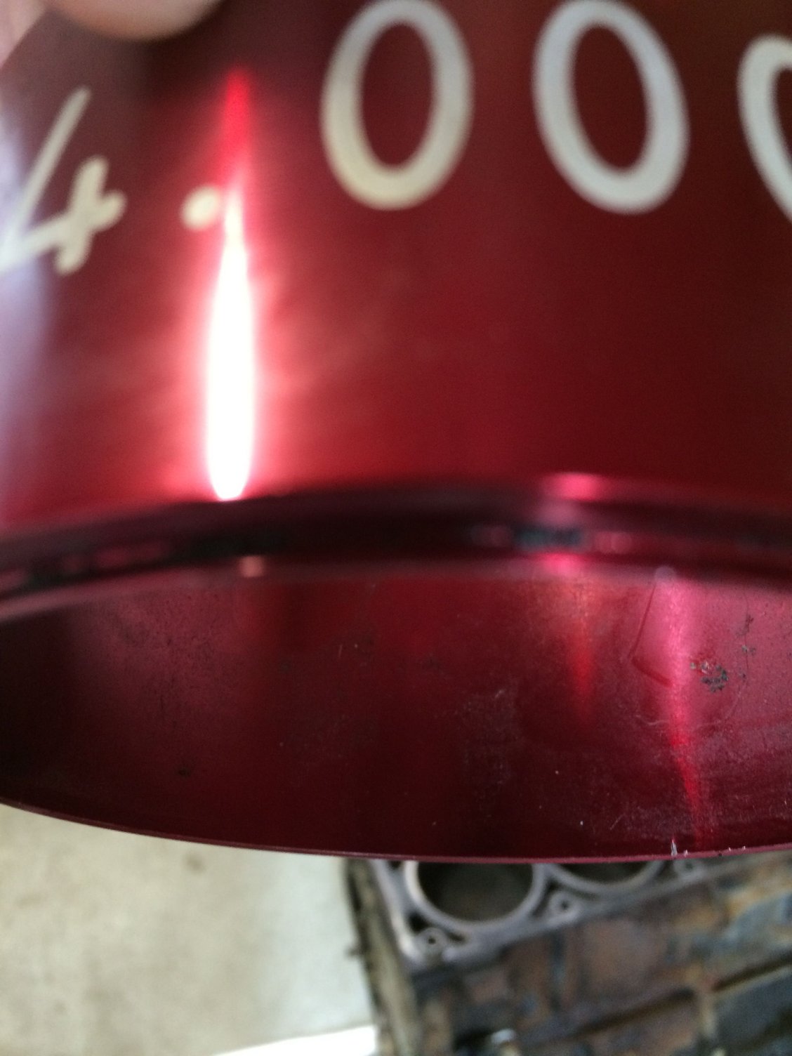

First problem is you are using a micrometer which won't give you the most accurate reading. It will come very close IF you have it perfectly strait and center in the bore.
Secondly, are you sure you have used that 4" ring compressor before because I am willing to bet money on it that if you flip it over 180 degrees, it will fit perfectly! Those compressors are designed with a tapered inside diameter so one side is larger than 4".

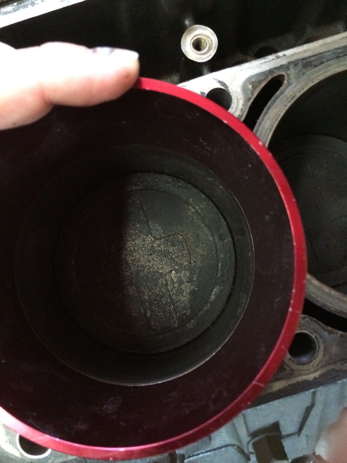

First three bank Matco
Second three bank Matco and these are just at home not at the shop
Ring compressor lip that goes in the cylinder to along the piston and rod assembly!
Lip clearly doesn't fit the damn bore!

Did you try measuring 90 degrees apart?

Yes sir its just a small bore .018 below 4.00 is what i come up with and i measured three different bores the largest was still .012 shy of the 4.00 mark.

Within factory specs, nothing to see here.
3.98 is the listed factory bore on the LQ4/9.

Gm service manual i have seen say 4.0007-4.0017 I know at one time the early LQ engines were shown to have a 3.98 bore however everybody who tore one down measured it to a 4.00 I am guessing I just have one of the actual 3.98 bores.

3.98 is the rough bore, which is honed/finished to spec from there. If it's straight, there wouldnt be a need to finish it out to 4.
It's also possible it wasnt a production engine and someone built it from a gmpp block as-is without doing a finish hone

I wouldn't be too surprised as the later LS2 block used in the L76 is said to have a 3.988 bore. same casting as the regular LS2 but the finished bore wasn't brought out to a true 4" I guess that means you have more room to clean up any cylinders
