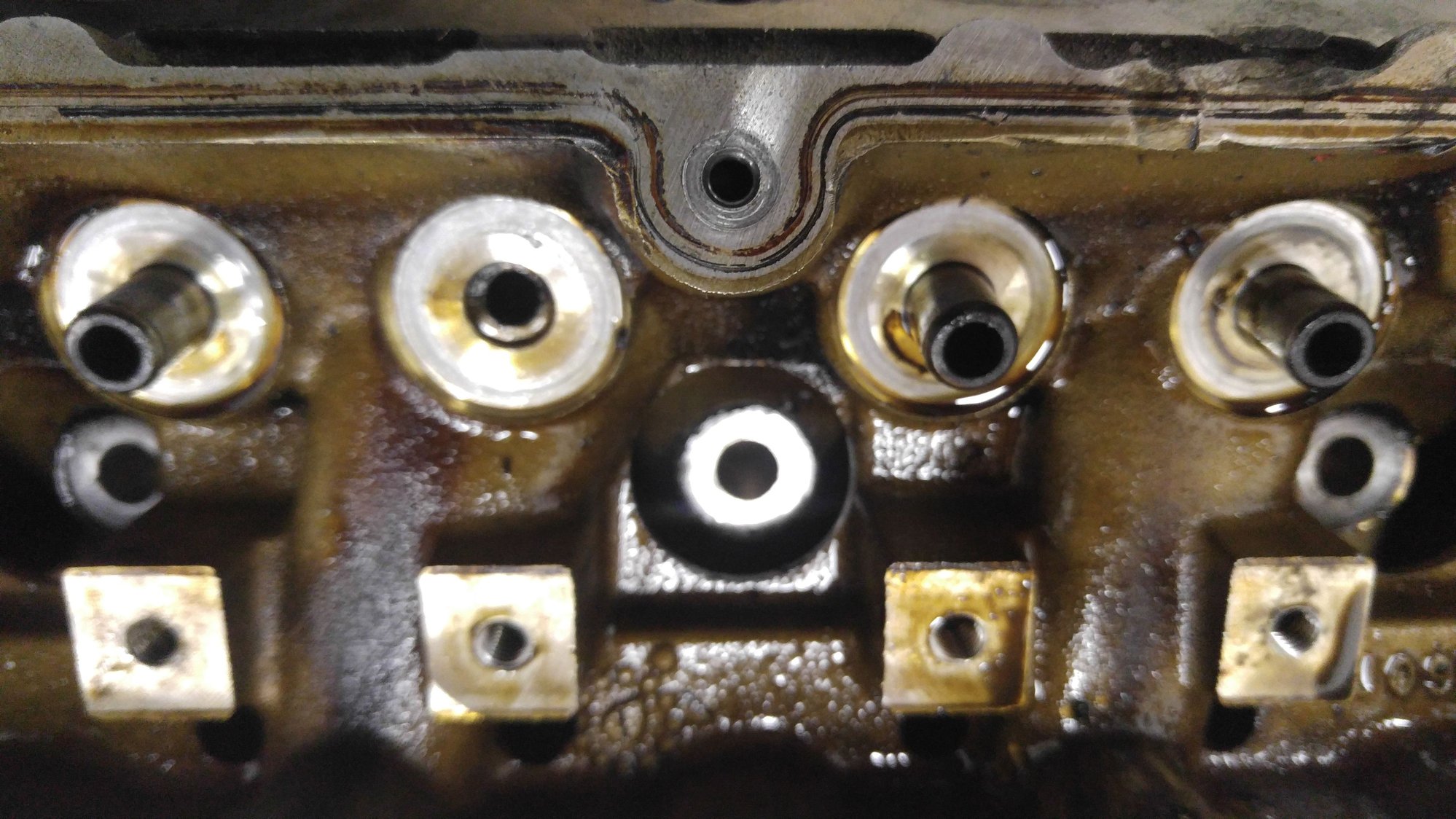

Default Broken Valve Guide
Never smoked on startup. Could smell a trace of burnt oil after moderate pulls, but also had tiny oil leak around bypass seal. The truck has been sitting for 2 years at my dads, only started once a week, drove once a month. Found by dumb luck.

baronsmith98's Avatar
Joined: Feb 2013
Posts: 831
From: Brunswick, GA
Damn that's crazy. I pulled a valve cover yesterday and couldnt really see anything out the ordinary. Prolly just gonna go ahead and put some new seals on. They're pretty cheap just time consuming.
