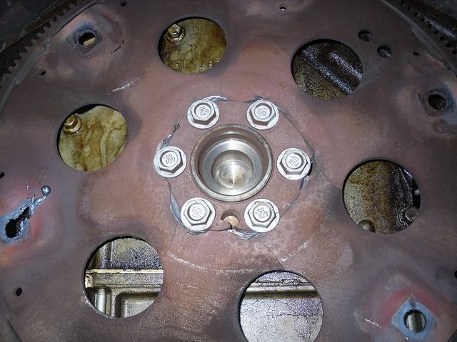

*update* I do believe that the sound is coming from the flywheel. I looked at it and couldn't see any cracks. I did notice a slight wobble.
Old May 12, 2016 | 08:46 PM
slogo's Avatar
Joined: Apr 2014
Posts: 985
Likes: 12
Seems like I read if you squirt some wd40 close to the crank and the noise goes away
its cracked. close to where flywheel bolts on crankshaft.

Originally Posted by 1970camaroRS
110% promise you it's the flexplate bolts.
I'm not quite that % sure...but I have bought a couple LS LQ4's that had "rod knock" for pennies, and found this...
Sounds TERRIBLE...but the engines were fine...
