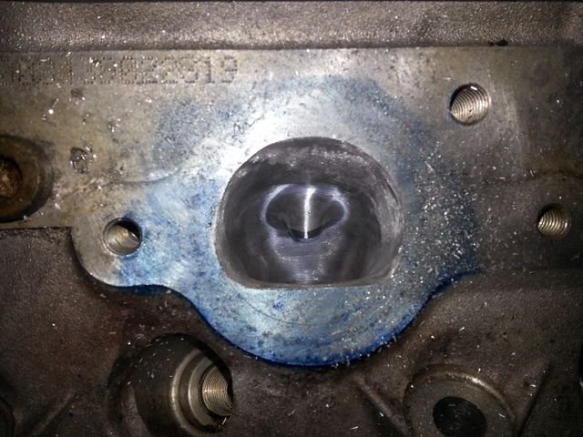

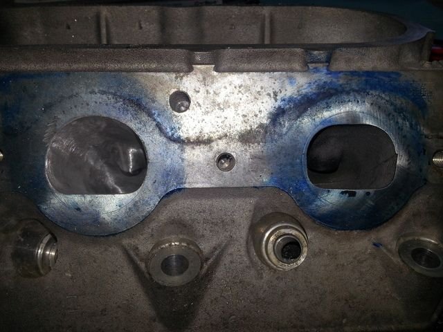

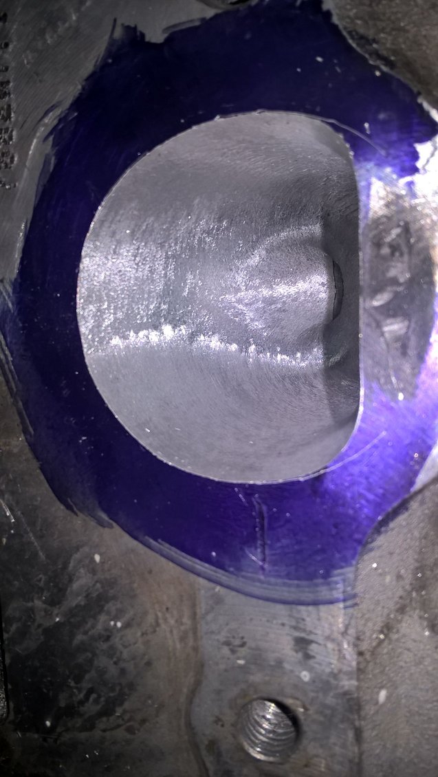

Originally Posted by DietCoke
All you'd be doing at that point is killing exhaust velocity where it matters.
Sure about that?
Exhaust gets a little help from the piston.
1st picture is a GMPP CNC 243
2nd is a Livernois 766
3rd is a Livernois LSA
Attached Thumbnails Super duper head porters and flow bench operators come in!-243ex.jpg   Super duper head porters and flow bench operators come in!-799-ex.jpg   Super duper head porters and flow bench operators come in!-lsa-ex.jpg

Originally Posted by axe murderer
Sure about that?
Congrats! You are the only person who has ever particularly agreed with me. Lol
Sure about that?
I'm sure application has a lot to do with it. A blown LSA would probably really like the larger exhaust versus a more mild NA application that a 243 head would usually go on.
Whatever you do, do not "gasket match". The gasket makers really don't know what size ports are right for your combo, so they usually make them with very large openings. Matching the ports/runners to the gaskets usually ends up in a bad mismatch or bulge at the flange and often hurts more than it helps.
