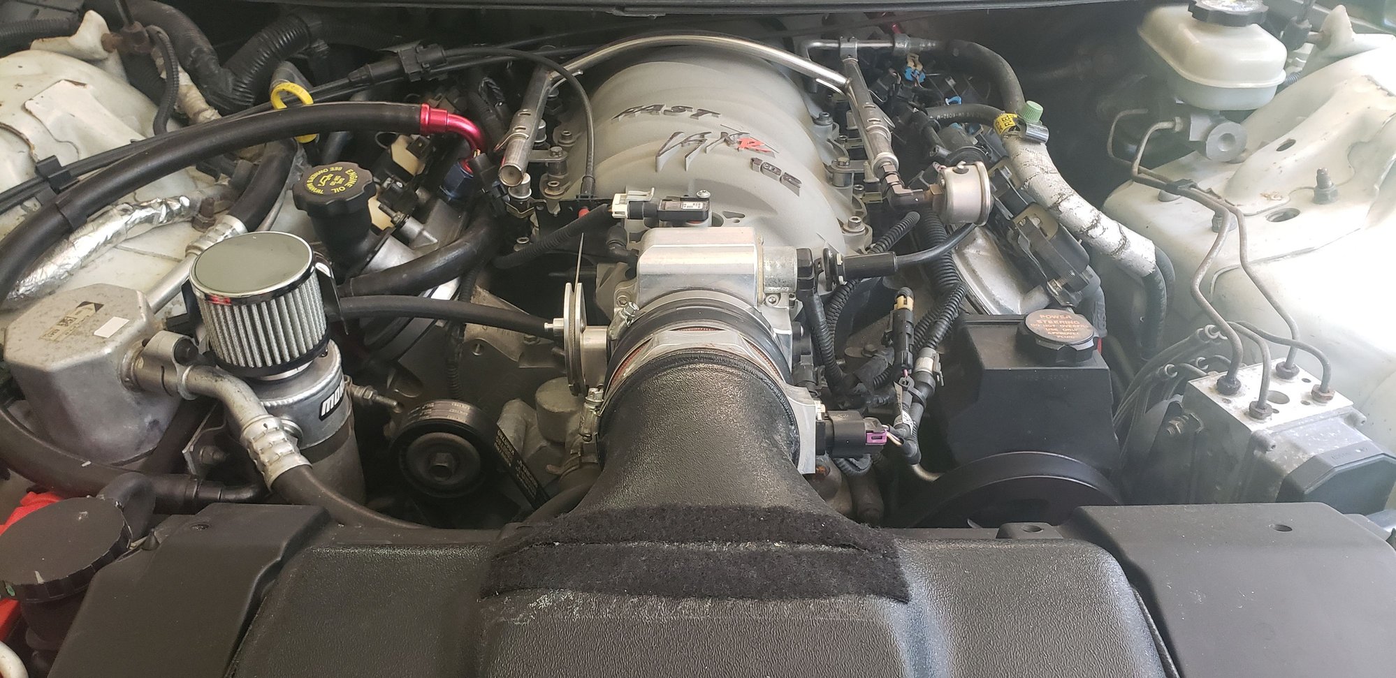

On the Gen III LS1 valve covers the passenger side has two ports and the driver side had one.
The driver side also connected to the rear port of the passenger valve cover and then from there it went up to the intake manifold port with an inline PCV valve in the line just before connecting to the port on the intake manifold. The other port on the passenger VC went to the port on the throttle body. Since your TB does not have a port the best place to install one would be in the air intake tube. Dosen't matter if it's before or after the MAF but I would prefer to install it in between the MAF and the TB as to not have the contents of what's coming through that line gumming up the MAF sensor.
Doug is venting to atmosphere hence not using his intake manifold to pull a vacuum on the crankcase and suck that crap back into his engine and like Doug I too am venting to atmosphere. I have a 427 which has 10 AN lines coming off each valve cover to a breather can.

Pretty simple setup. Just cap off the TB and intake manifold and run large enough lines in order to relieve the crankcase pressure.
Pretty simple setup. Just cap off the TB and intake manifold and run large enough lines in order to relieve the crankcase pressure. These kinds of setups allows fresh air and only fresh air to enter the intake manifold!

Wrong, I have a MAF on my car and I'm venting to atmosphere..So with that being said I'll just say that any air coming through my MAF sensor has been accounted for in the tune.
On a stock system where you're using the intake manifold to pull air through the crankcase. That air that's being pulled through the lines of the valve covers from the intake port and throttle body is already metered air. A MAF or even an SD tuned engine that uses the intake manifold to pull a vacuum on the crankcase has that air already accounted for. SO IT DOES NOT MATTER if you elect to run the line off the valve cover to the the throttle body, air induction tube or the air box. Now if you were to put a breather on a valve cover and you're still using the intake manifold to pull air through the crankcase then you're now introducing unmetered air into the system. Another issue I have about this whole fresh air feed BS is flawed to me because the line that goes from the valve cover to the throttle body or air induction tube has the same blowby gases as the line from the other valve cover or valley cover that's connected to the intake manifold. Same oil/gases/condensation coming from both lines and I can only assume that it's done this way to help circulate the air better.
Like I said "The only air that's going into my engine is the air that's entering the intake manifold by way of the throttle body which is being drawn through an air filter in the air box" If you look carefully you'll notice that the TB and intake manifold are capped off. There is a 3/8" line coming off the valley cover to a small breather that's close to the battery next to the passenger fender.

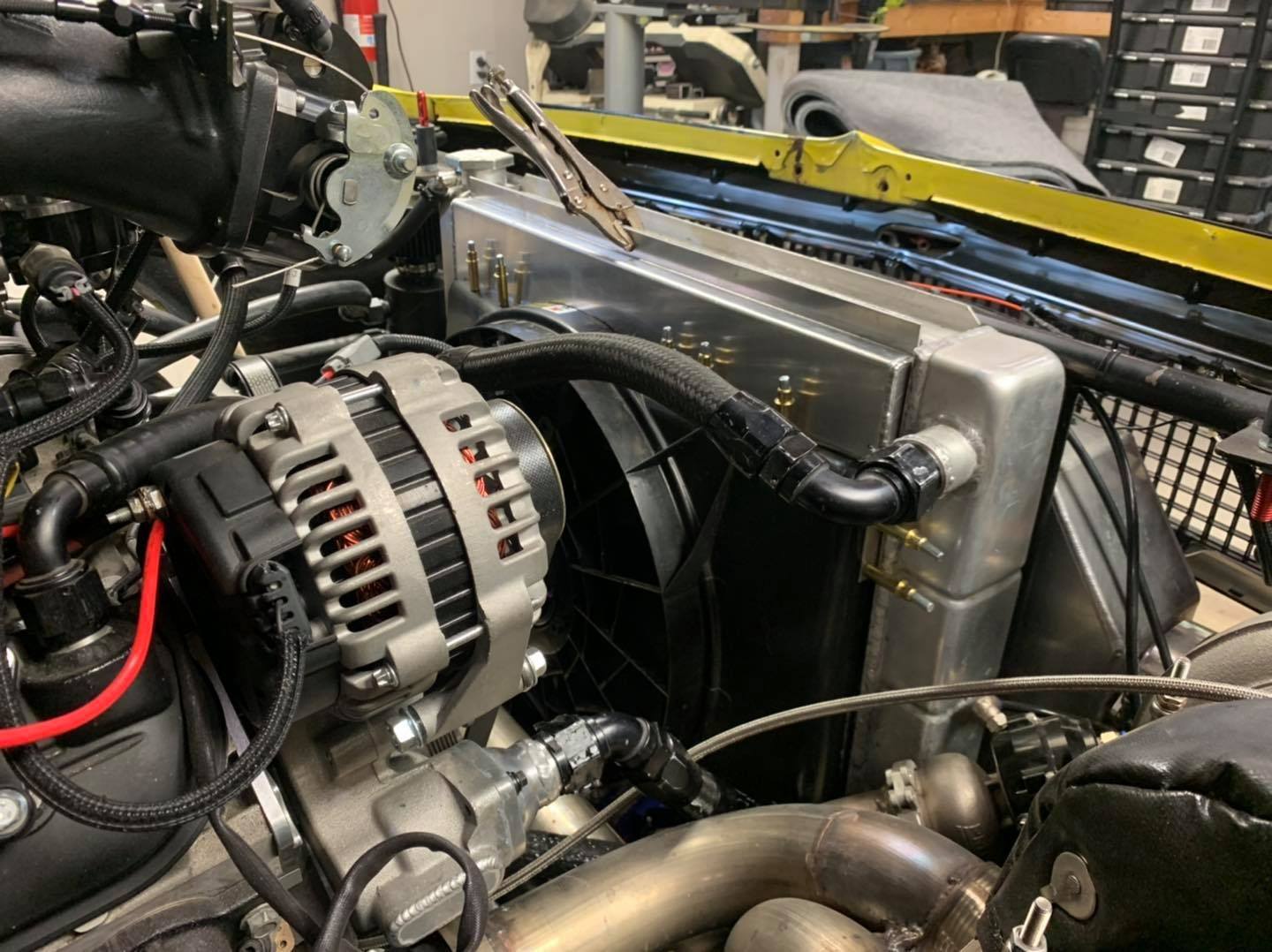

I'm turbo, so I need the can to vent, I'm needing to bleed off crankcase pressure.
You'll find that people like to move the valve cover outlet to the middle or front of the valve cover, when you accelerate where does the oil want to go... to the back of the valve cover.
I'm running flipped stock valve covers with -10 AN fittings added.
