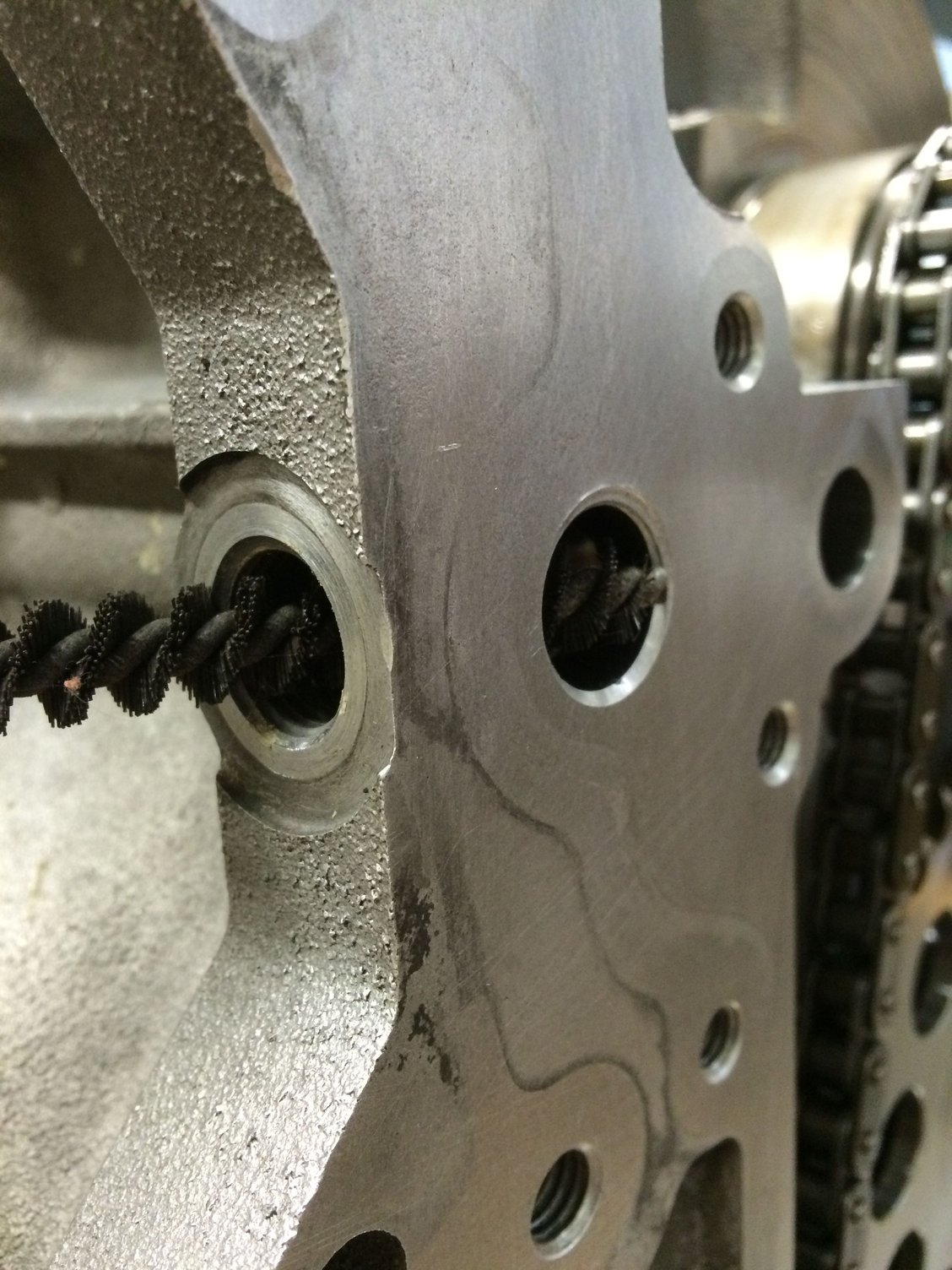

I think I forgot to install the internal front oil press in plug on my ls1 . If I remove the external threaded plug on the side of the block could I maybe see if the internal plug is installed ? I have already installed the engine and I have no oil psi .

I would say you could.

Great picture thanks !! Will post what I find

Bad news. I forgot to install the barbell restricor . Engine coming back out ����

Why do you have to pull the motor out? I made the same ooopsie. Just pull the pulley, remove the cover and waterpump, pound in the appropriate plug and put it all back together. I did this all in the car, no problem.

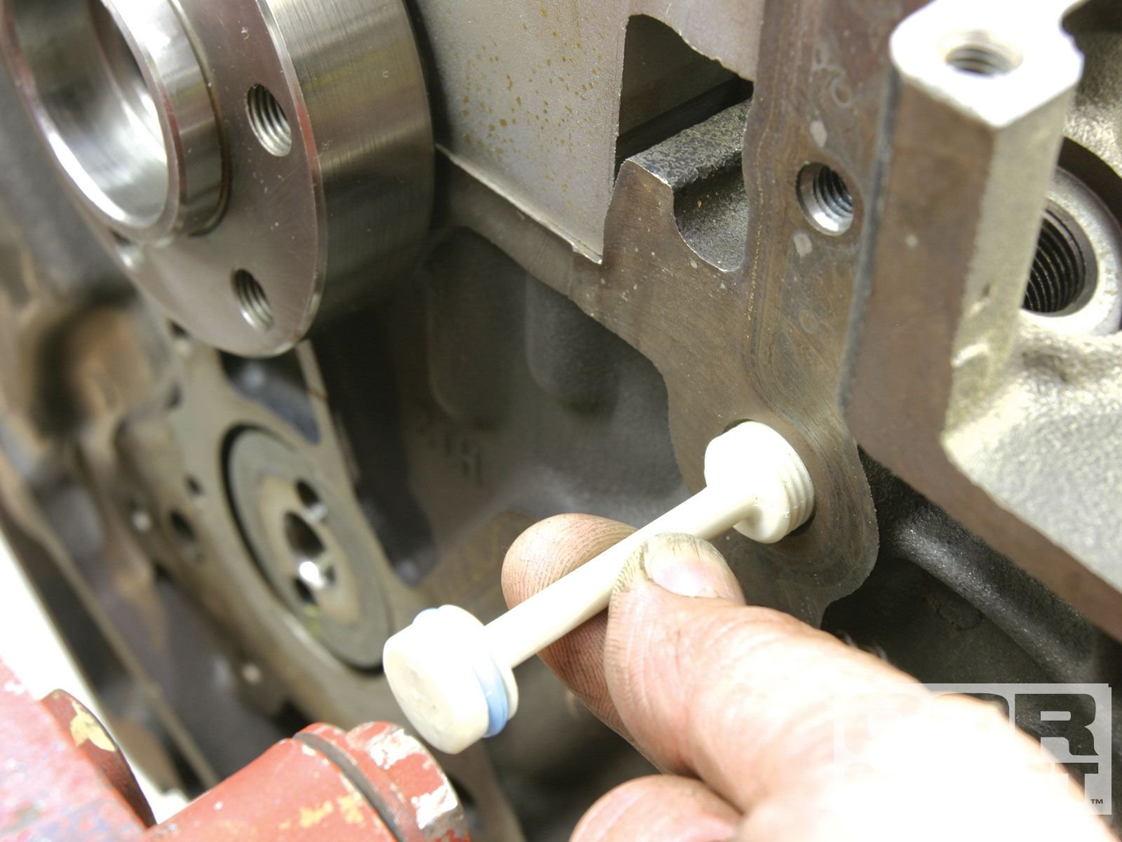

BARBELL, it's behind the rear block cover under the flywheel/flexplate.
No, he's talking about the front press in one that's behind the timing cover, next to the driver's side of the oil pump as seen in the picture that has a timing chain in it.

He said he forgot the barbell. I think he already checked the front.
This isn't rocket science, the barbell goes in the rear of the block:

The front cover plug was installed. It was the barbell I left out �� engine is back in and with 60 psi at idle. Thank you all for the help. . And yes this will never happen to me again. Lol

Good to hear mate, when I rebuilt my LS the very first thing I did when I got my block back from the machinist and bolted to the engine stand was install the barbell, I'd read too many horror stories and wasn't taking any chances on remembering to do it later on.
