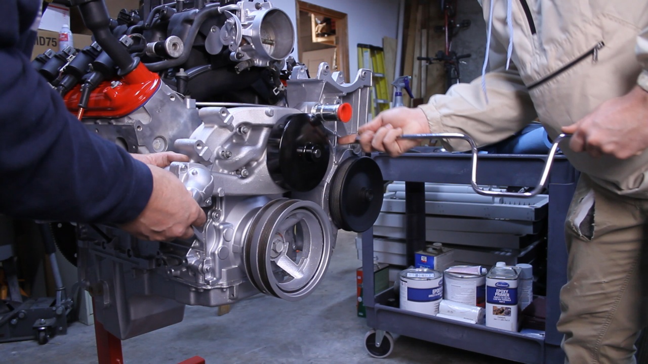

When mocking up the Water Pump, we did not install the gaskets. We removed and then re-install the Water Pump with gaskets as it's final assembly.

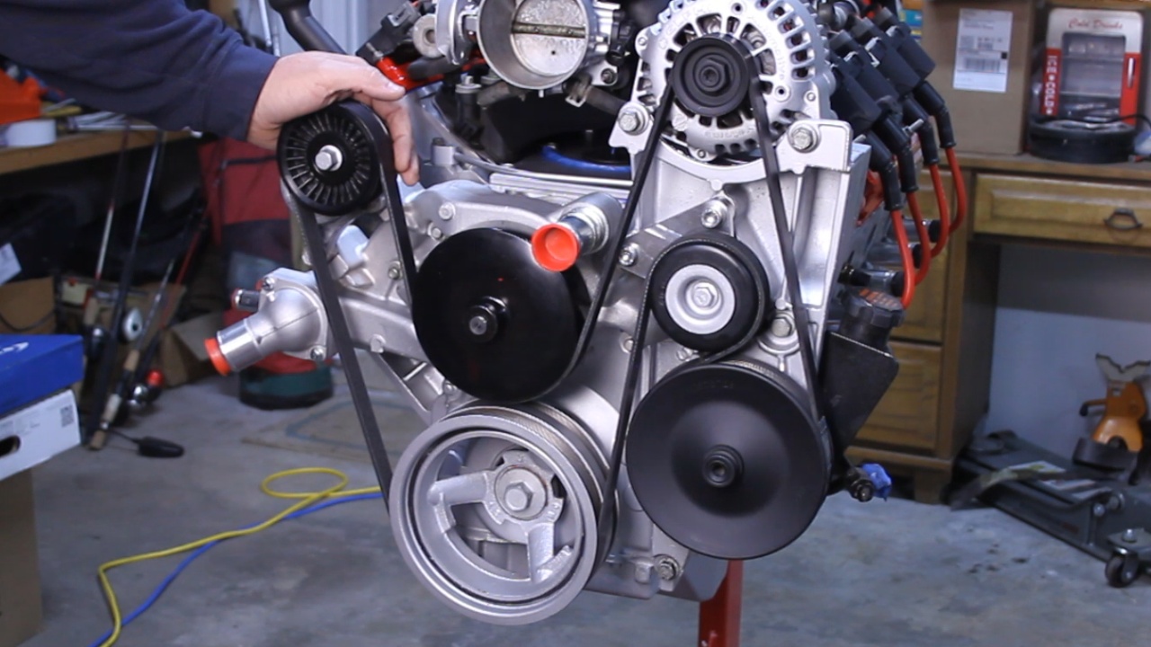

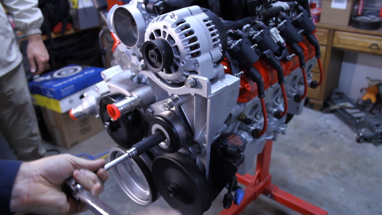

We installed the original Alternator and the new Idler Relocation Bracket from Dirty Dingo Motorsports. This type of work is very quick as all the pieces just come together nicely.

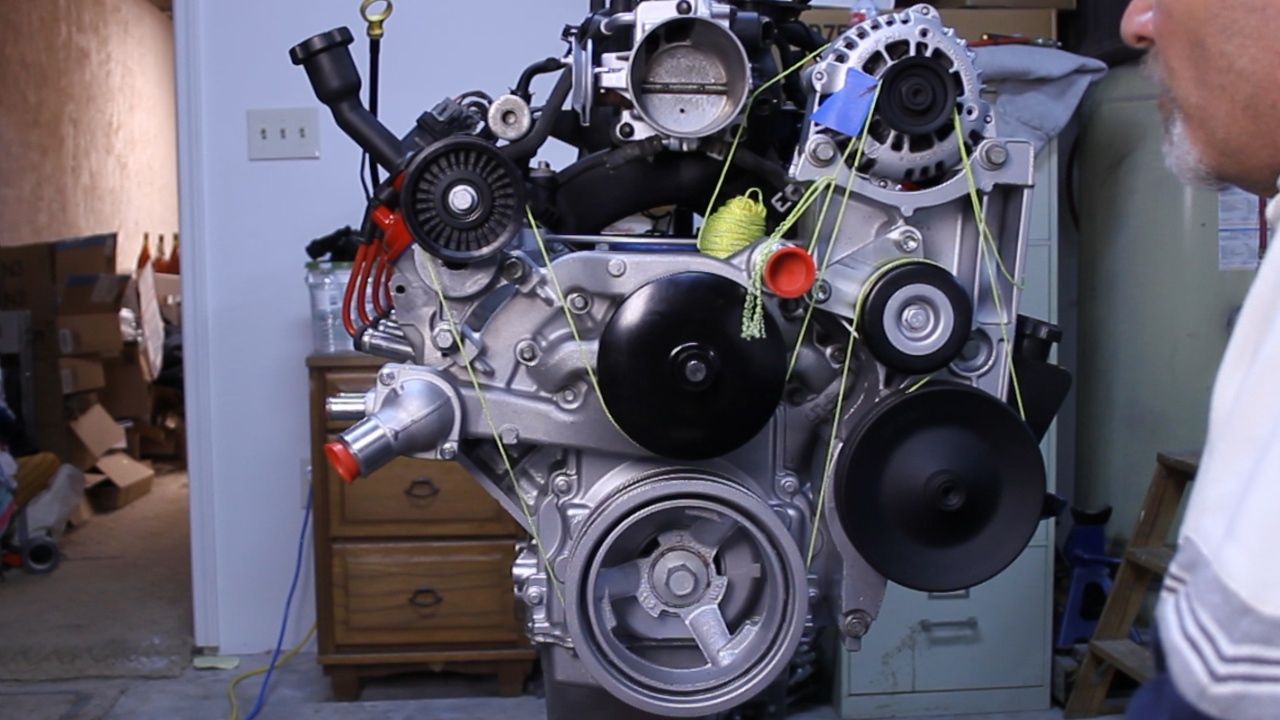

After installing the New LS3 style Tensioner Pulley, I was having a little issue with the length of the suggested Belt. Here I used a String to measure both the longest possible length and then we rotated the tensioner to determine the shortest possible length. Because the string would ride deep in the groove, our estimate of the belt length was off (several times, several trips to the Auto Parts store). We finally were satisfied with a 101-5/8" long belt.
