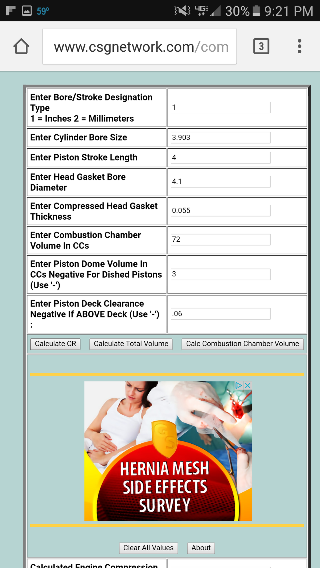

Not sure if the pistons deck clearance is right. BUT at .06 it's 9.4:1 compression. With .016 clearance it's around 10.4:1

You have to use negative if it's a 3cc valve relief and -.006 out of the hole... but I think Wisecos typically come out around .010" out of the hole (at least Diamonds do).
On E85 you can run 12.1:1 and like 20lbs with 25 degrees of timing. It's insane.

okay Jake with that of .010 it's right at 9.9:1 . So that's a good deal right around where I'd like to be.
so I still should be able to reuse my valvetrain set from my 243s so this should work out good. Thanks again
