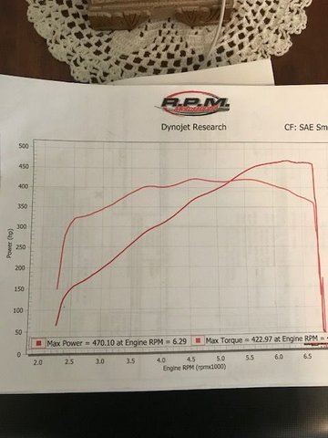

Thanks for the replies! Sorry for the delayed response. I ended up scrapping the striker idea and just did the heads, btr stage 3 cam, 102 intake, headers and underpulley kit. Had it dynoed at rpm and made 470rwhp/423rwtq. I was kind of disappointed with the rwtq.
So you made 470 with a atock cube LS1 with ported 243's? Am I reading that right?
it made 470 rwhp and 423rwtq. I tried posting my dyno sheet but I think it was to large to upload.
on stock cubes

I'd suggest a mild HC build like AI porting the 243, a decent street cam like the titan 4 or HT street sweeper. That'll get you in 420 territory but still be streetable. Then a 100 shot of nitrous for when you need it. With your budget you're not in 500 hp NA territory at any displacement .
I got real close to 500 hp NA with stock displacement but I did blow my original budget.
