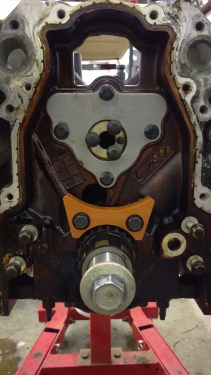

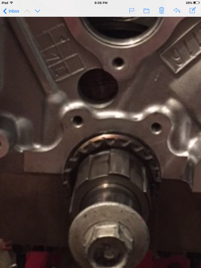

I started reassembling my 1998 LS1 and noticed a hole in the front of the the Block above the timing crank gear. Can someone tell me if I need a plug for this hole? I don't remember it being open. The machine shop may have removed it. If I do need a plug for it does someone have a part number.

Hi, this hole is for block breathing, leave it open.
Please install the Black Cam Chain Dampener and post that picture.

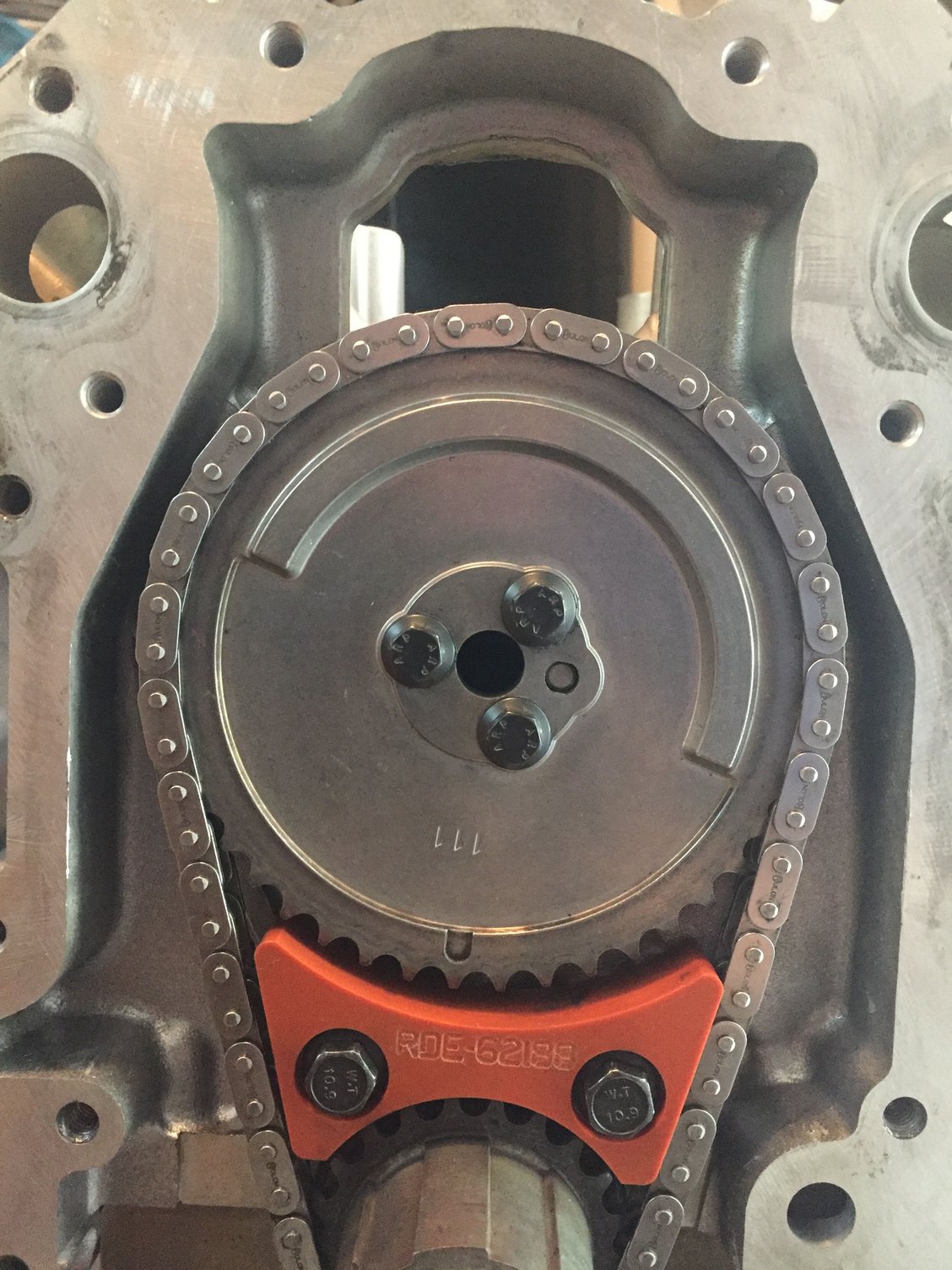

i have a 1998 so the black timing chain dampener doesn't fit without drilling and tapping. I ordered one from BTR that's a direct bolt on. I'll post pics when installed. I'm waiting on some parts now.

Looks like the one I ordered.

Melting chain and sprockets. Arp bolts and RDE timing chain dampener.

Hi Troy, this IS the type of QUALITY "tech" that will put LS-1 Tech at the top.
GOOD WORK !
Now to add, this hole in EARLY AL blocks is a WEAK area allowing cracking.
My guess is that the GM engineering was OK for a 400HP engine NOT GREATER.
The cracks I have seen are between the shown hole AND the Main Saddle.
Lance
