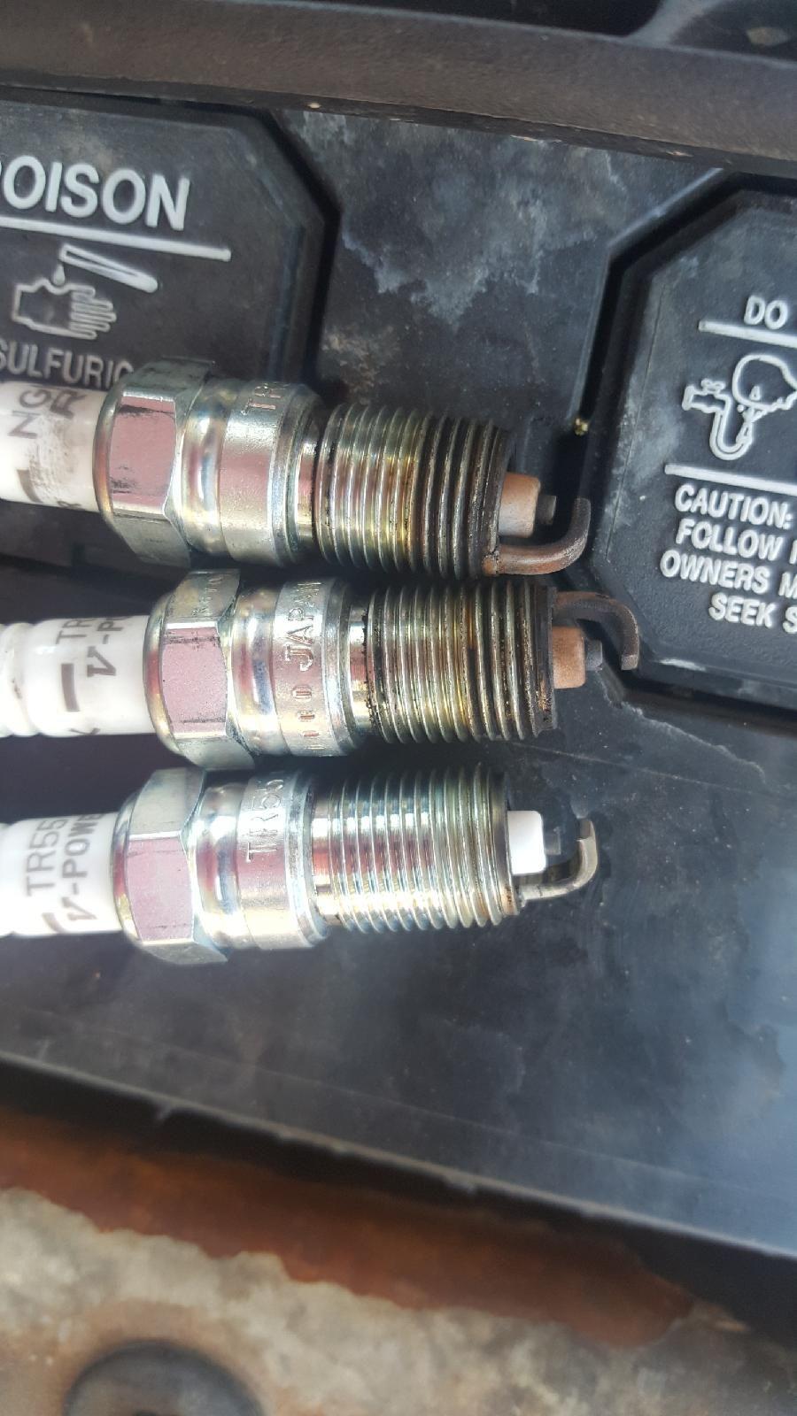

Hey all,
What kind of effect does E85 have on plug temp ranges? Every time I check my plugs (TR55s @.050), they are nearly immaculate and look brand new making it difficult to judge if they are the right temp. I occasionally get knock sensor codes and am trying to rule everything out.

Default E SP Reading
Hi 98ss, YES and I agree with your report, a "hard read".
Send a quality picture, I can read the steel.
Your Knock sensors should be working correctly.
AS for "Old Geezer" tech, LEAN is ABOVE 1.00 Lambda/Rich is BELOW that value.

Originally Posted by Old Geezer
be getting plug coloring w/ E85.
If they are looking "new" and the knok sensors are active, it may well be you are running very lean.What is the AFR?
Commanded AFR is 10.09
Bottom plug has 500 miles, top two are from old build.
Trims are +/- 2%

With todays fuels and oils, it's very difficult to tune an engine by reading the plugs. If you're drag racing, you need to put in new plugs, shut down the engine at the end of the track, and then get towed back to the pits. That's the only way to get a clear reading.
One of the big advantages to alcohol is that it burns very clean. Chambers, valves, etc, all stay very clean. What you're seeing on the plugs is very normal for alcohol. You need a data logger to make sure your tune is correct.
