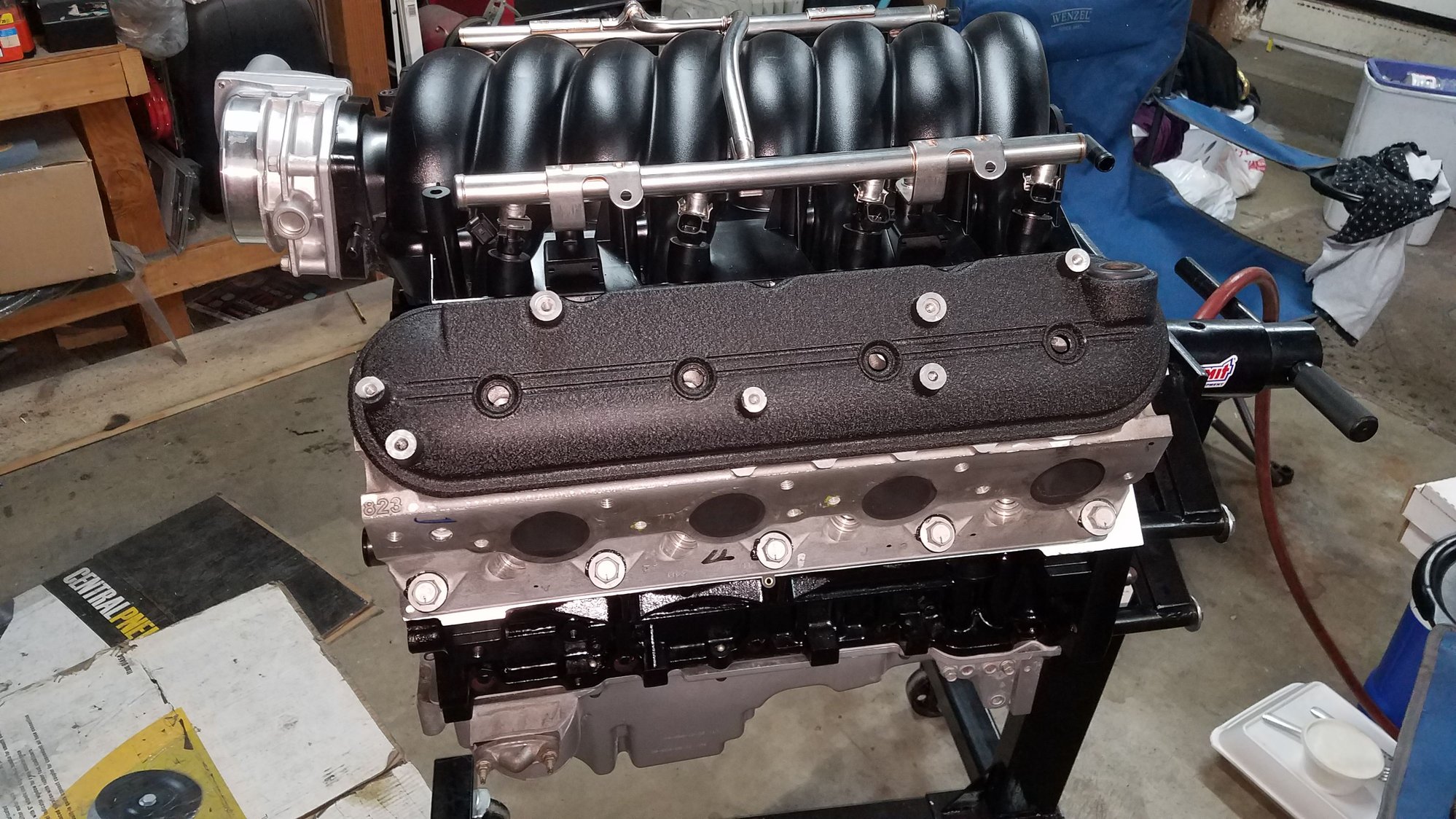

It's coming along tho. Hopefully I'll be pissing the neighbors of soon!

The head gasket should be ok, right?
Old Oct 25, 2017 | 01:54 AM
Number Tew's Avatar
Joined: Oct 2017
Posts: 182
Likes: 9
From: Orlando
Hey it looks good at least! That's half the battle right there
