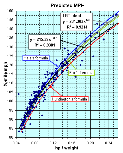

newtons equation is pretty linear. F=ma. angular acceleration takes a similar form. power is pretty linear, too. power = force x (distance/time).
but, that doesn't really relate to power/weight and quarter mile time, the reason being (i would imagine) that the total forces on the car aren't constant during a run. force to the wheels changes during a run due to gearing, torque curve, parasitic loss (which can increase with speed and rpm as well as horsepower, depending on the component contributing to the loss), and acting against the car as well you have areodynamic drag, rolling resistance of the tires, etc.
looking at graphs of mph and ET's vs power/weight from data sets taken from a lot of different cars, you never see a line. it's always a curve that falls off the faster the cars go.
