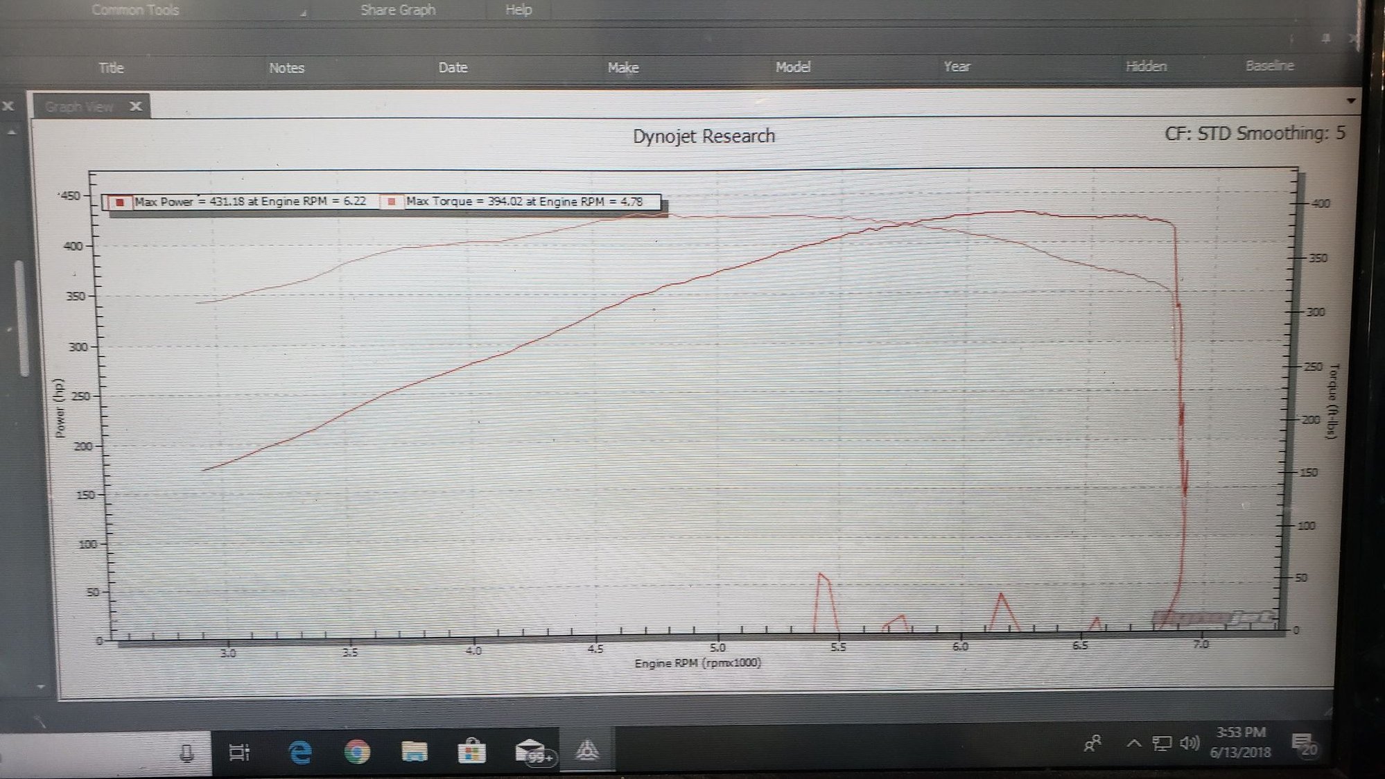

Well guys, long story short... I went with the 5.7 lol. Used Wiseco forged pistons and Ls3 floating rods in it. Also got rockers with the trunion upgrade at a good deal so put those in also. With the prc stage 1 243s and found a smoking deal on a fast 90. Got a 92 mm TB in another good deal also...
Honestly, with all that I expected I little more out of it but we'll blame it on the heavy ls7 clutch set up along with a steel drive shaft and the giant 12 bolt.
car made 431hp/ 394 tq.
a trip to the track will tell a better story but overall I'm happy. I'll try to post a dyno graph also.

Not bad numbers. I agree the track will be a much better indicator of its true power
