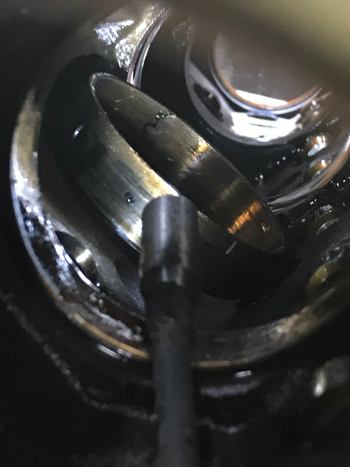

Worked on a buddies 6.0 with low oil pressure that was gradually getting worse to the point the light was coming on. Did the pump o ring. Then the pump. Then tore the engine down and the cam wouldn't come out. Middle cam bearing had been slowly walking out.

Well, there ya go....
motor is coming out and torn down next weekend...

Most likely a walked cam bearing. Seen alot of ls engines with bad cam bearings. Anything over 200k with original cam bearings is on borrowed time. I just tore a 250k 6.0 apart with a bad #2 cam bearing which spun the rod bearings bellow it. Good luck!
if the cam bearing spins, is the block toast ?

Line bore or line honing may correct any issues. Machine shop would be able to tell after inspection...
http://www.enginebuildermag.com/2006...oring-subject/

Got the engine out and disassembled today.
the cam bearing is cracked and scard up.
time for rebuild
