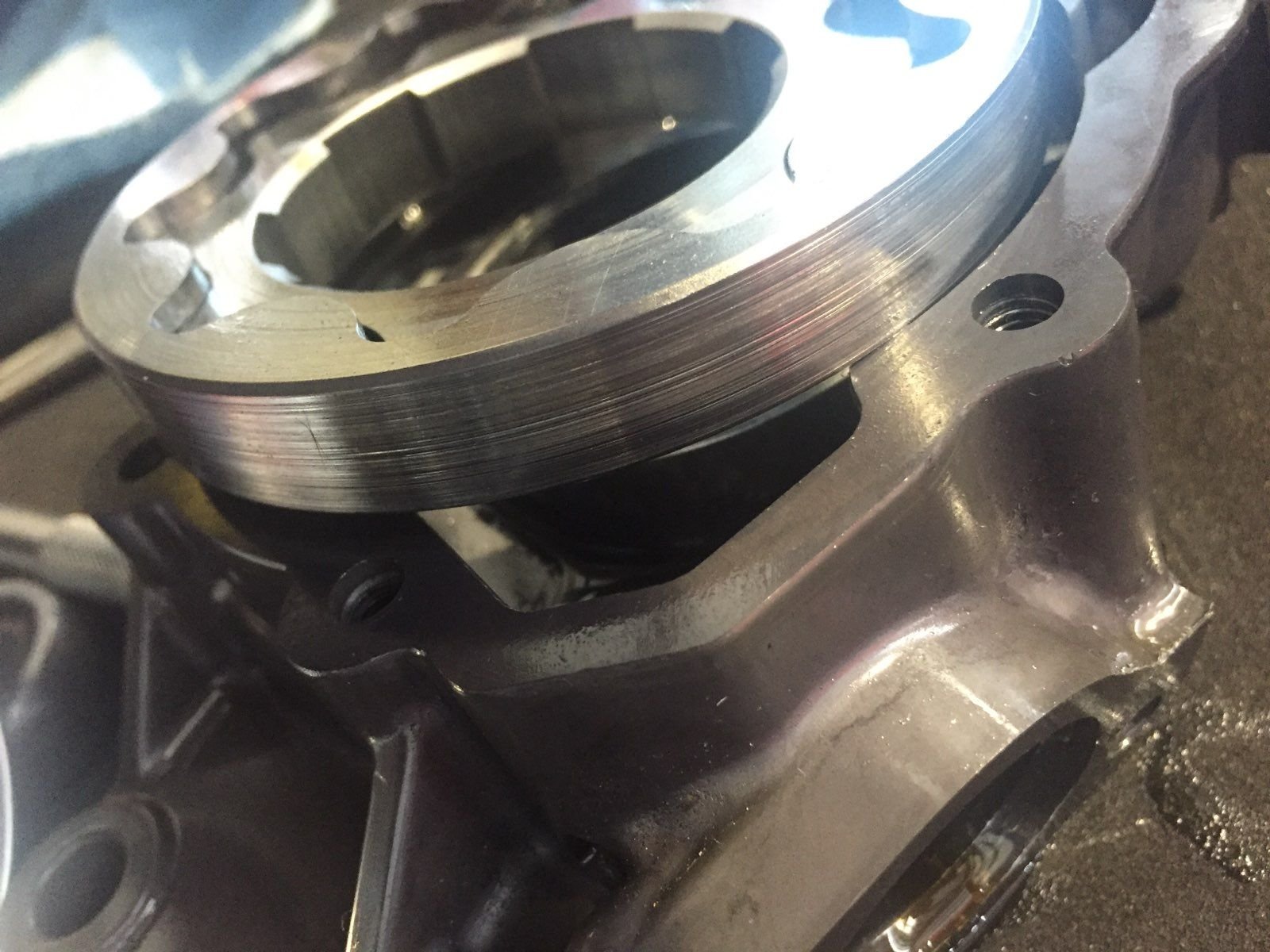

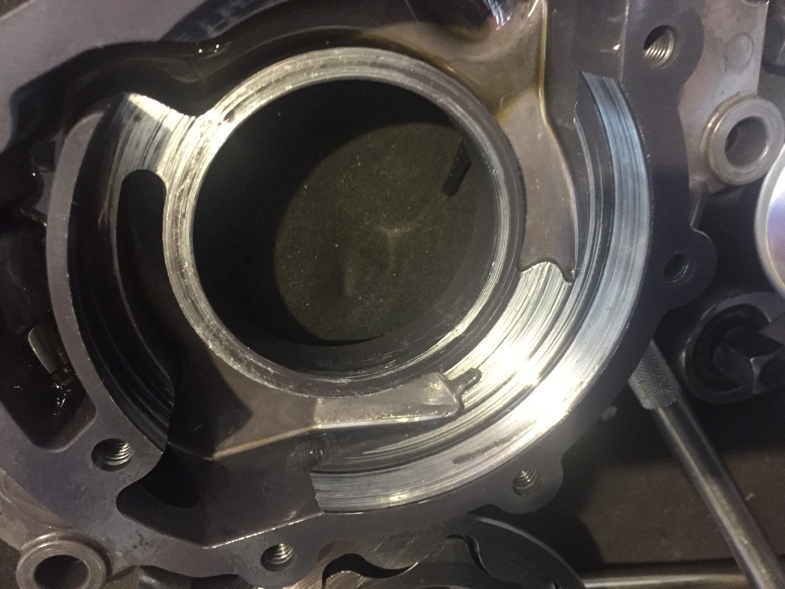

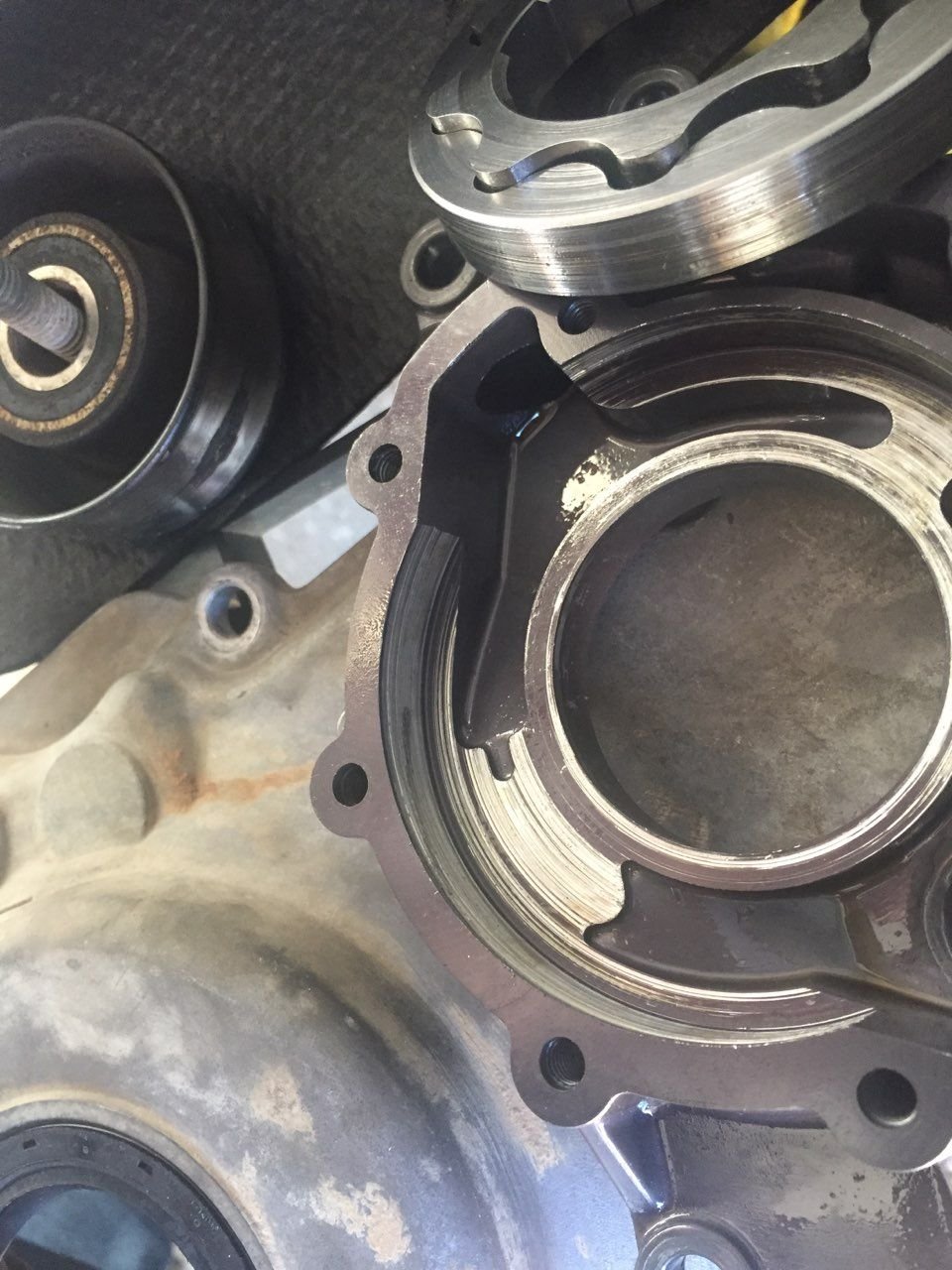

The oil pump was replaced...Twice. When the car was bone stock my oil psi was usually around 40 at idle and 45-50 running...When I had the cam installed, he put a new oil pump in...Oil psi took a dump as did the oil pump, so I took it to a LS speed shop in Houston and had that one replaced...the pump was either bad or installed wrong when it was done with cam...The first guy was supposed to change sending units, but I highly doubt he did since he did a half *** job with everything else...Im gonna take it to performance shop in Humble and get him to swap sending units and run a comp and leak down and go from there....

MTI in Houston found the oil ring was flat right after I had the cam installed...that's when oil psi took a dump and started leaking, within a week of cam install...Installer said he put a new pump, seals etc...this is what MTI sent me on what they found...Bad install is what they said. Damper was not installed right, grinding oil pump gear against outer housing etc..
