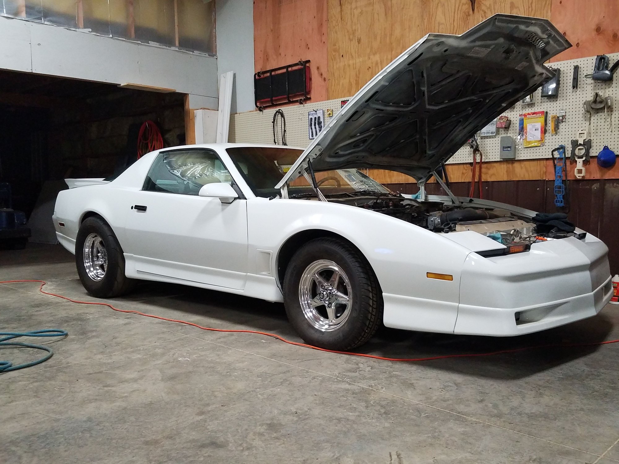

Pic of car5

Dang thats a nice looking 3rd gen!!
