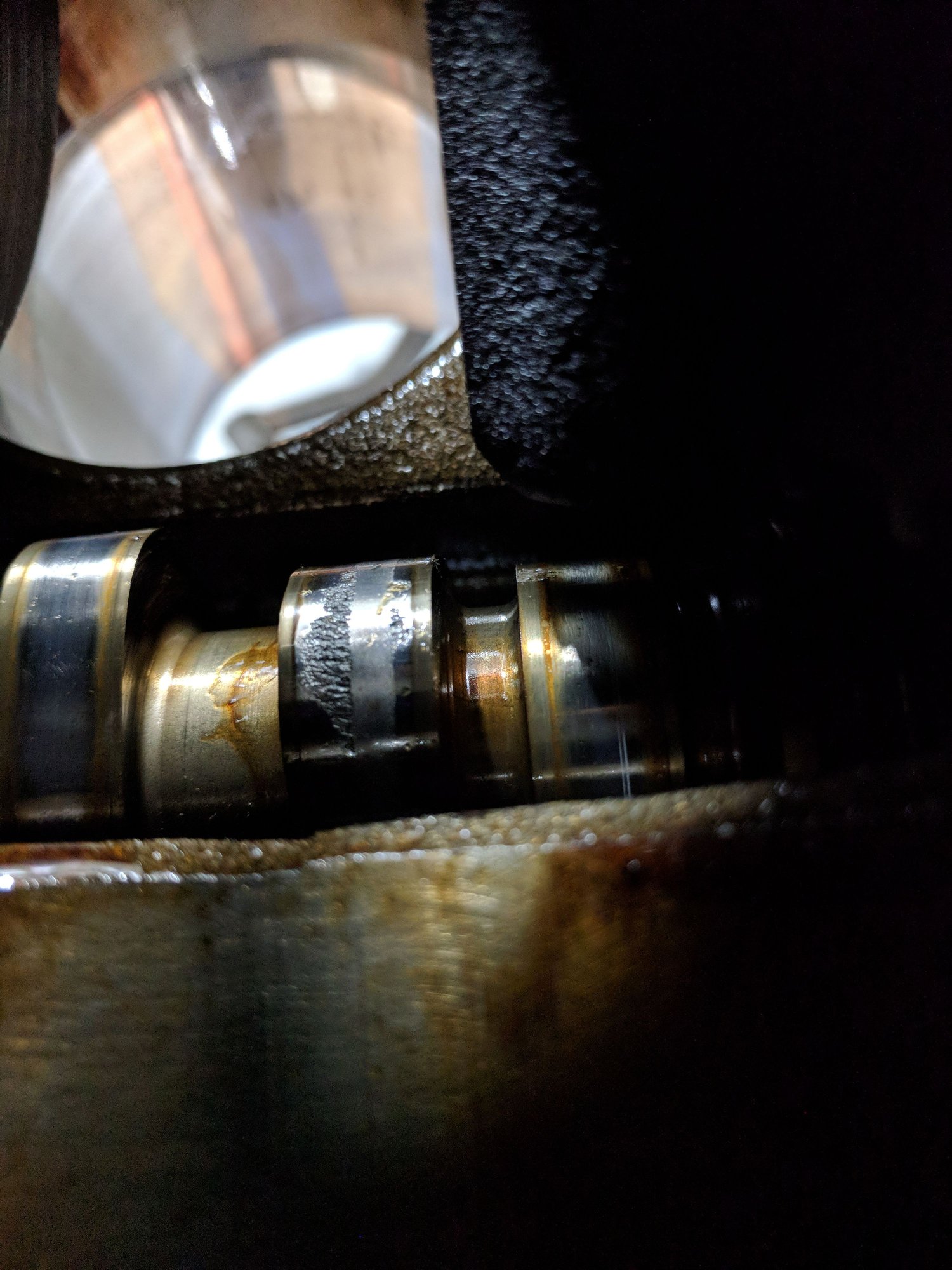

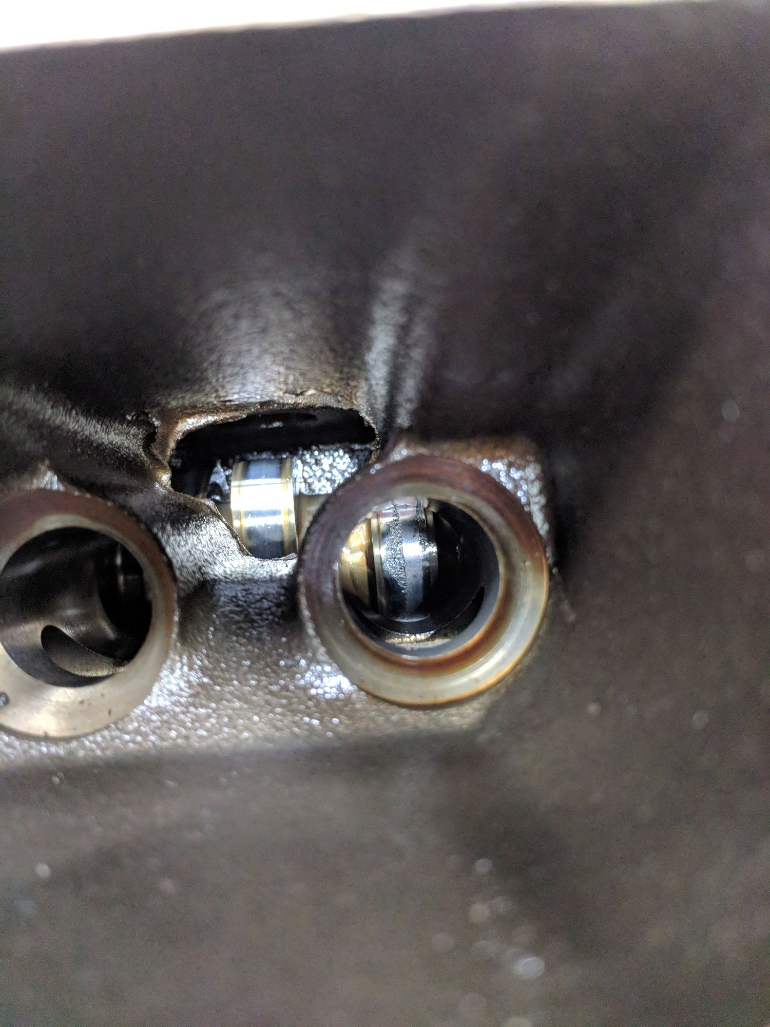

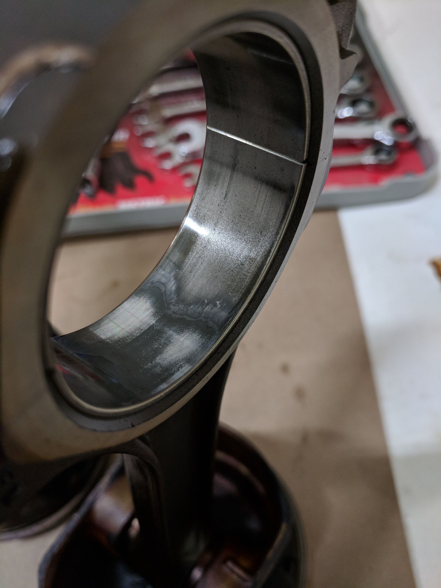

This is a Gen III 4.8 that was going to be mated to a 4L60/Atlas combo and go into a buggy project. Upon futher inspection it appears to have connecting rod bearing wear, and pitting/failure on a cam shaft lobe, cyl 8 exhaust. There was also some rust one cylinder where it looked like water had pooled there...... Any help determining the cause of this, and maybe a realistic estimate of a cost to rebuild this engine stock/mild upgrades? I am also considering purchasing a low mile pull out 5.3 and hope to have better luck with that.

The cam died first... wouldn't hurt to know what it was, and what valve springs were in it, and what oil pump. (and whether the O-ring was any good)
The rest is just collateral damage from the metal chips from that.

Just out of curiosity what heads were on that motor? 706 castings or 862 castings? Is it really sludged up? Pictures aren’t super conclusive but everytime I’ve seen some come apart like that water/coolant was involved.

I am not sure of the history. I purchased it in this condition, as it was supposed to be a cleam low mileage engine. Everything appears to be factory, 862 heads, unsure of cam, stock pistons and rods. As far as engine cleanliness, I was suprised at how clean everything was. My current thoughts are to bolt the heads back on and use this block for mockup purposes and buy a new/different engine when I am getting ready to fire her up.
