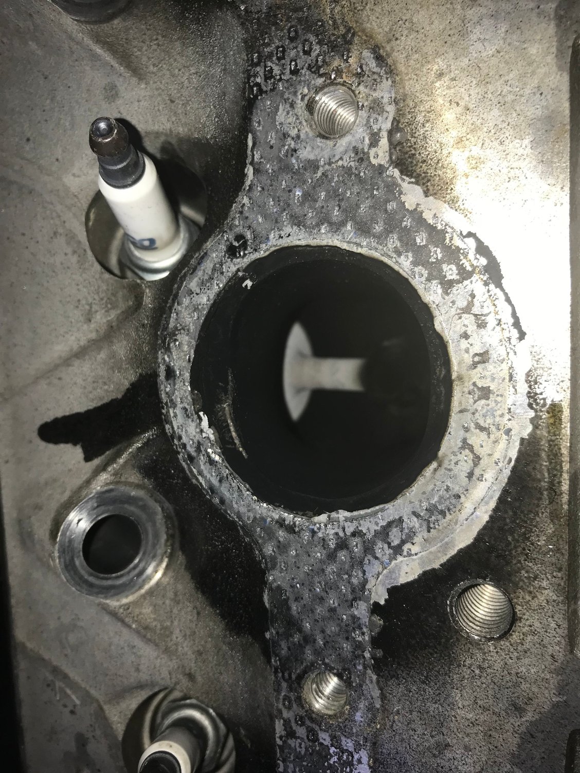

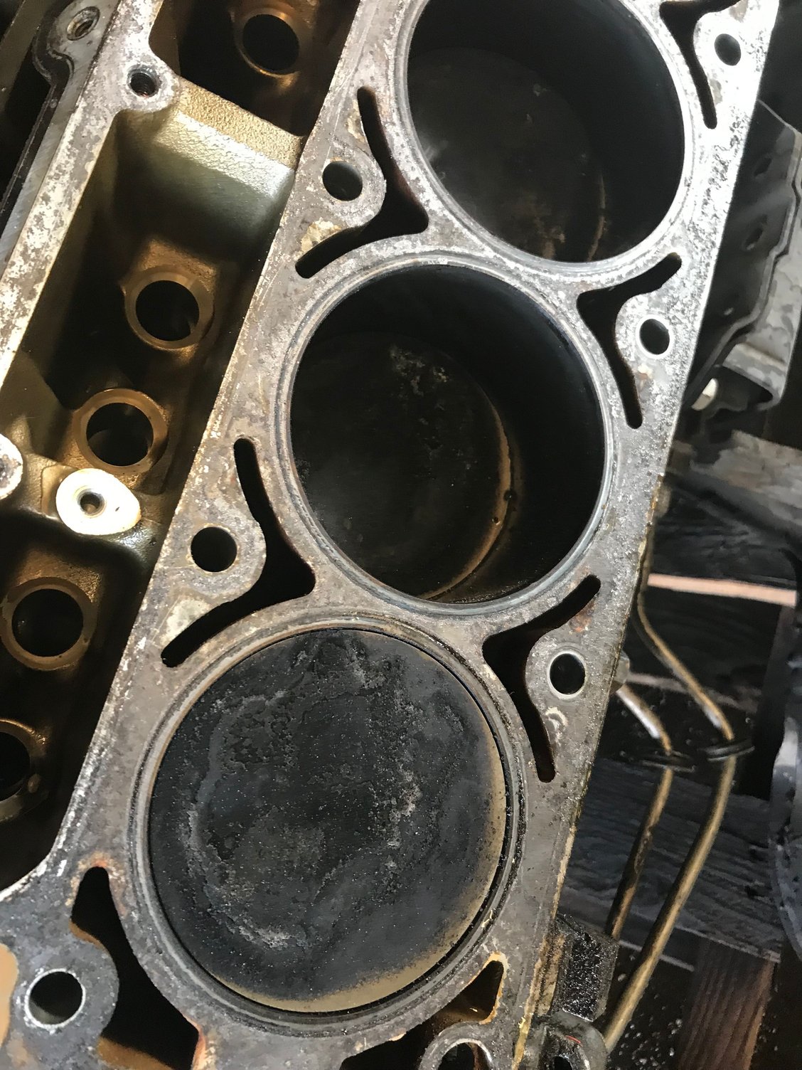

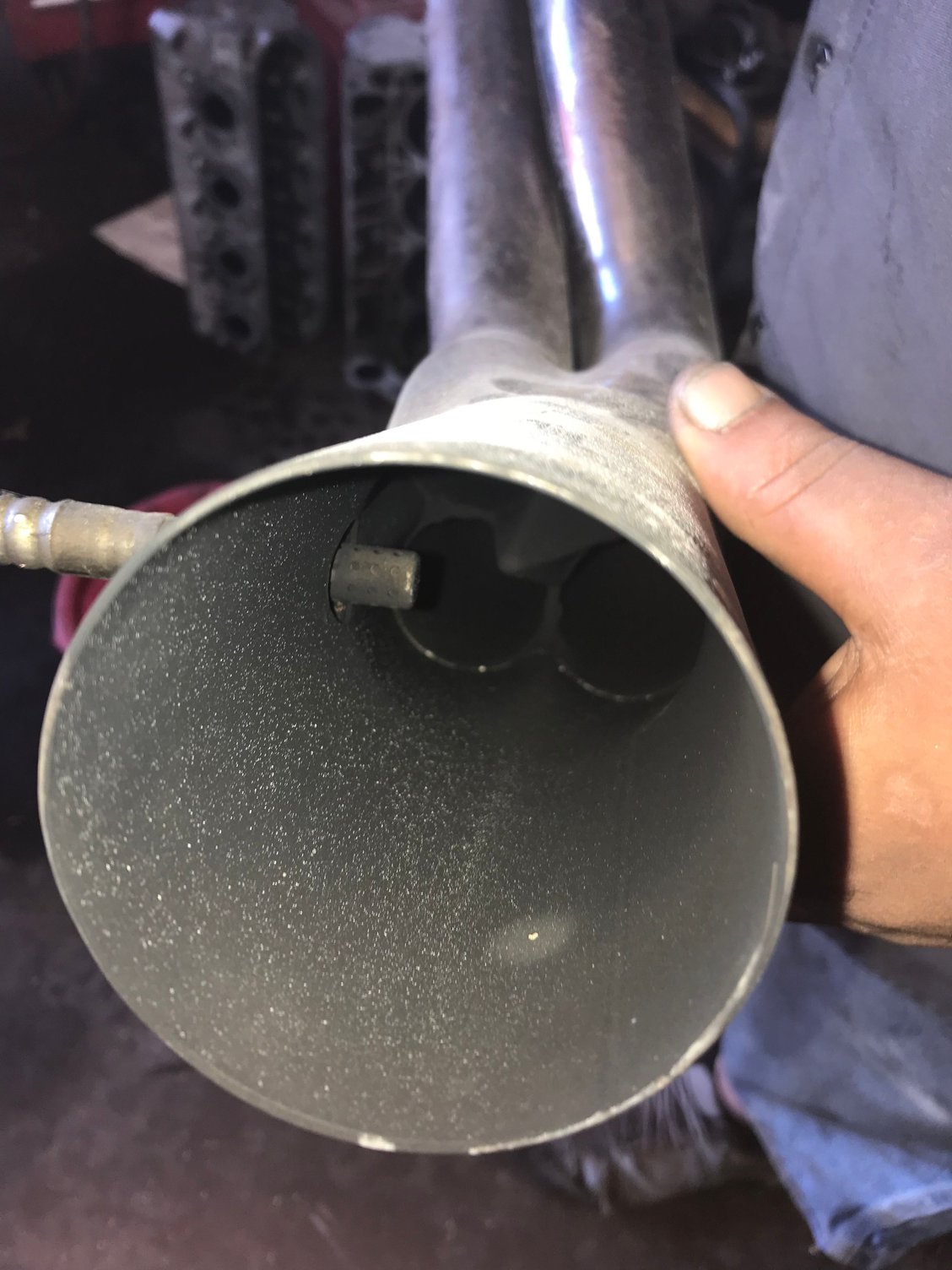

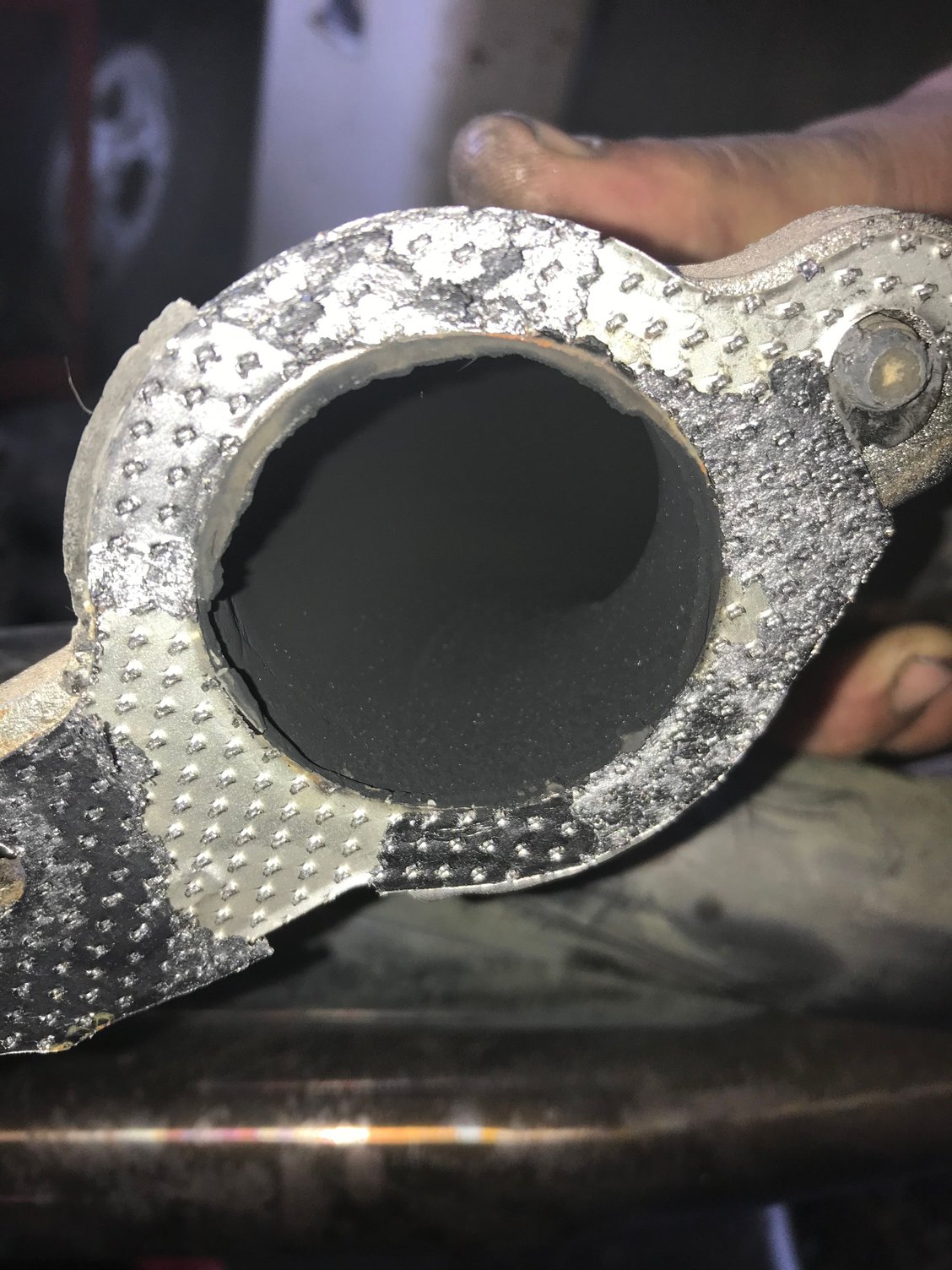

Ok so past several months I have noticed my engine using oil. No oil leaks on the ground so I assumed that it was consuming it internally. Pulled the engine and noticed so much carbon build up on the pistons, in the heads, and in the headers. My tuner says I am not running rich according to his tune. But my injectors are maxed out at 110%. Stock ls1 injectors.
Heads, cam, intake car. what could have or what could be causing this??? Not to familiar with seeing this much build up

Burning oil. Usually when your buring oil it builds up in the exhaust ports and on the exhaust valves. Black carbon looking smutt.
Im geussing its time for a rebuild. Rings are done. Could also be bad valve seals. Usually when seals are bad engine smokes pretty good on a first start after sitting over night. Do a compression test to know for sure.

I've seen worse, but that aint good. Was the intake wet with oil behind the throttle body? Bad valve seals not going to help you either. Check valve guides for excessive wear and test/replace valve springs while you have it apart. Its always a good plan to install fresh valve springs. I'd be upgrading those injectors while your at it

The intake did not have any oil that it was using. The valve seals definitely were a problem. I have already ordered new valve springs.
I thought at first this was a tuning issue and it was running pig rich.. does a tune not cause what is shown in the pics to why several people are telling me it was oil consumption? Like I said I've never seen this so I would like to make sure i don't need to let my tuner known about this

I don't see really "excessive" oil consumption there.
Mostly, rich.
But to avoid oil burning, be sure to put thread sealer on the intake rocker bolts. They are exposed to the intake ports.
A bad tune, too rich, can add to oil control problems, in several ways. If YOU KNOW your tune is defective, take care of that, FOR SURE. Don't try to hack your way around already-identified problems.

If the intake has no signs of oil and the PCV hose is dry then its something else. Valves seals indicate by wet valve stems and usually build up on backside of valve. Overly rich usually washes everything clean int he combustion chamber. Lots of "usually" comments there because stranger things can happen. Was it down on power? Could also be rings as mentioned in second post. Hard to tell that without a leakdown but a good indicator is cross hatch on the cylinder walls. If the cyls are shiny smooth? Rings might be done. Wiggle valves to test the guides while apart you might as well inspect/measure everything. If this is beyond your comfort zone strip in down bare keeping all parts organized to their location and take the block to a machine shop to measure bores. Freshh valve job while heads off and new valve springs is a sound plan as well.

The piston tops look normal IF they were not cleaned during the h/c swap.
Post a couple plug pictures
Maybe 5k.
They were not cleaned during the heads and cam swap, and the engine was not rebuilt during the process either.

I wouldnt lose any sleep over the build up at all then. Smoke at start up is 100% valve leaking oil down. Id get a valve job and fresh seals button it up and go. If you do that you dont need a retune, if you swap heads or other gofast upgrades then you need to plan on another tune up as well. I doubt the o-ring is problematic now that the picture is clearer it sounds completely valve seal related.
