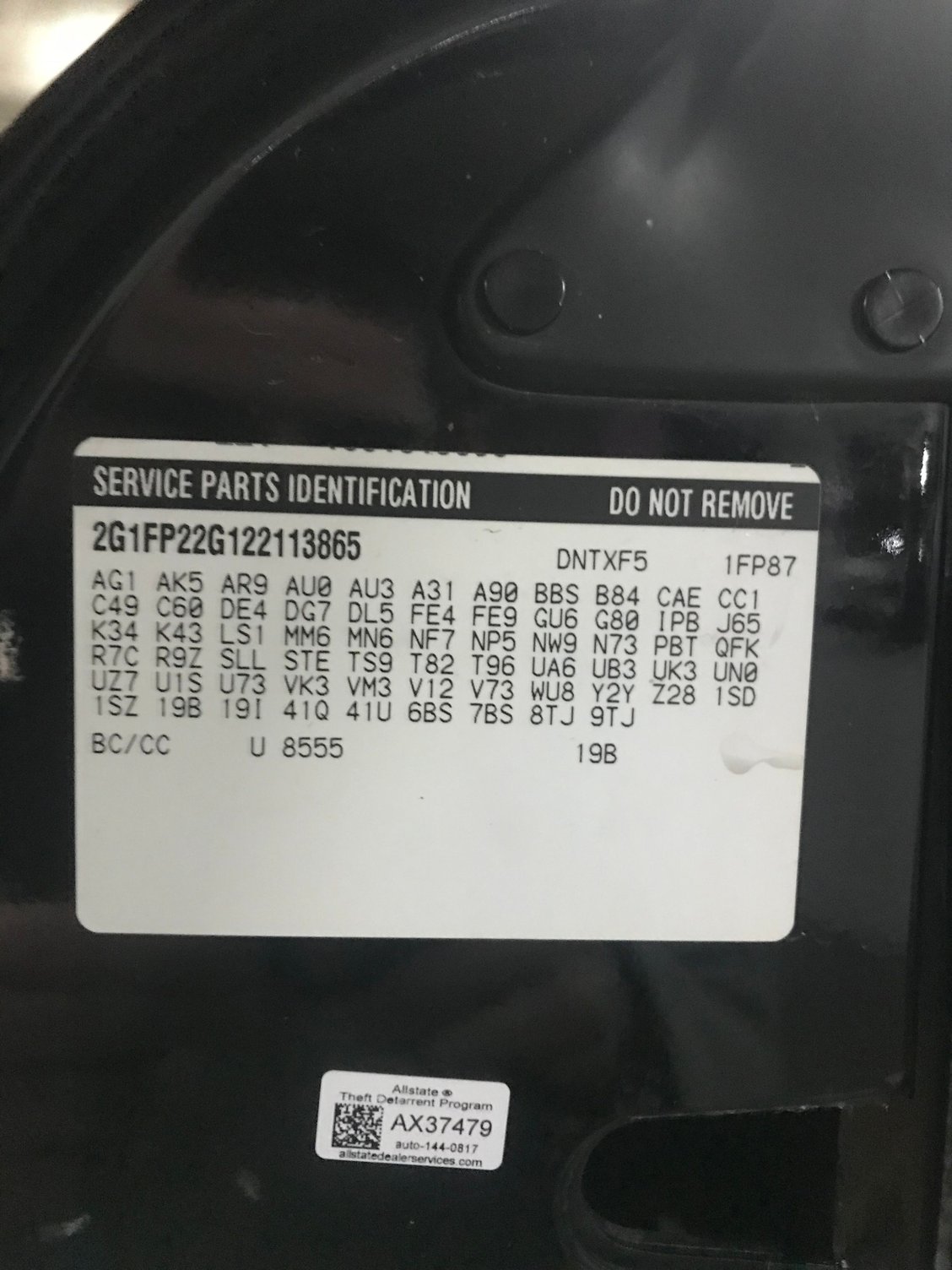

Im about to do a top end build on my car, and was looking for any insight on any parts I may be missing or over looking. Its a 2002 Camaro SS, just broke 100k miles last week. Here is what I have so far, just waiting on heads and intake from BTR to ship.
RPO sticker
