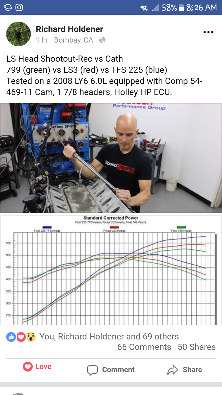

Rectangles is not always better up top or midrange eithier. Picture is worth a 1000 words.
