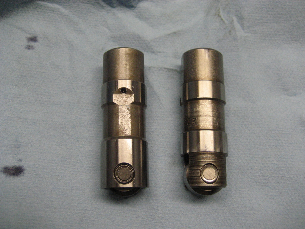

Just started taking apart the engine and found some small chips on the sides. Was wondering if anyone has seen this before or knows what would cause it, everything else looks fine so far have yet to look at the bearings.

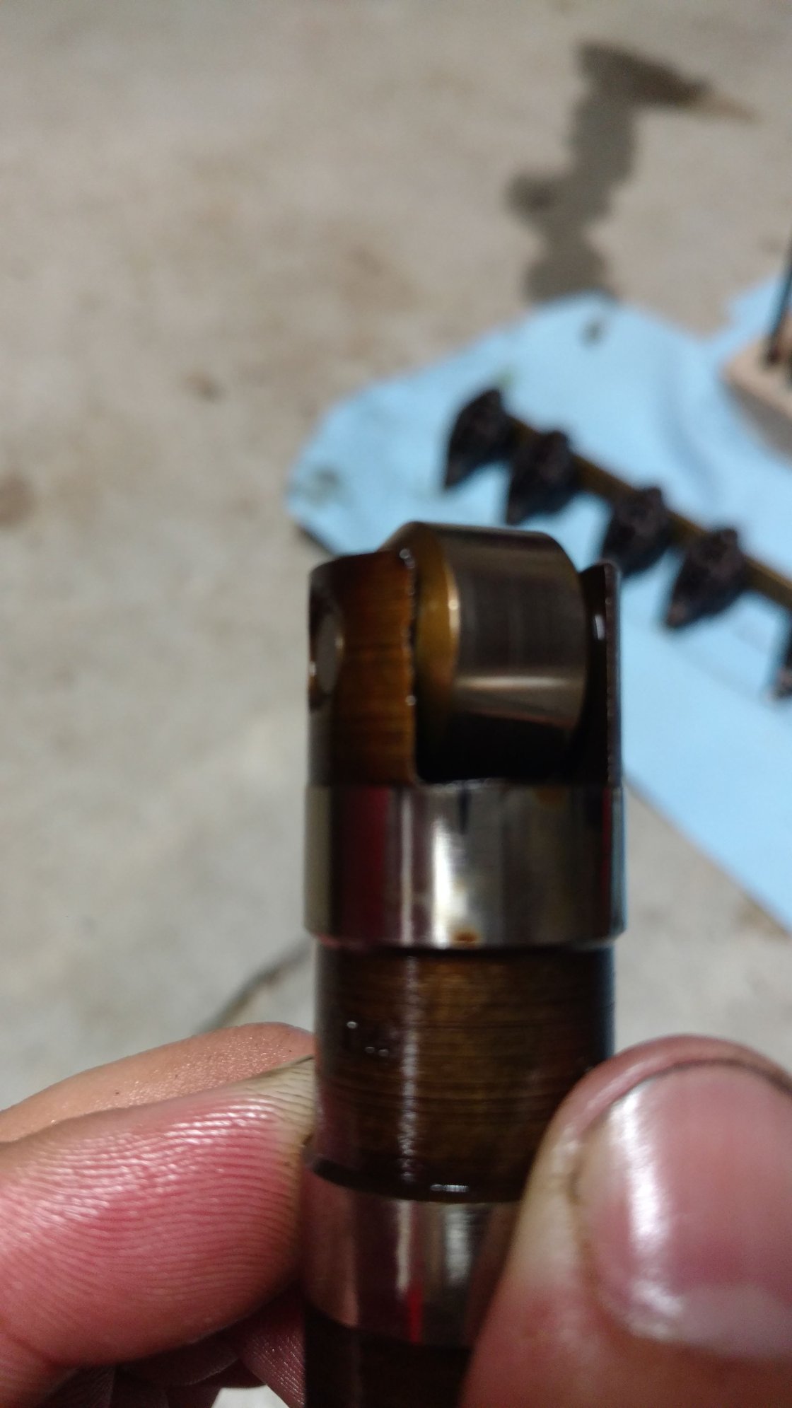

Has anyone ever seen similar damage before? My guess is a malfunction of the rollers not rolling putting the lifters in a bind with cam lobes . Heard common problem for this year and can be remedied with new camshaft/lifters.

FYI, those are not stock lifters, if you weren't aware. Where exactly are you seeing the chips? On the roller?

Why do you say they aren't stock? I hae seen lifters that were distinctly different castings, much wider diamater inthe unmachined shoulder portions

those are the early ones. the later "ls7" lifters have a full skirt.

Yes the ones with the cut away shoulder are off my 2006 engine the new ls7 lifters I ordered have no cut out portion.
