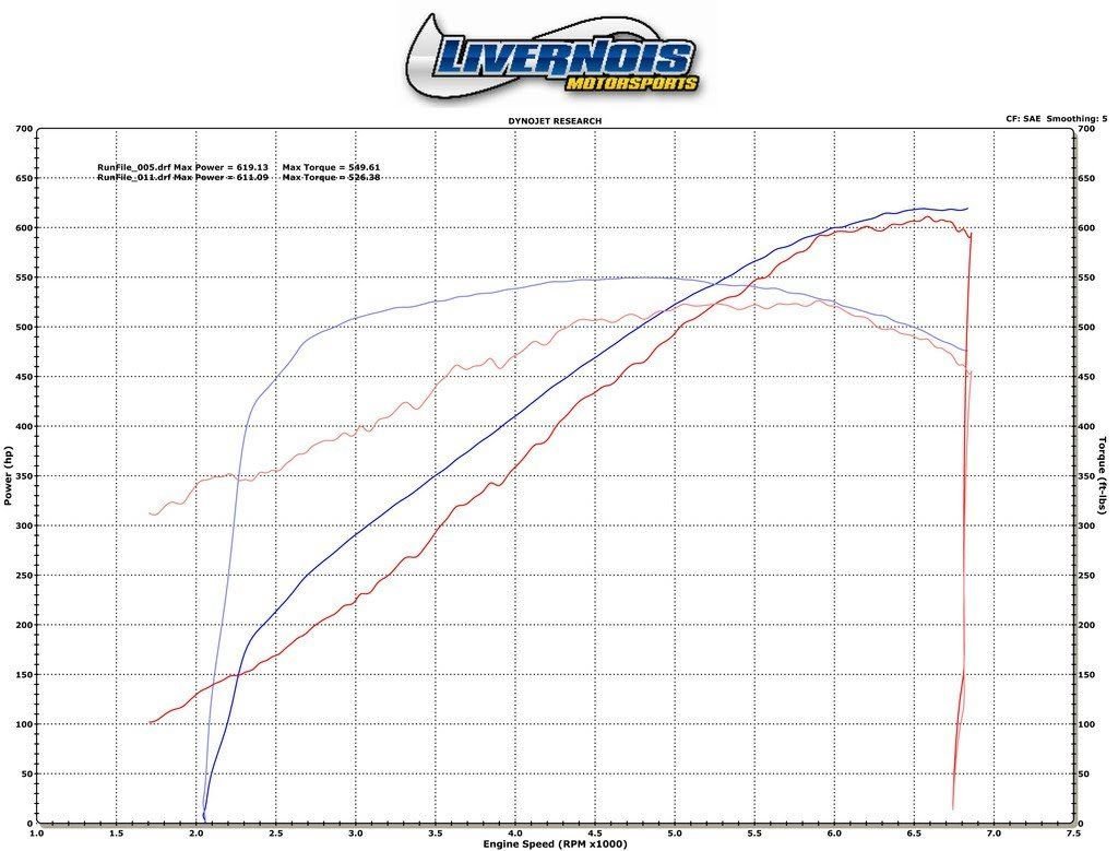

Here's a dyno graphs over laid of two identical build LS3 Camaros, by the same shop using the same heads, cam, tuner etc.
Link to article
https://www.google.com/amp/s/magnach...tive-test/amp/
Blue is MagnaCharger and Red is ProCharger.
Bruce the owner of Hawk's Motorsports is a big Magnacharger fan for street cars. Several of his personal hotrods have Magnachargers.
Magnacharger is impressive for 500 to 700 wheel horsepower builds. If my 91 RS's didn't have 11.3 to 1 compression, I would definitely have a Hawk's Motorsports Magnacharger on the car.
