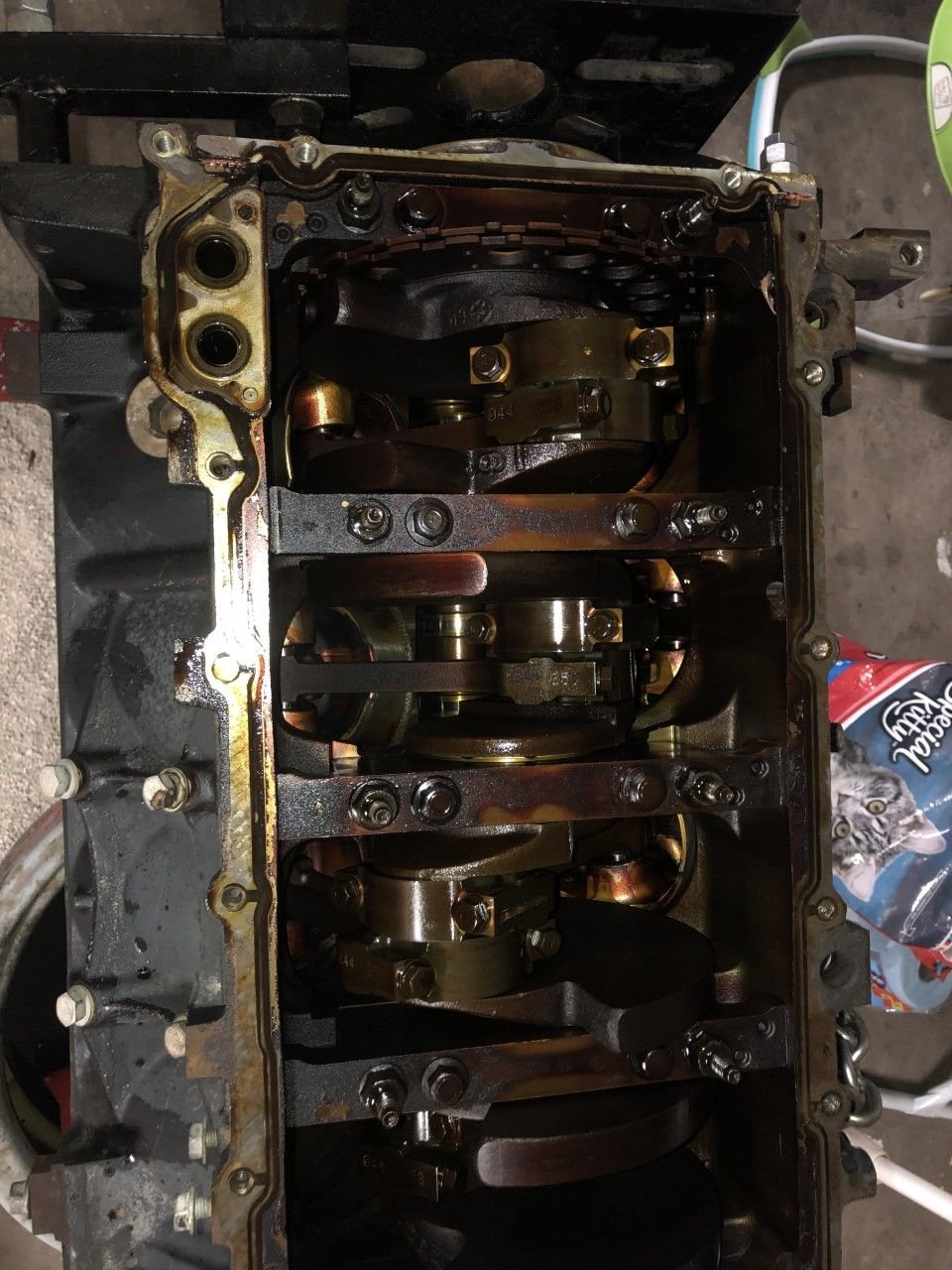

Bumping my old thread. Finally starting on my project and pulled the oil pan off the engine I bought. Guy was parting out a 2002 Escalade he bought at an auction. 200k on the motor. Rods look like gen4.

LQ9 was never available on 2002-2006 Denali from factory. Only LQ4, no other options were available.
To double check your particular 6.0, were the pistons on this motor dished or flat tops?
