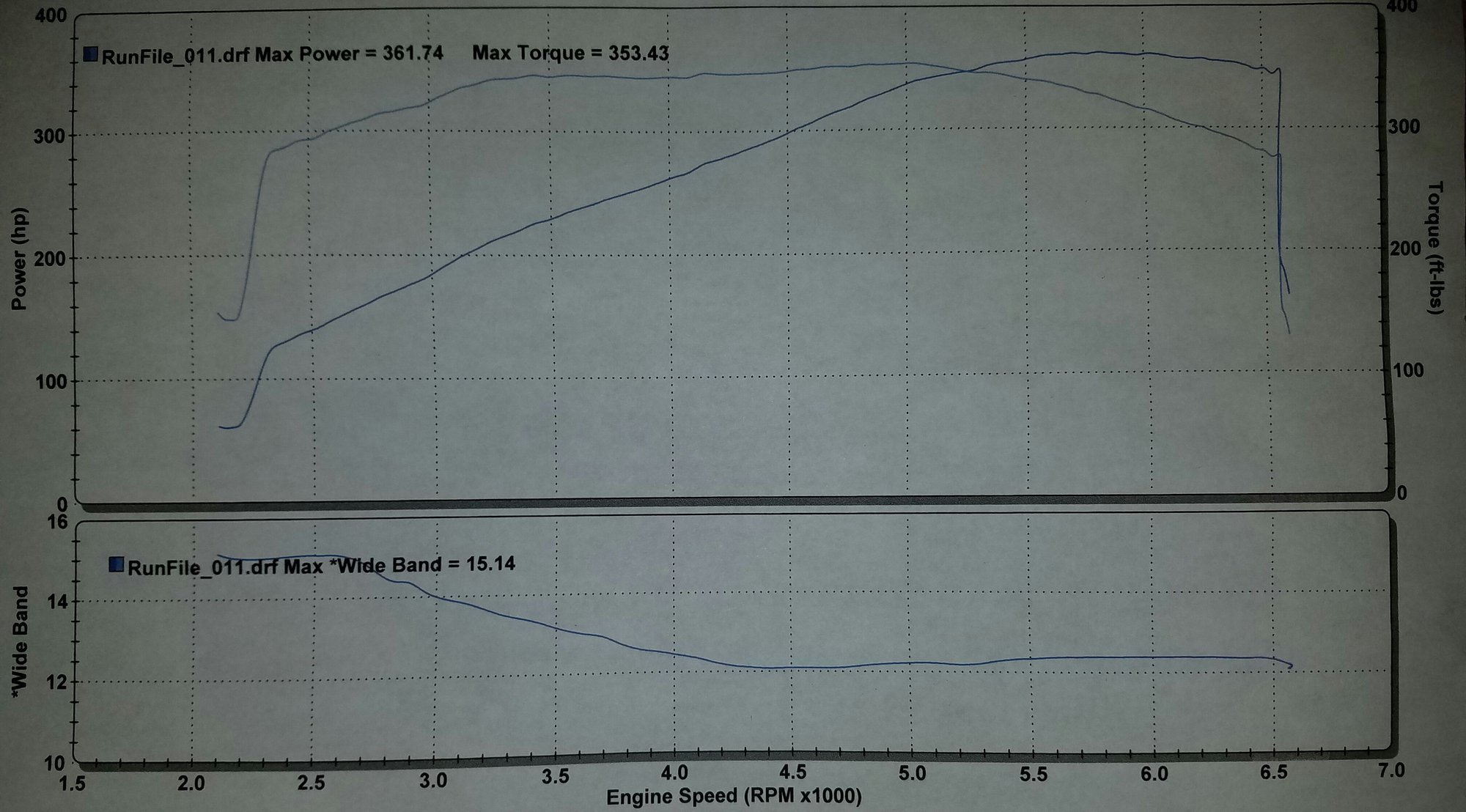

I just installed a TSP 228r cam in my 2000 Z28. I've seen the dyno results on here from 380whp to over 400whp. I had my car dyno tuned today and the best it could muster was 361whp and 353wtq. Has anyone run across this cam only making power in the 360's or was I expecting too much out of it? The car has an intake lid, LT's and full exhaust.

Could be just a stingy dyno too. Tell us more about the tune. Like timing and AFR

Those numbers are about where I'd say they should be. Most Cam only LS1s dont make 400whp (if we talk about "street cams" like you have) too many people on here claim bogus numbers that experienced professionals laugh at. Don't worry, you car is fine. With some stock 243 heads and ls6 intake you should be ~390whp. Aftermarket or ported heads and fast 92 should net you ~430hp.
Now let's wait for the trolls to call me out and claim their bolt on ls1s make 450whp. Lol.

That chart looks fine basically. How much timing? I'd seriously go run it at the track and see what it does. Trap speed won't lie

Not sure about the timing, what I posted is what the dyno sheet says.
So, I'm thinking I was expecting too much? I'll have to look around for an LS6 intake if that's the next choking point, heads are out of the question at this time.

Four years ago, I made 370 on a 227/235 cam with BBK intake, T56, long tubes, and a shitty Y pipe. That was on a 4000-lb roller dynojet. your intake is hurting. Power does look like it's peaking a bit early, which could possibly indicate the cam is advanced a bit, but peak torque is right at 5K, so not highly likely. AFR looks pretty good. Likely that run indicates best timing. You're on the low end, but not "something is mechanically wrong" low. Swapping in a set of 243 heads (ported if possible) will help a lot.

The engine is only going to make the HP/TQ that your heads/intake/tbody will allow period.... You can put the biggest cam, best headers/mufflers etc: and it wont matter, you need to fix the bottle neck in the system, get ported 243s, fast 92/92 tbody , Dorman LS6 or Chevy LS6 intake and take the airflow restriction away and you will see 390+ HP...
