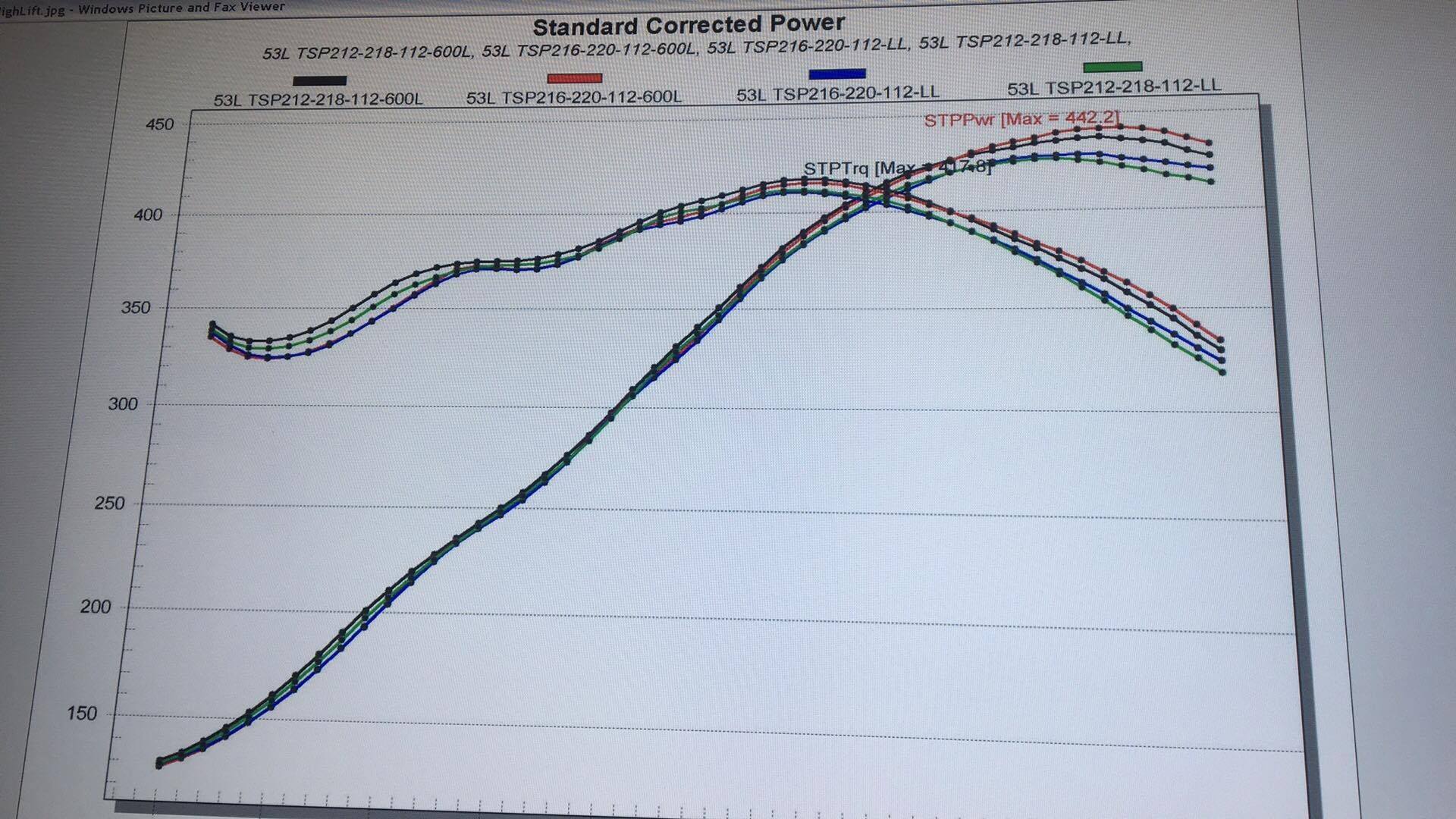

This is what i use in my 2 2500hd 6.0 trucks for towing and hauling
Texas speed stage 2 high lift. It doesnt make the most power out there and hardly has an idle but its perfect for what i do and what i need it to do.
You have to be realistic when getting a cam, whether it has a catchy name or not. What rpm range are you typically going to be using the engine in. A 4.8L lacks ALOT to be desired NA which is why most boost them, so if you are boosting, have that in mind.
6.0s are a different story but it all depends on the compression ratio there also and what heads you are going to use. I have an 07 nnbs 2500hd also i use the stage 3 tsp high lift 216/220. It had vvt and i ditched it. Just wasnt worth the hassle. Ive tried a bunch of cams in all of them and the tsp are the best when it comes to meeting my expectations.
I could use one of our signature cams like the high lift hot cam but like i said, youve gotta get a cam for the power and range you need, not want.
Most trucks will NEVER see above 3k really. So why get a larger cam that takes away your bottom end and towing capabilities? An rcsb is much lighter and normally not used for truck stuff as much so to speak to the range is a bit more broad and normally you can get away with using a larger cam there and never see an issue.
Id really depends on a few things but you have to be specific and not just ask for input otherwise everyone is going to throw something at the wall and see what sticks, and everyones idea of what is DD-able is different, sometimes way different. Ive seen no less than 10 cams on a few fb pages for sale because they weren't what they wanted.
Set a goal
Set a budget
Stick to them
My thoughts on cams are supported by alot and some have other ideas. Lift (to a certain extent) builds power. So does a narrower lsa, again to a certain extent. More lift on the same duration will also gain power and will gain rpm range as well. The adverse effects are nearly non existent within reason.
Here is a graph proving that. It also shows that bigger isnt always better
Thats the tsp low and high lift stage2 212/218 112lsa vs the stage3 216/220 112lsa. Theynare dynod on basically an L33 engine, so pretty much stock. And they are definitely not wrung out for max power. You can see the stage 2 high lift clearly wins above all. The springs are much quieter than the ls6 beehives also. They use a PAC 1219 on them.
Some of the parts etc are not necessary and youll spend extra money for no reason there also.
There is really too much info on the internet and you can read too much and go off in left field easy. Not all of it is right but not all of it is wrong either.
If you want more power in the mid range and top end a very nice aggressive sound and want to suppliment the bottom end and run a stock converter or small stall then this is a high lift hot cam install on an L33 with tsp headers in an 05 Z71

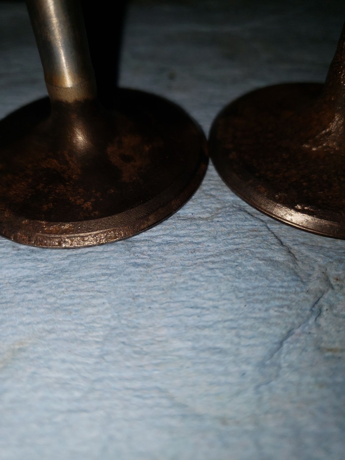

Also a friend got a junk yark engine. Pulled heads etc for a refresh. 3 valves looked like this
Both of those were unusable. He just wanted a clean up and quick lap. Not even 2 passes on the local machine shop valve grinder would clean them up.
One of the many reasons i am against running a used engine period if you are upgrading or not a dire emergency.
