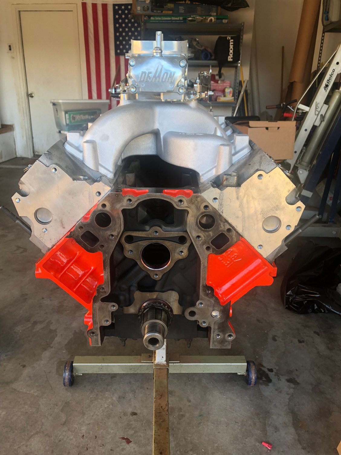

So apon inspection I have an odd ball block its kind of a cross 3 to 4. It was my under standing that if the cam position sensor was in the rear of the block and not the front cover than it was a 3rd gen. I also have valley knock sensor’s and the motor does not have DOD
All these finding led me to believe it was a 3rd gen. So why does it take 4th gen studs.

You definately have a gen3 block. I can tell by the opening into the valley, above the camshaft. What part number bolts did you purchase?

They’re definitely out there, I’ve run across a few myself so I always look at the bolt holes before I order.

Gen 3.5 that's the BEST year! 05!
Floating gen4 rods in a gen 3 block 24x. !
