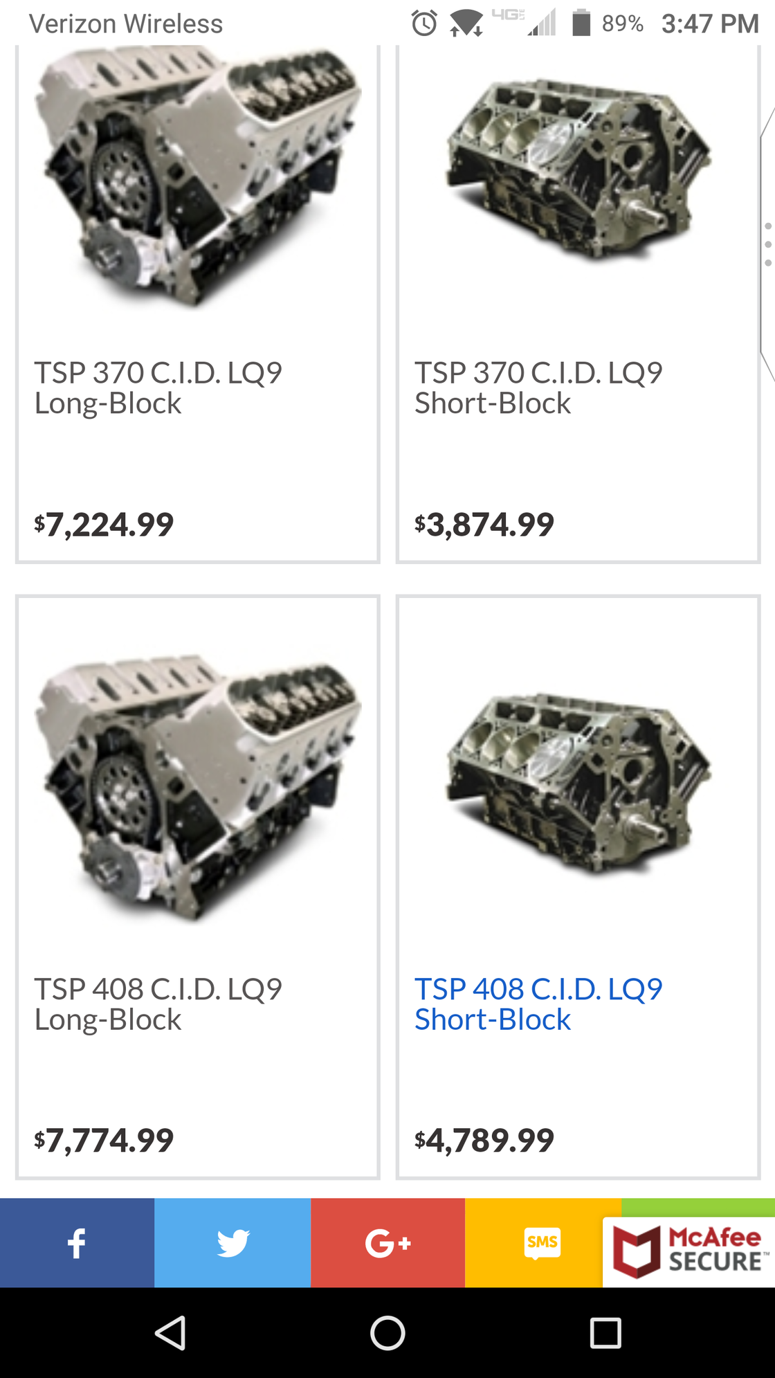

Think $12,000 for a shop to do it.
You can do it for less if you can do it yourself or with a good used 6.0 that just gets a top end package. Think half the cost or a little less.
Texas Speed's website gives a good reference engine cost if the shop is doing the engine build. Expect to pay about the following if a shop does the tune and installs the new engine.
Add about $4,000 more for
  • $1500 to swap the engine into the car.
  • $500 more for dyno tune.
  • ~1,200 Fast intake, 92 or 102 TB, 42 pound injectors,
  • ~$500 to $1,200 Headers & Y pipe depending on choice
