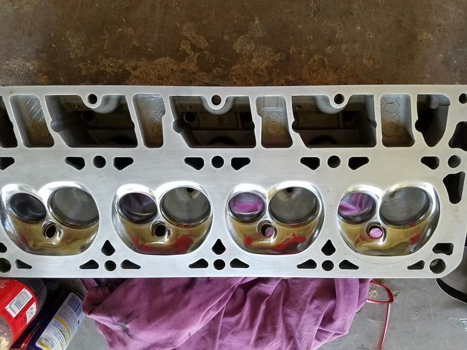

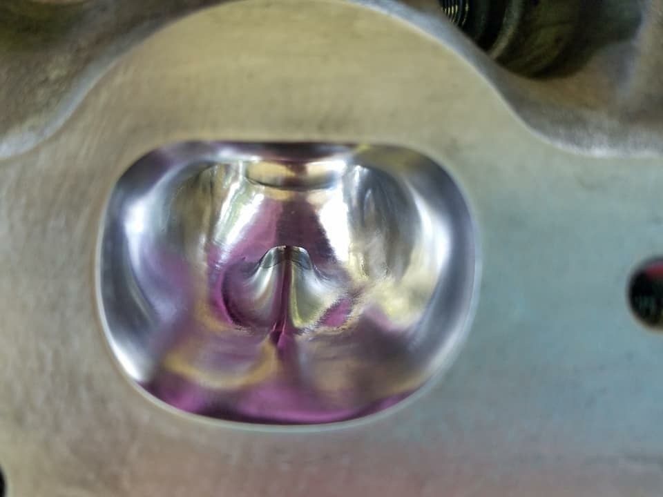

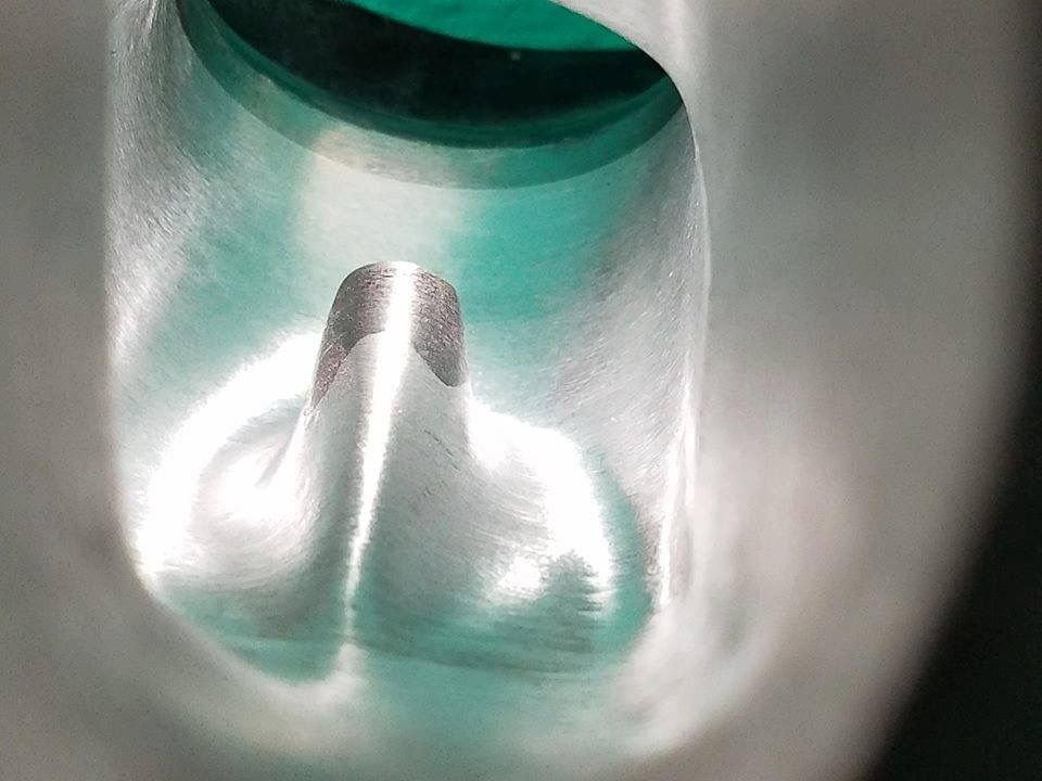

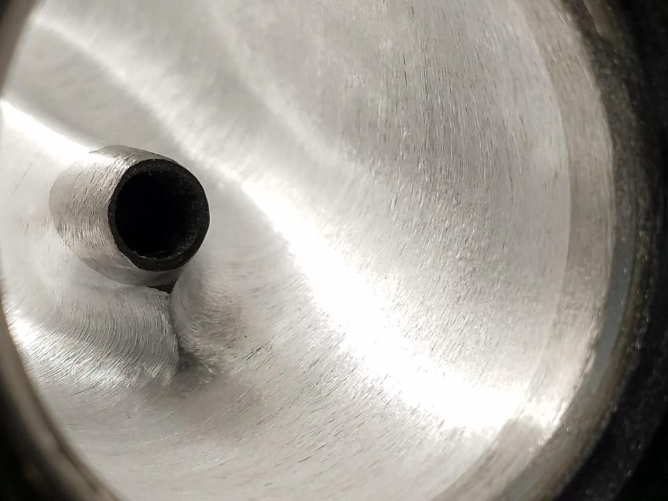

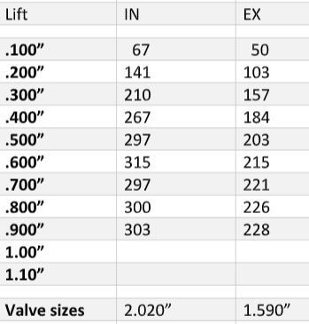

I sent my 243s for hand porting out of state.. When I got them back I took them to a shop in indy for a valve job and assembly...he also flow tested them for me, this is valuable info for Pat or anybody to spec your cam..Anyway, the bench was set for 3.900 bore, no pipe on exh which I understand knocks off a bit when compared, be sure to look at those tidbits at the bottom of flow charts. These were tested at a totally unrelated shop..for neutrality. To be honest I think the guy wasn't too thrilled I didn't have him port them but at the time I didn't know he even did that kind of work. They CC'd about 230-231cc on the I runner if I recall.
I paid $750 for the port work.
We'll see what they make, I had a cam spec'd by Pat based on these #s and a 11.5:1 LS1. It's def a labor of love, the guy I sent them to does nothing but port LS intakes and heads.
Sorry for the huge pics lol

Those look great

Those look great
Agreed...very nice!

Damn,
Very nice Hand porting . Love to see guys that actually know how to do it.

Yeah they appear to be opened up from the pics. Guess I am a day late and a dollar short .thx for reply back .

i ported my own 243's and didnt make the port very much bigger. Heres my numbers:
intake ex no pipe
.200 138 100
.300 200 146
.400 245 177
.500 280 193
.600 300 201
.650 301 204
of notable mention. his bench is stingy on exhaust and also he sent me s heet where he flowed with a pipe at .650 it did 208 and add a pipe it did 244. so mines at around 240. not bad for a shade tree lol. stock valves too btw.
I think those numbers for that price (the op) is pretty damn good. ive got weeks in mine and multiple trips to he flow bench.
intake ex no pipe
.200 138 100
.300 200 146
.400 245 177
.500 280 193
.600 300 201
.650 301 204
Thats pretty impressive what volume are your runners at.

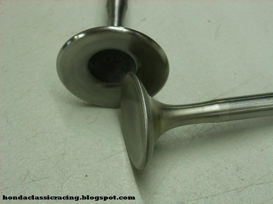

When you say you reshape the exhaust valve rim ....... are you putting a radius on the margin chamber side of the valve , ... or something else ? Did you add any back cuts .
Old Dec 21, 2018 | 10:51 AM
  #53
Kfxguy's Avatar
Joined: Apr 2017
Posts: 4,582
Likes: 758
From: Louisiana
no back cut. I rounded the edge of it facing inside the chamber. My theory was it would allow the exhaust to flow around it easier. Buddy with the flow bench said I was wasting my time. Until I saw a nice improvement for no money spent and maybe 30 extra minutes. I always do this on my heads anyways but I wanted to see if it actually worked.
See the top pic in this link
https://www.google.com/url?sa=i&source=images&cd=&cad=rja&uact=8&ved=2ahU KEwjQmbSHsbHfAhVIOq0KHTBdCIwQjRx6BAgBEAU&url=http% 3A%2F%2Fhondaclassicracing.blogspot.com%2F2010%2F1 1%2F90-valves.html&psig=AOvVaw3ZCmi6r1WE7u51u04pITvH&ust= 1545497512444606
For whatever reason I can't tell much from the pic in the link, and it redirects so I'm not sure if it's the same one. But it sounds like you essentially did the same thing as a back cut. Sounds like you're saying you smoothed the valve instead of actually cutting a back cut angle in it with a cutter
its not the back side (port side) that I cut. I rounded the edge that is in the combustion chamber. It allows flow to go around that edge easier with no negatives in the flow curve. Here’s the pic I tried to post a link to. DONT do this on the intake valve, exhaust valves only. dont reduce the diameter of the valve when you do it. I chucked it up in my drill and rounded against my bench grinder and the smoothed it with 400 on my belt sander and then polished it to get rid of scratches (potential hot spots)

Ahhh now I smell what you're cooking. And also duh, you said facing the chamber.
Yes he's putting a radius on the chamber side of the margin . I believe it helps more on low and mid lift .
It is interesting and it should help. Never heard of that one, learned me something new today!
I don't see why it won't help on the intake too. I think most of us by now know that the airflow rolling off the back of... say a car or motorcycle, is less turbulent if the exit point is rounded/smooth. Picture the rear of a busa vs a pickup truck for example.
Did you try it on the intakes and flow bench it?
nah I didn’t, for good reason too. Think of it this way. If you allow the intake to “backflow” better then you’ll get more reversion. The thing to do on the intake valve and helps with better cams to deter reversion is to cut a flat angle on the edge at about 45 degrees. Gases in the chamber hit the chamfer (you’ll notice most aftermarket valves have it already but smaller) and are deflected back into the chamber.
It doesn't work on the intake side . You have to keep in mind the direction of flow . It works on the exhaust because the flow has to hit the face of valve move around it turns goes down past the seat into the bowl. This why many do not put a back cut on the exhaust valve.and a tulip shape works well on the exhaust. The reverse is happening on the intake.side.
