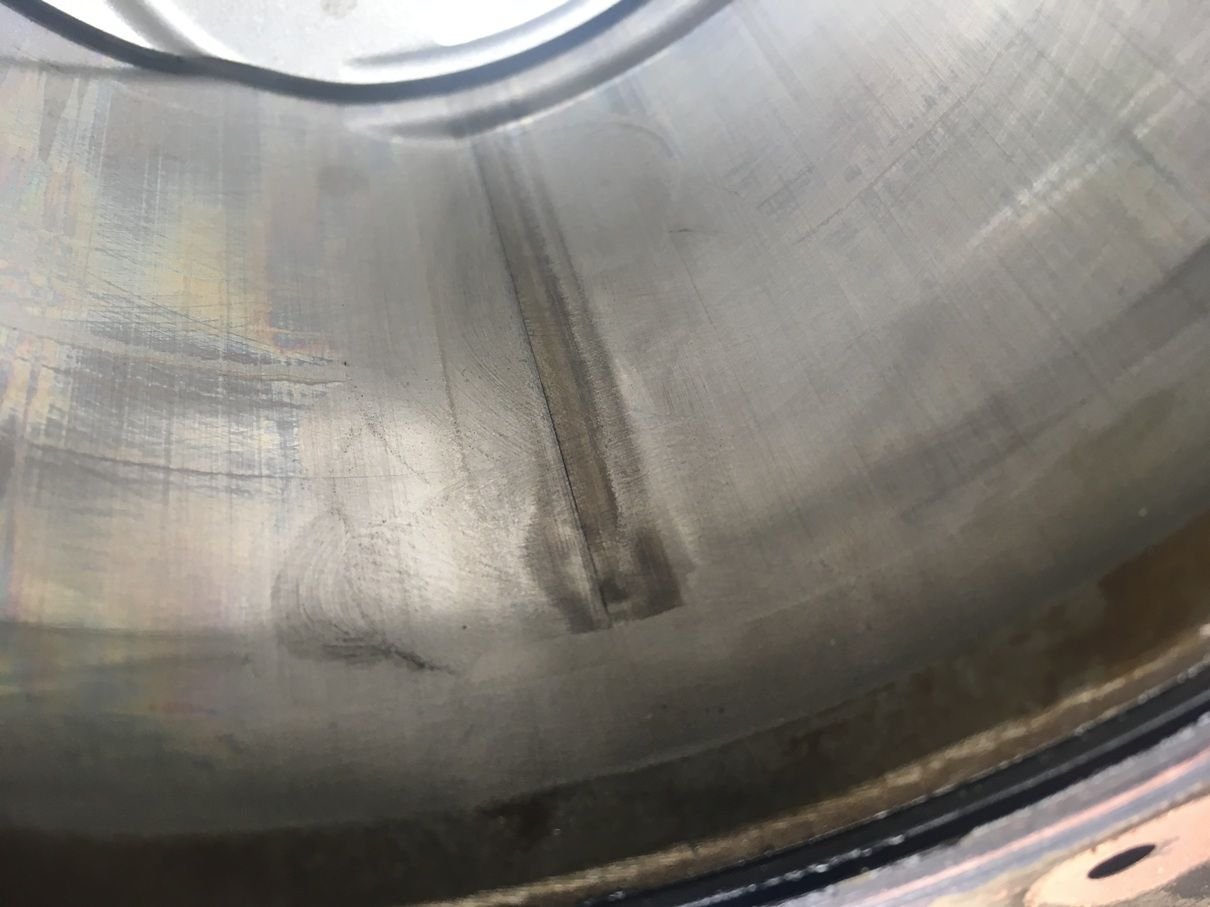

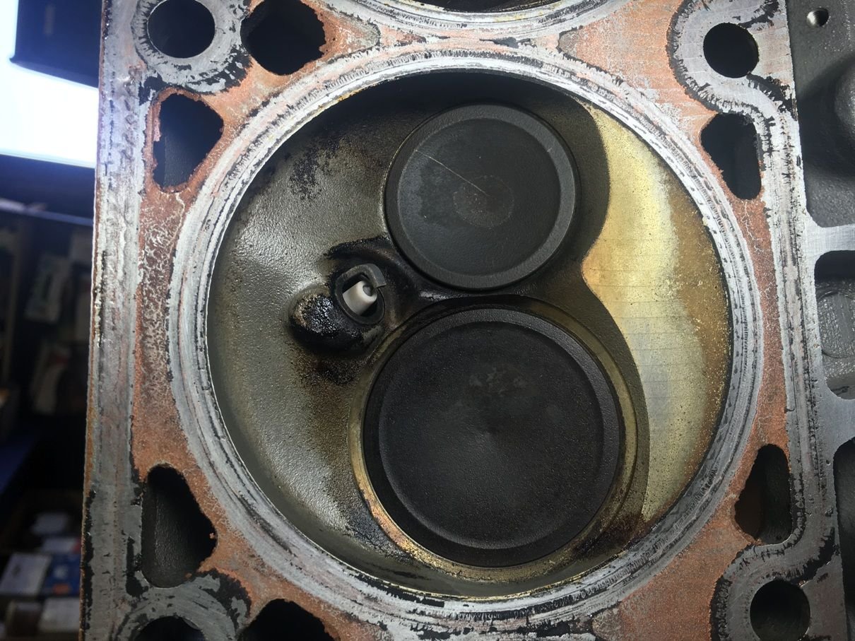

Bringing back my old thread with an update to close it off. Finally got some time and space to pull the heads off to try and dig into this knocking sound I had after my fresh rebuild. Thoughts based on input from this thread suggested possible piston/heads interference. I ended up finding what looks like a crack in the #5 cylinder wall and similar issue in the #8 cylinder. I have a 1998 LS1 block and safe max overbore is considered 0.004". My machine shop felt we could try for 0.005". Everything looked fine to my eye when I got it back, but I am new to this so not sure if I could have caught it before I put everything back together. I wonder if this was causing the knocking sound I was hearing but that's irrelevant now lol.

Almost looks too straight to be a crack.
Did you find for sure whether the pistons were hitting the heads?
What I've read is that the max safe bore on 97-98 blocks is 0, since the sleeves can be out of alignment in the block.

I didn't see any obvious signs of the pistons hitting the heads, but it looks like in some spots they could have been very close to hitting based on the patterns in the deposits?

Must be a crack and coolant getting in because #8 is steam cleaned
