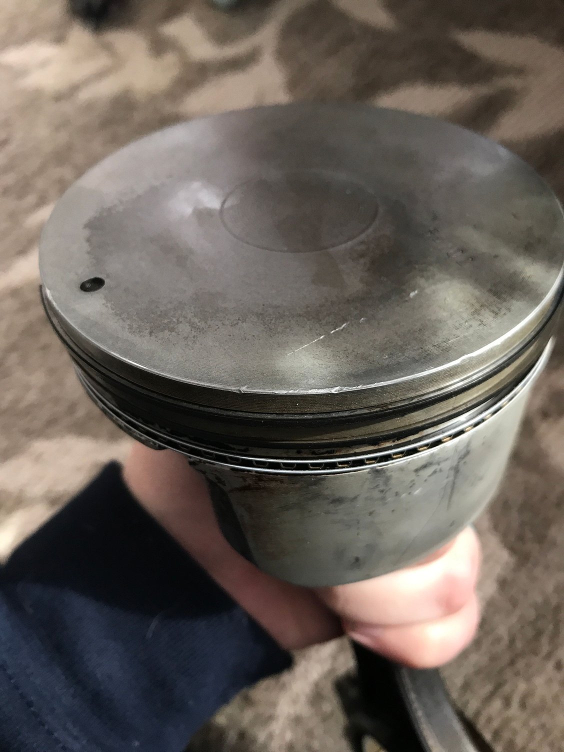

I bought these used off a guy on Facebook. Everything went smooth with the transaction and he said these pistons were in good shape. But 2 pistons I received had marks or were chipped. Are these ruined and if so should I ask for money back considering he said all 8 were good to go?

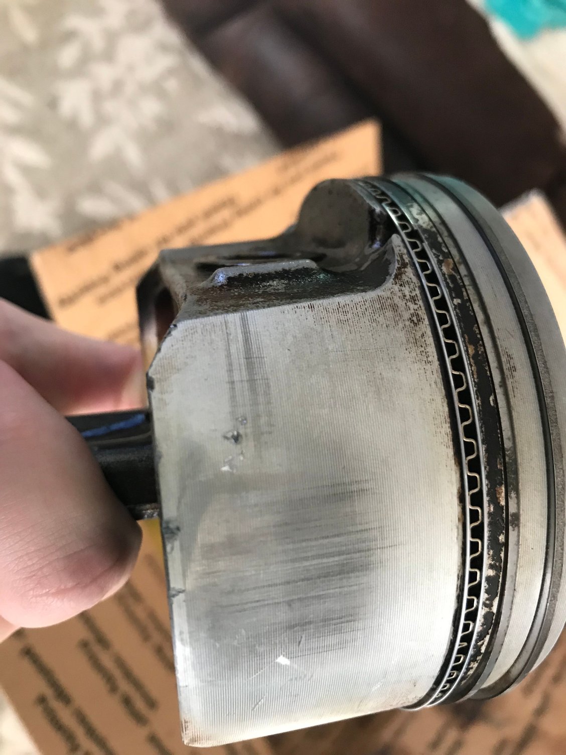

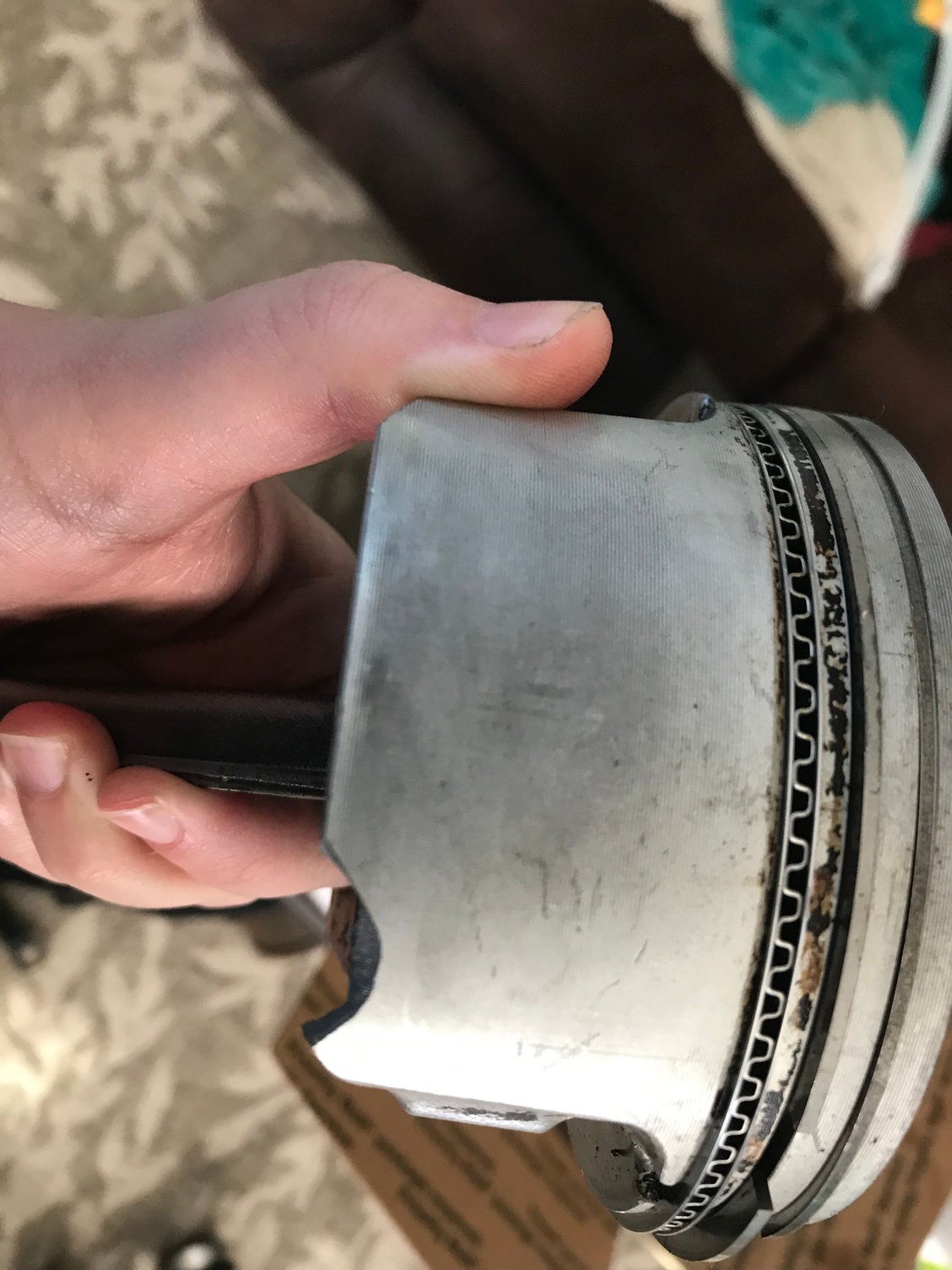

The chunk missing from the skirt in the first pic might worry me a little, could maybe throw the balance off? But then again maybe not I do not know.

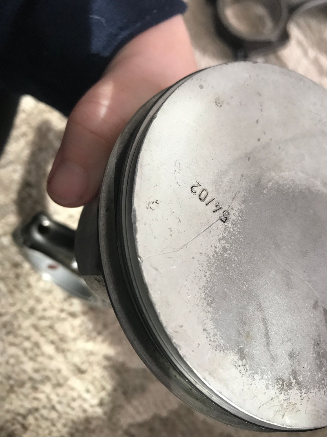

The second pic doesn't look bad, just need to carefully knock down any high spots protruding up from the piston skirt with some emery cloth.
The third picture makes me wonder if USPS is to blame?

The nicked one could just be lightly sanded smooth.....
but the one with a chunk missing..... No way id run that lol

No, I wouldn't worry about the little knicks or gouges, just dress them down with some emery or something and make sure they're smooth and don't stick out farther than any of the rest of the piston. I can't say for sure if that chunk missing would be a problem. I think if it were me though, I'd be questioning either USPS and/or the seller in terms of what happened. Did the seller not package them right like Ls7colorado said. And/or did USPS just throw it around and break it.

That piston with the chunk out of the oil land looks to have oil staining on it and I would say it was run like that in the previous engine. i suspect as the engine runs , the oil scraper will eventually hook on the edge of that space caused by the chunk missing and be a source of an easier path for the oil to go where it shouldn't.
I agree. Oil will likely get by the Oil rings there. I’ve thrown pistons away in much, much better shape than these. In my opinion, they are trash. OP, call WS6Store. They will get you into a new set of pistons and rings for super cheap.

Ive gotta agree with the others,thrw those in the scrap pile and order some new ones, especially since you said your taking the block to the machine shop! I highly doubt the machinist would even put those slugs in anyways

I missed that also. If it was just the gouges that could be knocked down with some emery that would be one thing, but yeah, the pieces broken from the oil ring land and skirt probably mean it's junk.
