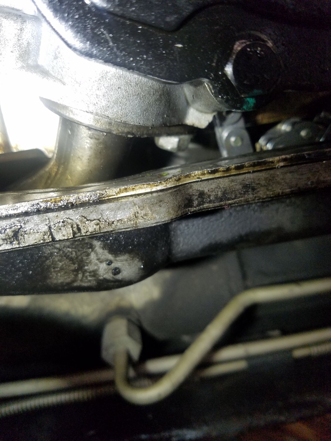

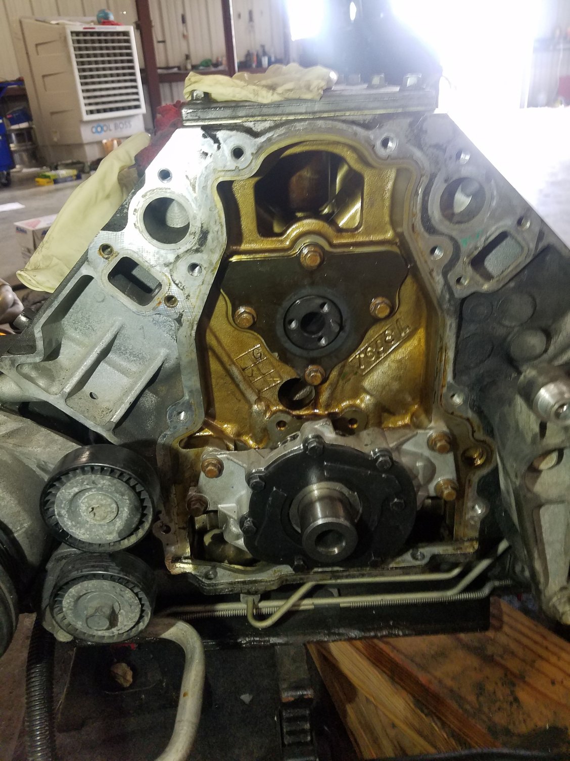

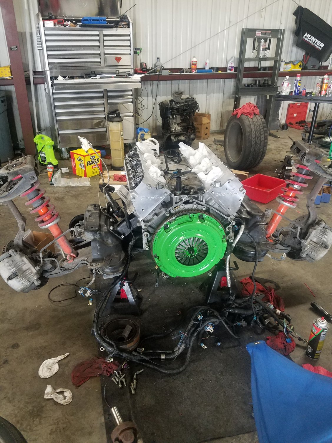

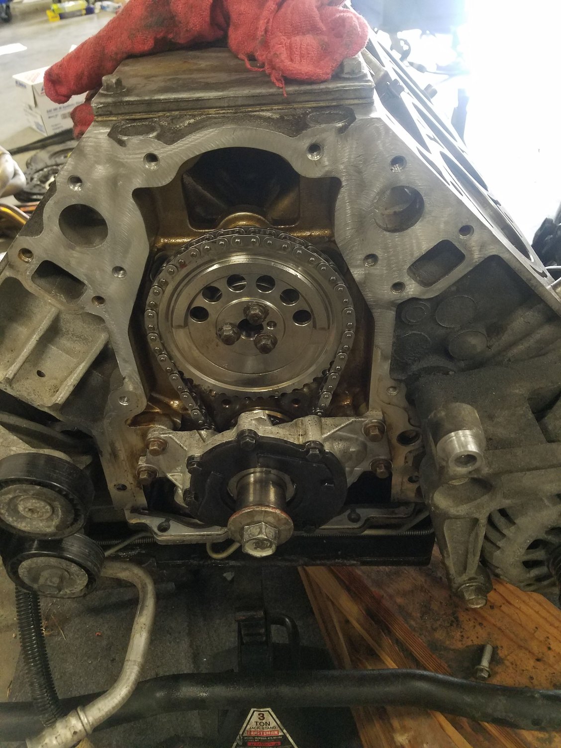

Cam timing gear on, new rpm speed ported oil pump. Did the rear main seal then changed pilot bearing. Oh yeah and then i dropped a lifter tray bolt in my motor and had to pull oil pan and windage tray to retrieve it that was fun....... cylinder heads intake and clutch tomorrow....

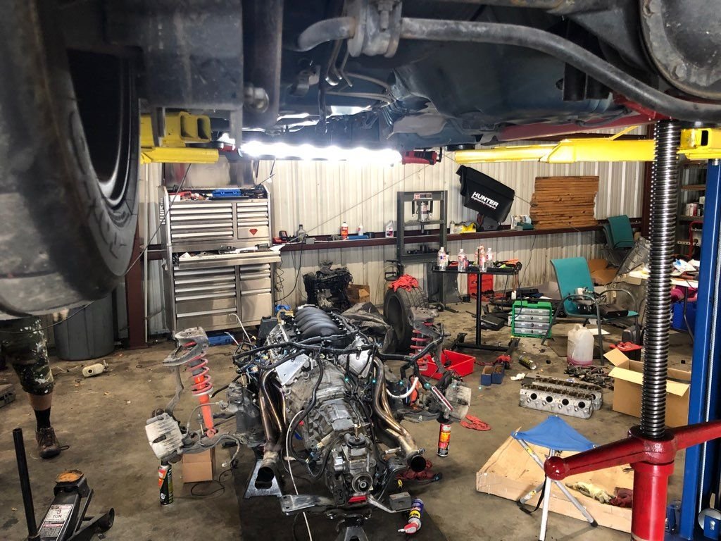

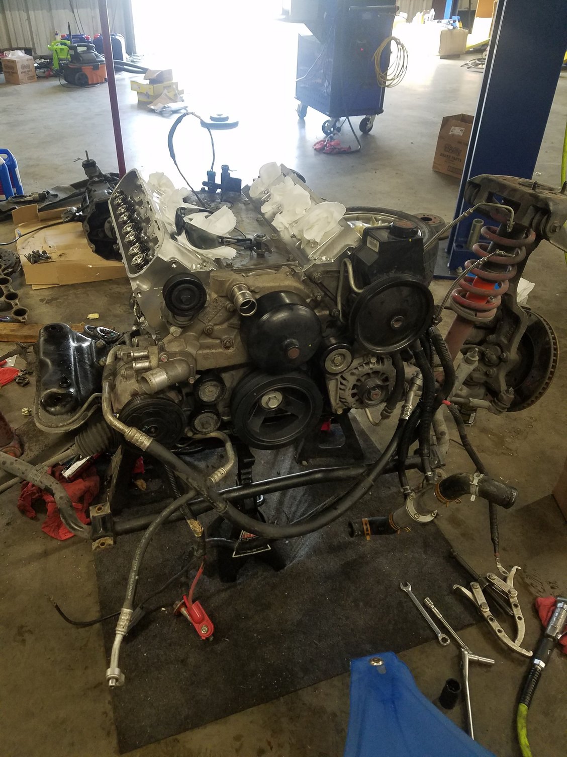

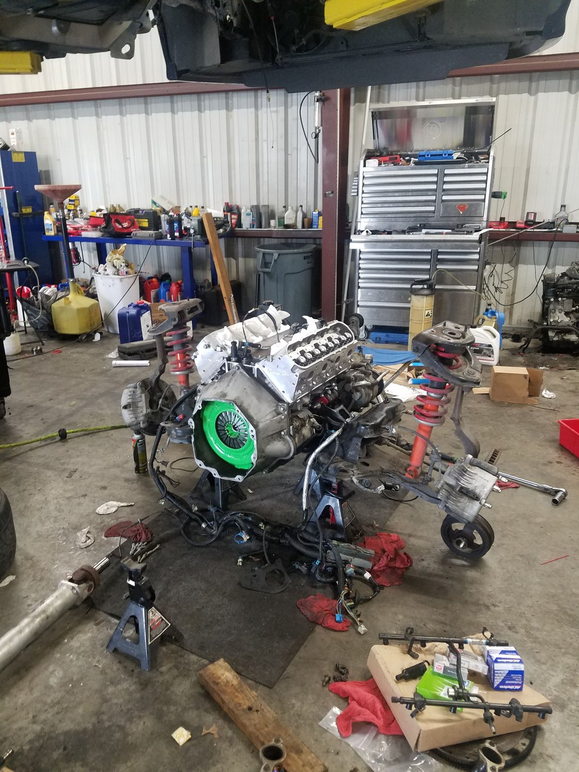

Heads on, clutch on blah blah blah, maven i dunno how you put **** together so fast inside the car....
Motor maybe in tomorrow....

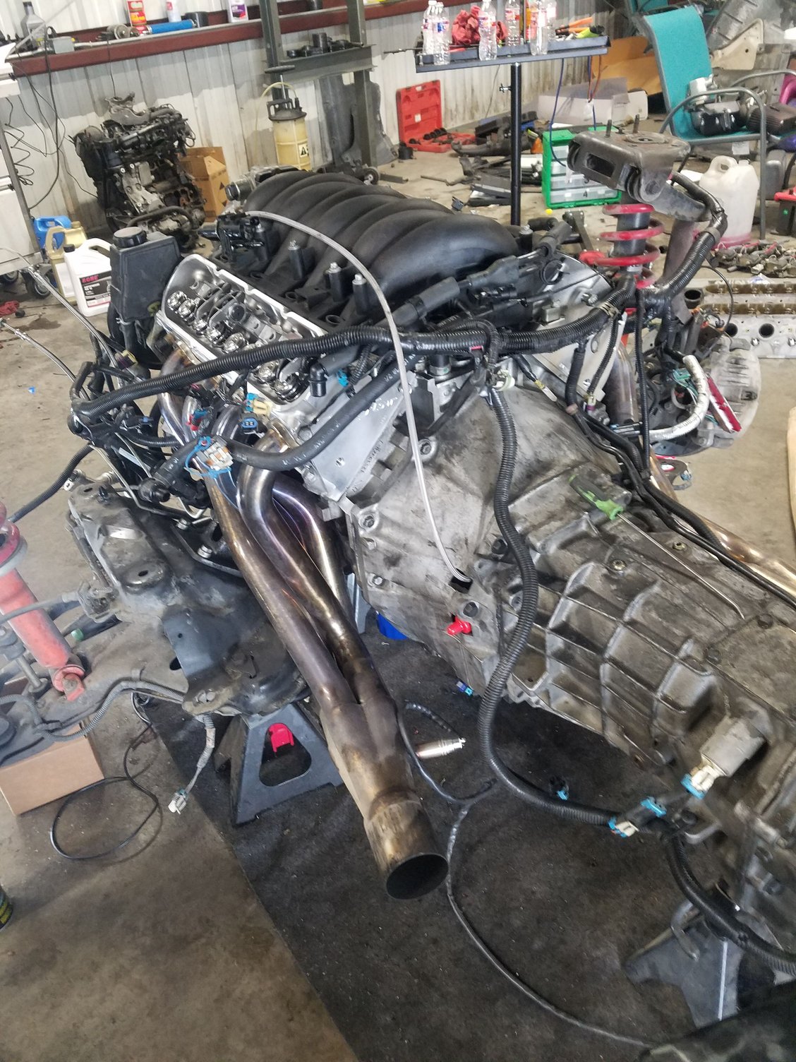

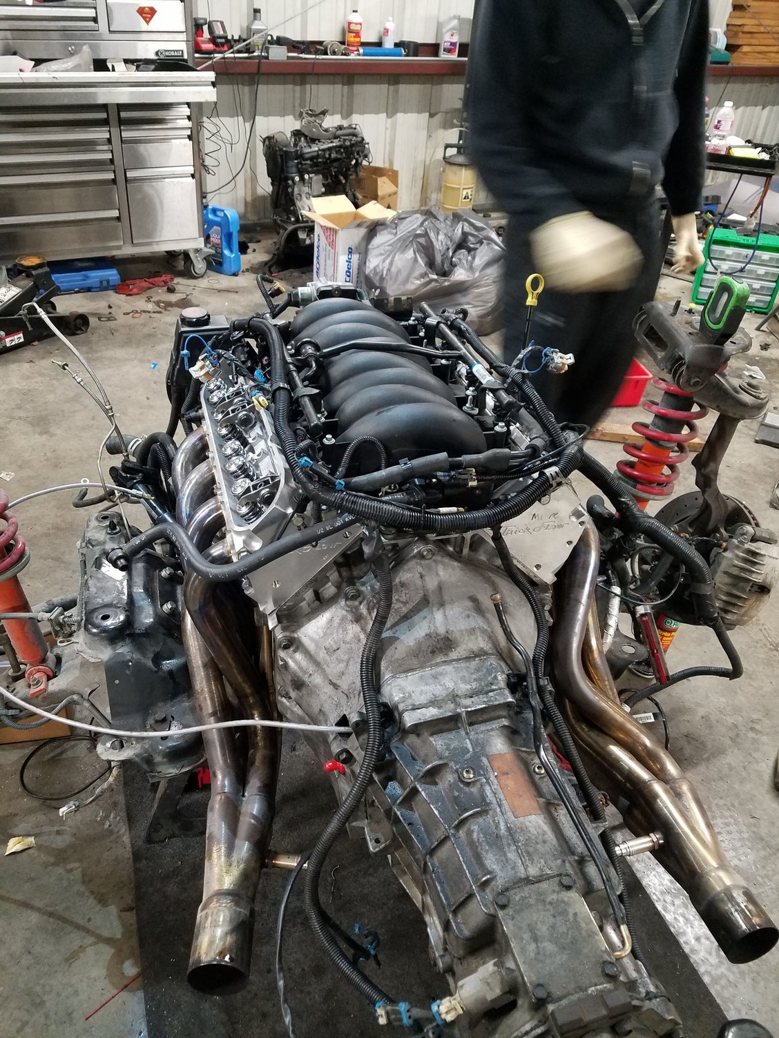

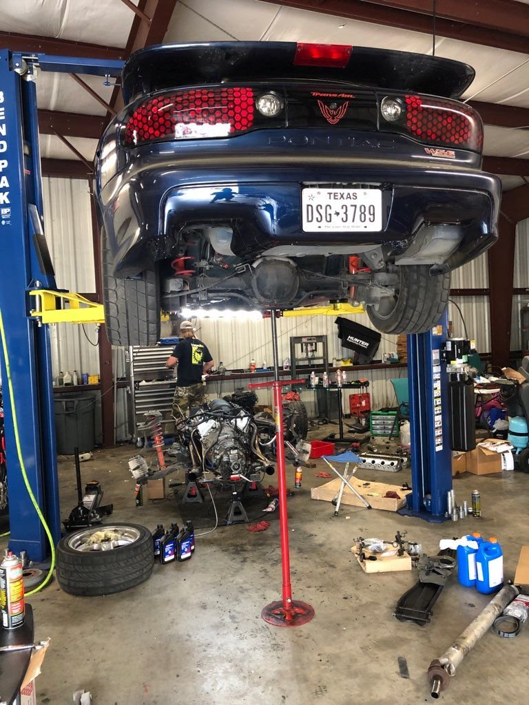

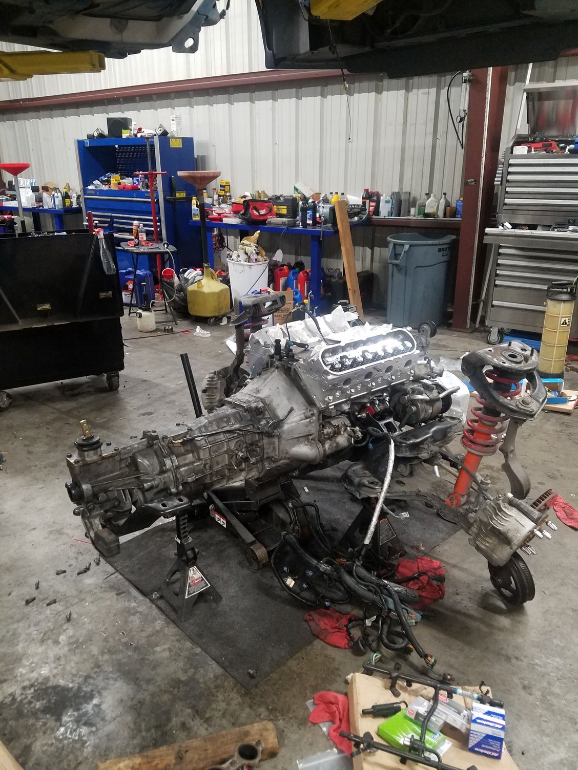

Motor is back in the car, my speed engineering true duals does not fit my texas speed headers that well... push rods ordered should drop em in and fire it up on Wednesday, then drive to exhaust shop to tweak my pipes. Dyno numbers in the coming weeks, 19th of april to be exact.

Started her up yesterday, getting exhaust fixed now.... data log the tune and should be slow rolling until i hit the dyno in a couple weeks, valve train sounds quiet like stock johnson 2110 lifter are money!

Holy smokes thos true dual speed engineering exhaust is loud as crap lol! But in a good way, it fit like **** had to hack it to bits but now it looks awesome. Zero rasp and extremely deep tone, this cam don't mess either. Had a couple of mild pulls today and let me tell you she pulls strong.
