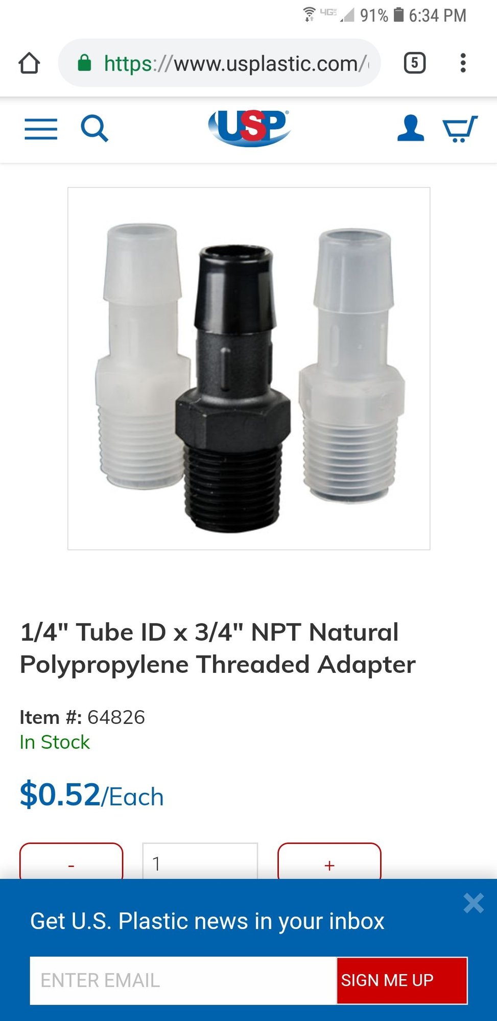

Put something like this in your silicone coupler. Done

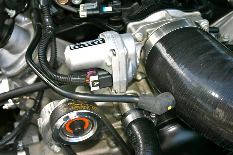

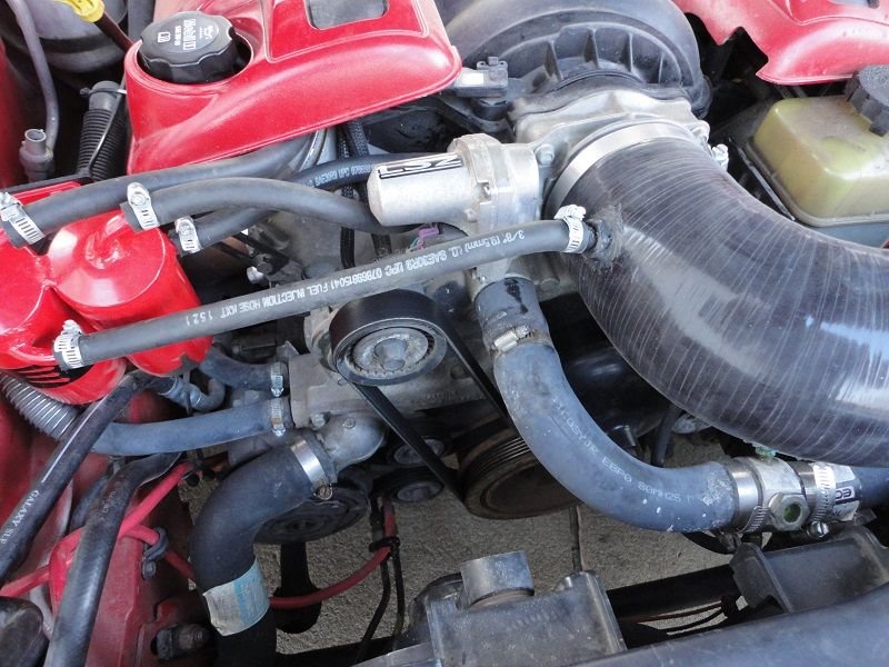

Originally Posted by ChopperDoc
The first picture looks like your EVAP hookup for the tank. I could be wrong though, but that's where it is on my FAST. Should be a click on for the EVAP line, not PCV. The vacuum for the PCV comes from the valley cover on the passenger side just behind the TB, and hooks to the passenger side of the intake, that's the vacuum "in". Fresh air should be routed from the hookups on the throttle body (aka + pressure source, not vacuum) for fresh air ventilation, or air "out". The stock line for fresh air go to both valve covers, then the TB on a junction/t style. I don't remember which way it routes, but iirc, it goes from the drivers side around the back, into the passenger side and to the TB on passenger side.
I know I have a bit of a different setup here, but you can see the EVAP can hooked up on D/S, the fresh air outlet on TB as well as fresh air hookup on P/S valve cover. Mine are capped off though, because I'm using a vacuum pump.
↑↑↑↑↑↑This setup right here is the way to go↑↑↑↑↑↑
Well done! My plan is to go with a vacuum pump at some point but for now it's just 10AN lines off each valve cover to a breather can.

Found these.
