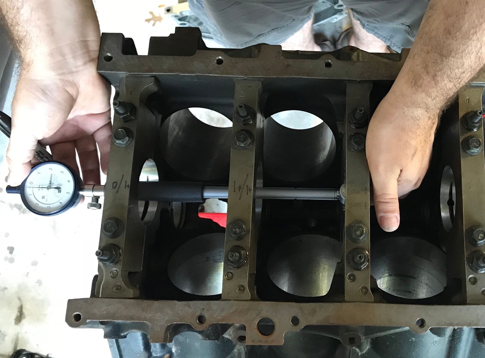

Last night was Day One as I started on the block by measuring the main housing bores with the main cap bolts torqued to OEM spec. The tolerance for the bore ID is 2.7509” to 2.7515”. I’m using a Mitutoyo dial bore gauge that was set to read zero at 2.7509” and marking on the caps how much bigger the bores are. All of the bores are within tolerance, with the #3 main bore being the loosest at 2.7512”. This is an important measurement that you usually wouln’t measure with plastigauge, which to me, justifies the cost of a dial bore gauge.

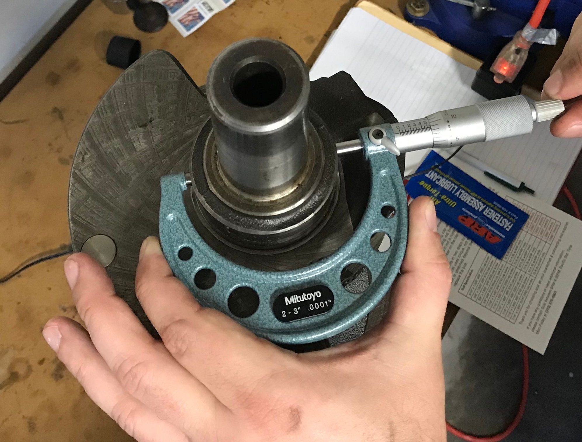

Next I checked the crank journal OD’s using an OD micrometer to verify what bearings I will need. The tolerance for the mains is 2.2247” to 2.2252” and on the rods, it is 2.0990” to 2.1000”. If the crank had been ground, the meaurements would obviously be lower. I check for taper and out of round by meauring in several spots around and along the journals. The journals all checked out within tolerance and less than .0001” taper and out of round.

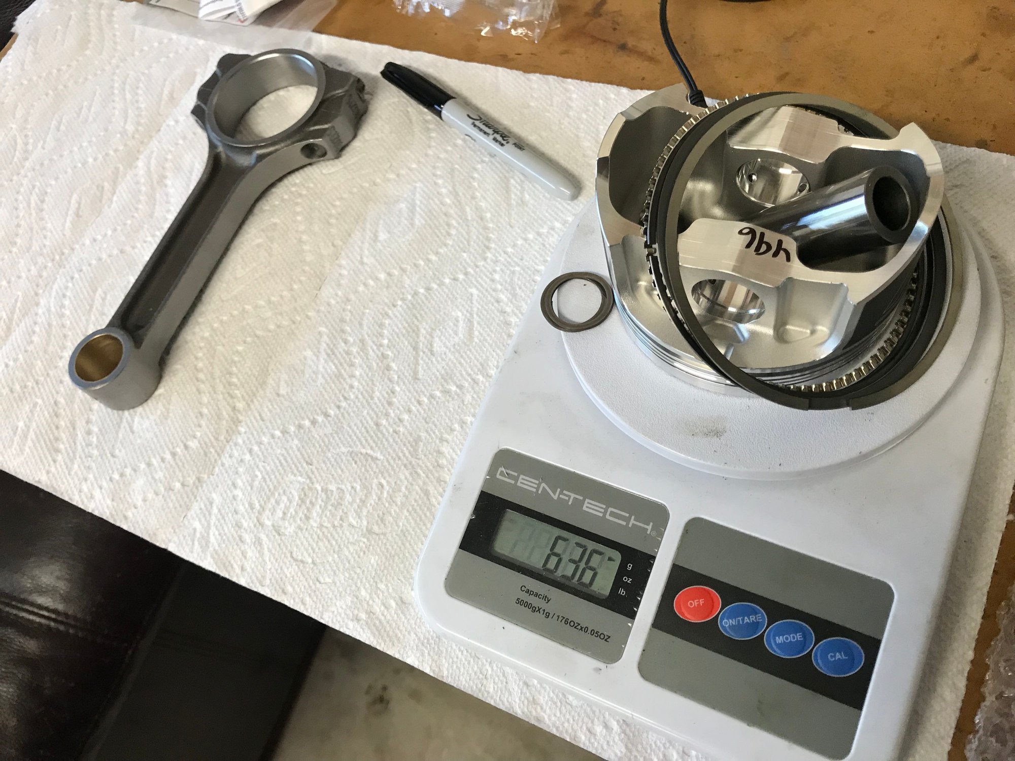

The crank will need to go to the machine shop to get balanced, so I weighed the components to calculate the bobweight. If you provide the bobweight, most machine shops will charge you less since they don’t have to do it themselves. I’ll be using Wiseco 4.030” bore flat top pistons with Scat 6.125” I Beam rods and ARP 8740 bolts.
I still need the rod bearings to calculate the bobweight, so I’ll order them now that I’ve verified the crank hasn’t been ground and I will get the crank balanced after they have arrived. For now I’ll send the block to the machine shop to bore and torque plate hone the cylinders and the skim cut the deck surface.
