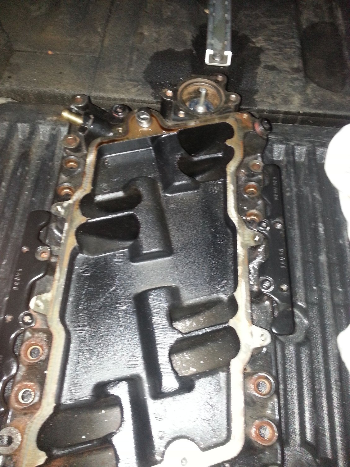

Small ports for velocity and longer runners promote low end torque. I suspect the older fuel injected Vortec engines have longer runners.
Those old Vortec engines basically don't have runners; it's a two piece intake manifold, with an upper half and a lower half. It's hollow on the inside, just a big, open chamber, and the injectors are inside of it.
It blew my mind the first time I ever took one apart.
To the original poster: An old-school 383 will probably be cheaper, and won't disappoint you on power.
But this is an LS board, and most people will try to talk you out of it.
Old school Vortec 383 gets my nod.
The L31 intake does have runners. They are crossram oriented. Combined with the cylinder head port length the total intake runner length is close to 12" long. The plenum is choked with the spider system. The Marine L31 intake has external injectors. The L31 marine manifold breathes much better. I have one that I heavily ported sitting on top of aluminum heads ported to 210cc intake ports. I am making 395 rwhp @ 6,000 rpm. Over 300 ft/lbs of torque @ 1,500 rpm with a peak of 380 @ 3,800. I am swapping the marine crossram out for a marine dual plane with a 4bbl to 102mm intake elbow and 102mm throttle body. My next engine is going to be a Dart block with a 4.125 bore × 3.875" stroke.
