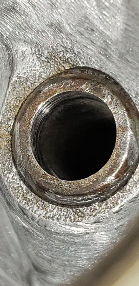

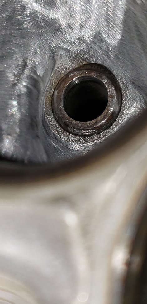

I was cleaning up the casting marks and grooves in the exhaust runners. I accidentally kinda went into the guide with my tapered sanding cartridge. It scuffed about 1/8 down into the bore on the seating side.
Am i screwed??
It was 120 grit

Not worth worrying about.

Oil retention grooves
