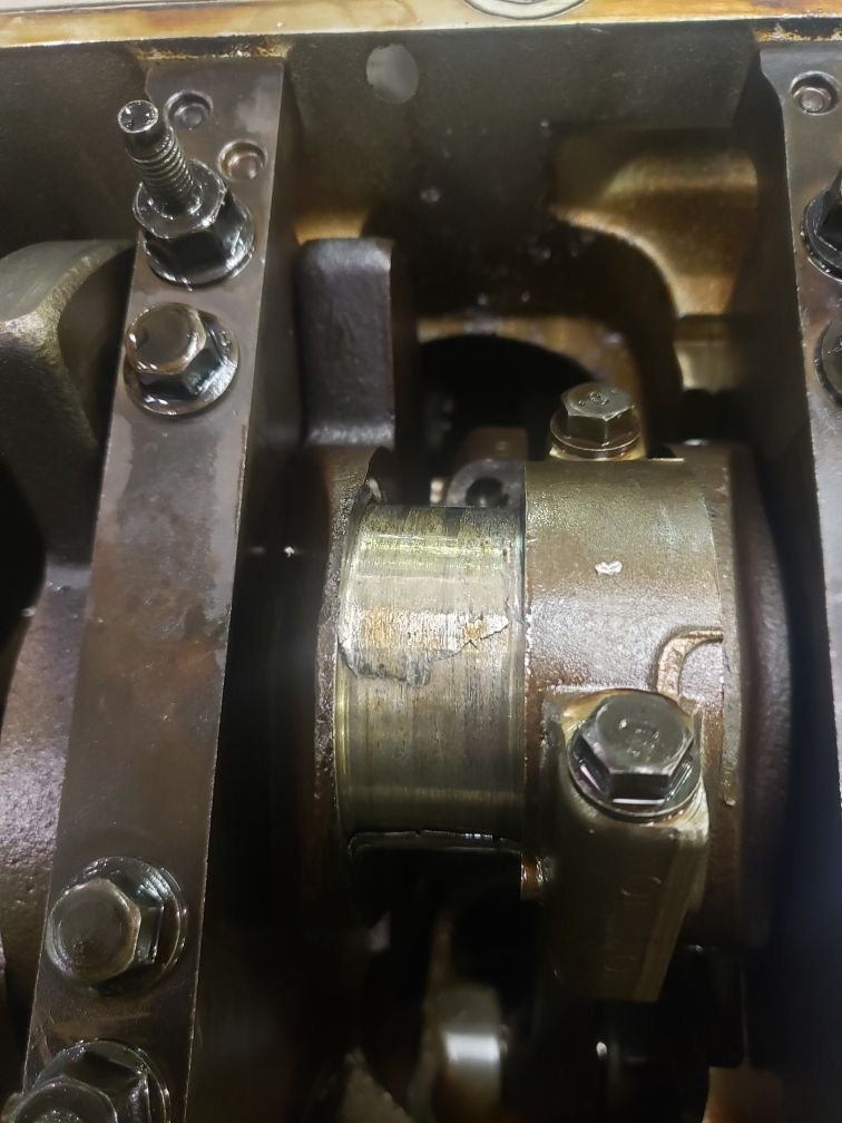

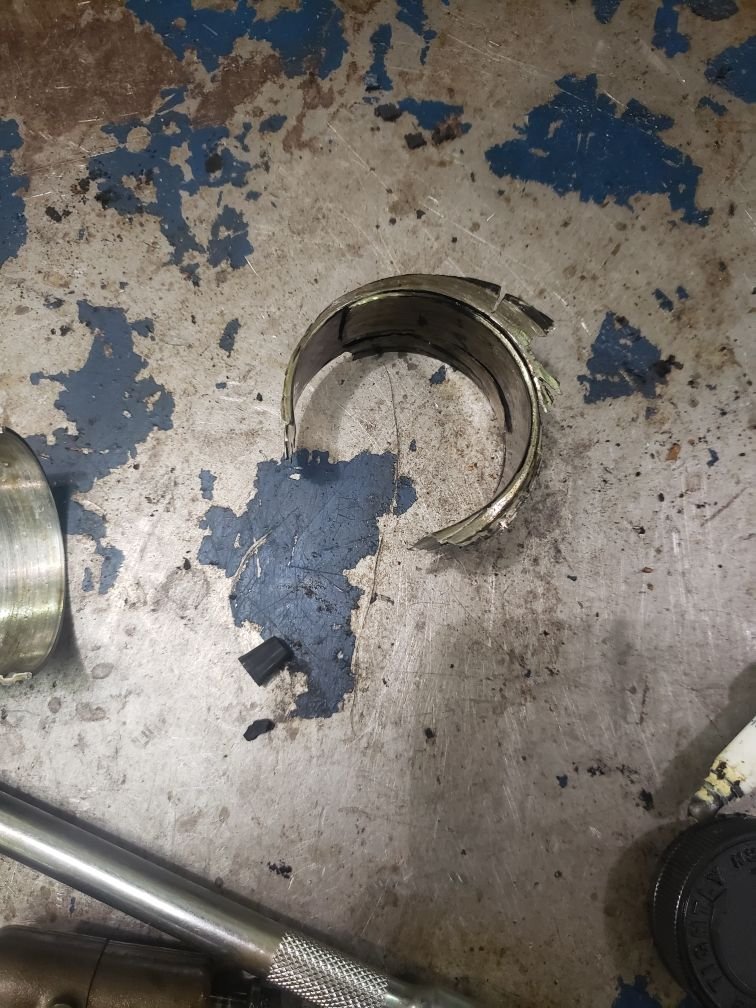

Just a quick update, found the smoking gun. #5 and 6 rod bearings spun and were subsequently chewed up pretty good. Also confirmed our suspicions that the bottom end was completely stock, GM crank rods and pistons.
So against almost all advice, I think I'm pretty much decided on the idea of rebuilding the LS1 with a 383 bottom end. The more I look, LQ4/LQ9's are going to run me at least another $1K, plus the time needed to source one and get it back to the shop (no small feat when all you have is a 5th gen). That would be going the junkyard route as well, and I'm not sure I want to risk the block being cracked or otherwise too damaged. If the block I have is good, it seems easiest to just re-use it. We should have the block in the machine shop on Wednesday to get cleaned up and measured.
