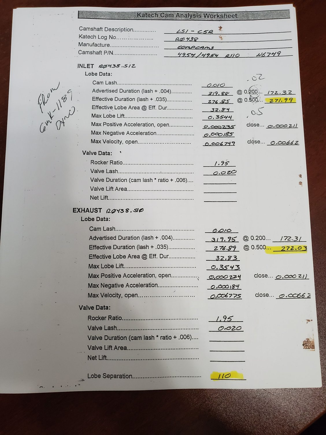

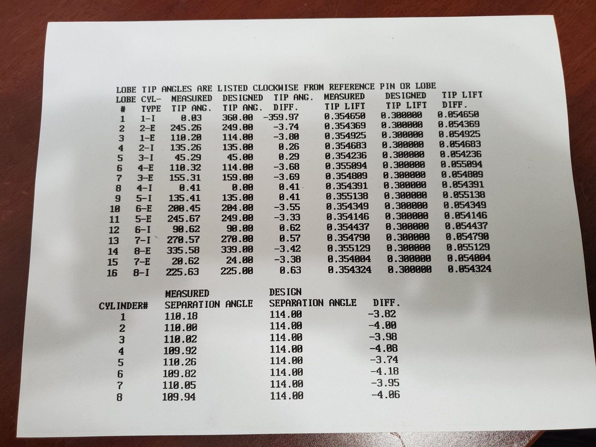

Here's the Cam spec sheet from Katech

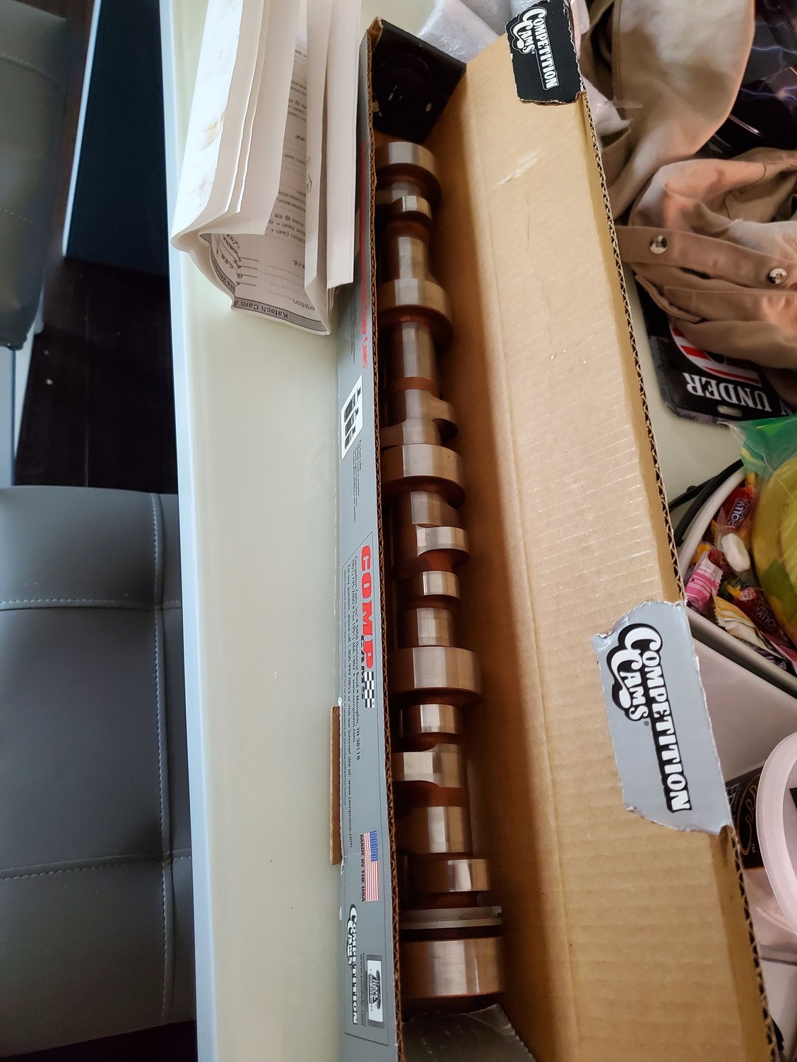

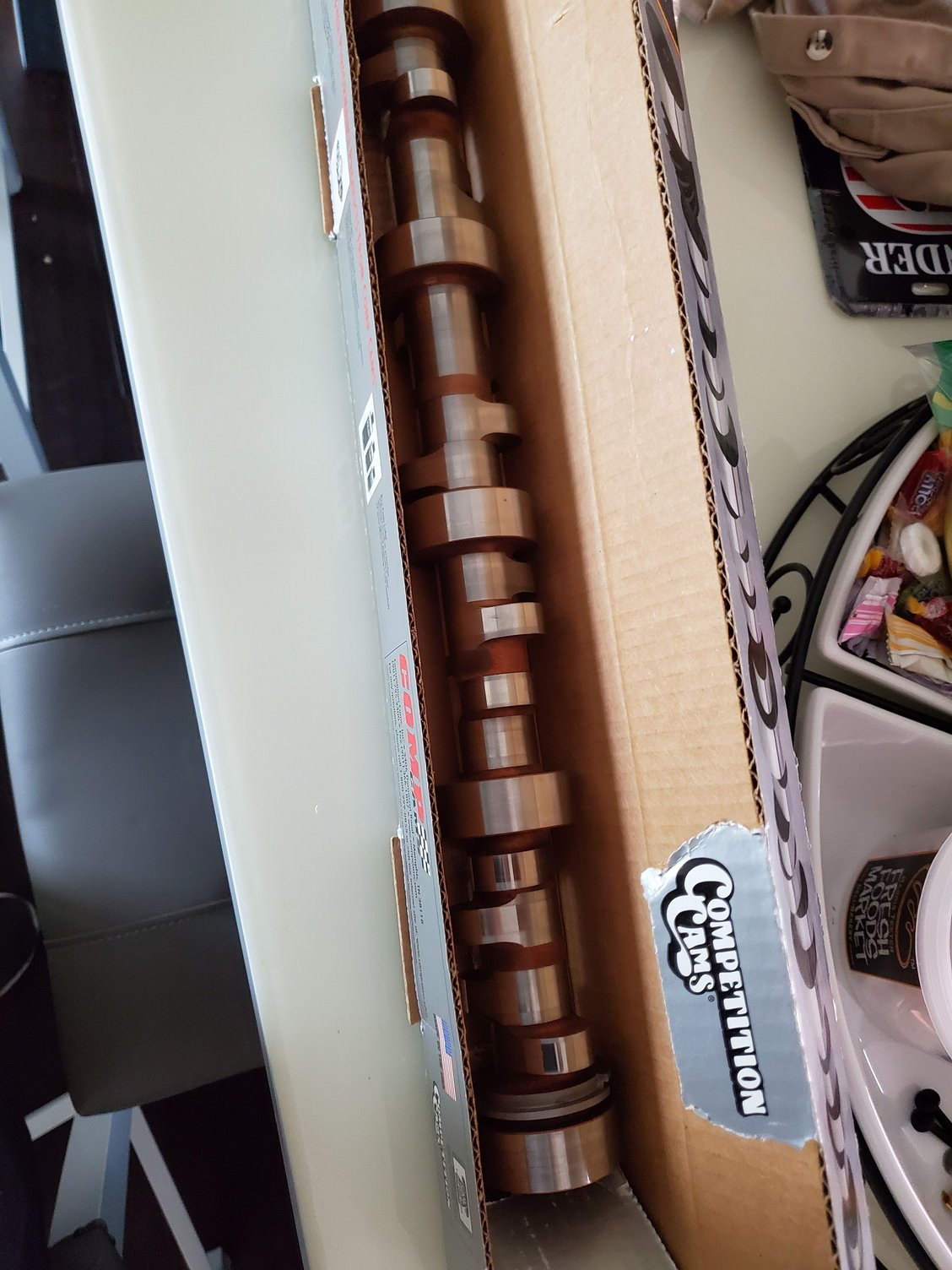

What is everyone's opinion with this cam, I've never seen one that looks even remotely close to this one. Especially with rounded edges. Was that designed for more meat on the cam to be a bit stronger with the big valve springs and the solid roller combo? Also looks like maybe ot was Titanium Nitride coated maybe? It was designed for 24 hrs racing series. I've noticed these C5R parts are exceptionally well engineered and manufactured to a very high standard. Would love to hear some comments
Old Jul 2, 2019 | 09:47 PM
Posts: 22,288
Likes: 3,615
The way that cam looks is the result of grinding into the base circle, or the actual shaft diameter. Gonna need longer pushrods fer sher...
Definitely, it is a very small base circle, which explains how it gets it's big specs. Also feels much heavier than a standard ls cam. Not too sure on material

The cam core is probably not hollow due to the shorter base circles

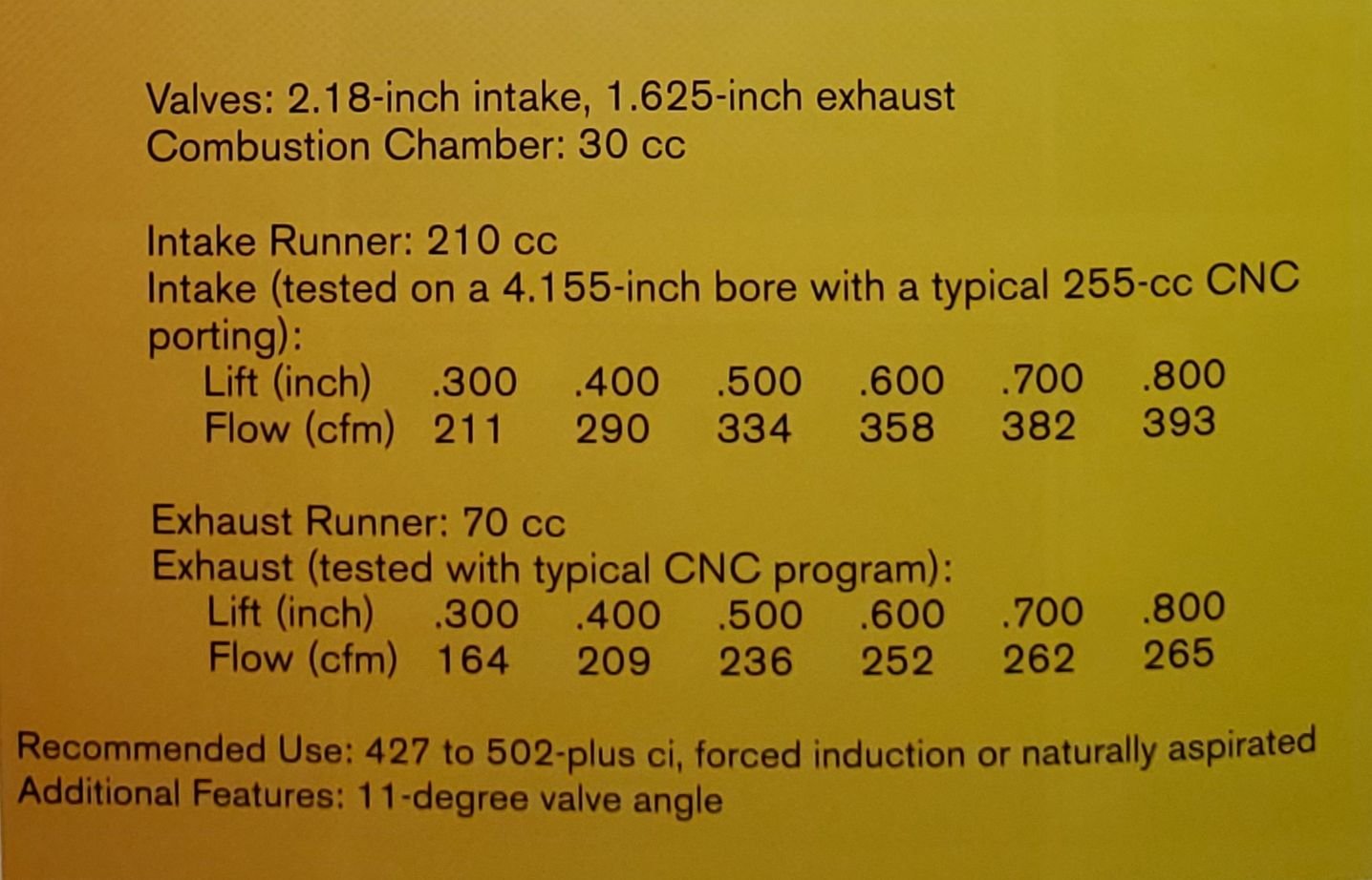

another example of where flow numbers dont mean everything
Old Jul 4, 2019 | 11:26 AM
  #35
Darth_V8r's Avatar
Moderator
Joined: Jul 2014
Posts: 10,451
Likes: 1,872
Insane flow through a 210cc runner
Old Jul 4, 2019 | 12:10 PM
  #36
moekluse's Avatar
Joined: Nov 2015
Posts: 543
From: Nc
Pretty serious flowing heads
not saying they dont flow, but people always want to see over 400 cfm somewhere. but yea on a 210 runner the numbers are ridiculous. i basically meant to say something along the lines of, "these 380 cfm will outperform most heads that produce over 400 cfm" so another example of where final flow numbers dont mean everything
Old Jul 4, 2019 | 03:43 PM
  #38
moekluse's Avatar
Joined: Nov 2015
Posts: 543
From: Nc
Yea I understood your comment and completely agree
Old Jul 4, 2019 | 03:58 PM
  #39
Darth_V8r's Avatar
Moderator
Joined: Jul 2014
Posts: 10,451
Likes: 1,872
Here here. My post was agreeing with yours.
