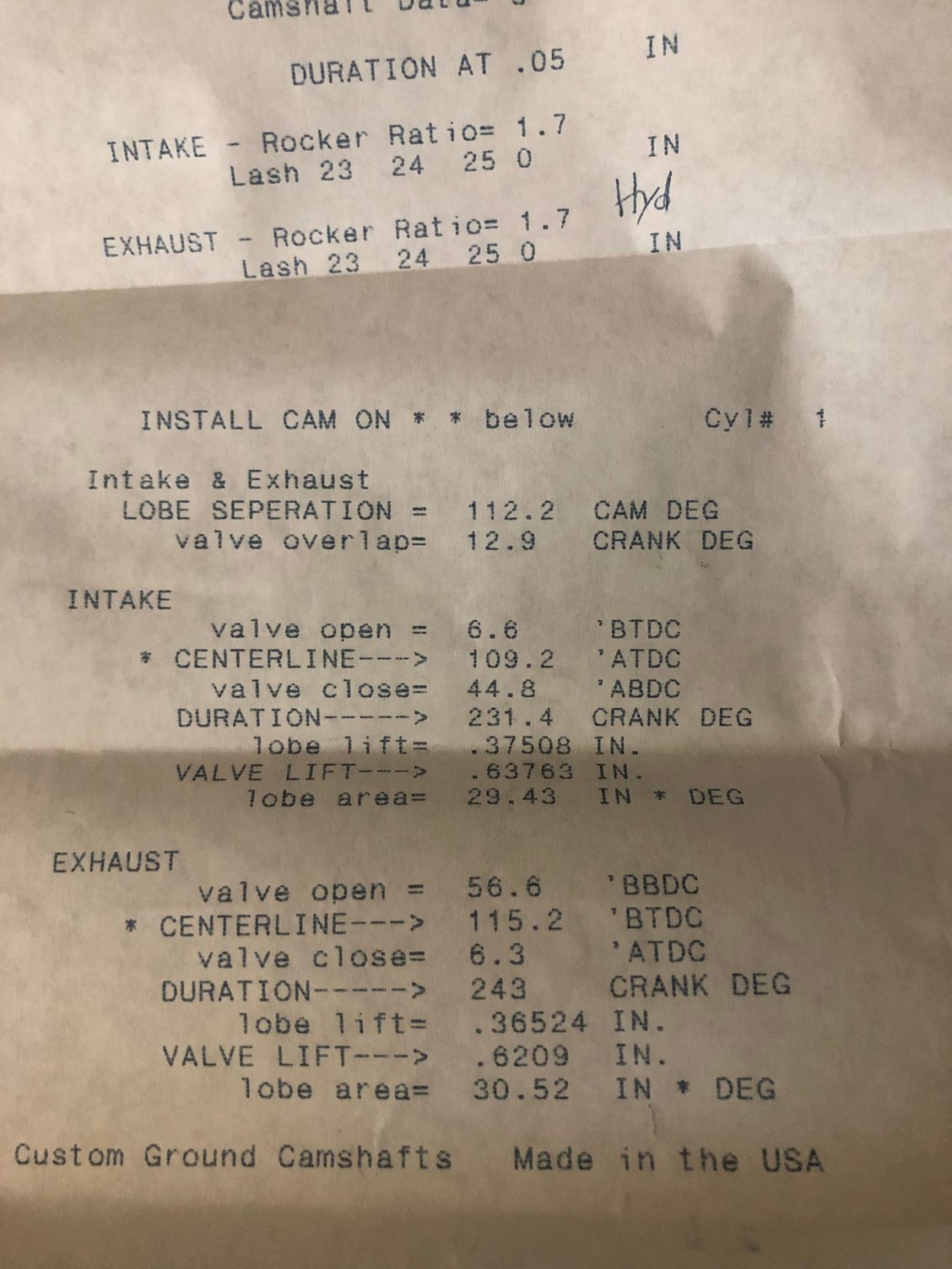

Figured i would throw my cam card up to see what your thoughts are. My car is in the shop now getting the heads, cam and intake put together.

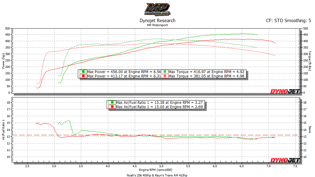

Just got done tuning my friend's c5z last night with the prc 225 heads. Very impressed with how they performed no doubt. Still on ls6 intake/Tb, vararam, usual long tube exhaust setup. Made 455whp back to back, 91 octane, no time for cool down runs for that 460+ run. With a fast setup and maybe some e85 I don't doubt we will see some very impressive numbers from the old sbe ls6 😎

Tsp magic stick per there suggestion. If I had a little more time I think as is could of probably squeaked out close to 465whp. This is on a 120k motor that has seen alot of autocross and hard miles. Very impressed with how they performed.

Here is my 01 ws6, btr stg 3 cam, hand cleaned up stock compression 241 heads, same ls6 intake, mine does have 4.10s,basically everything else the same, same day, same 91 octane out of the same pump. His 225s are 62cc with .040 head gaskets.

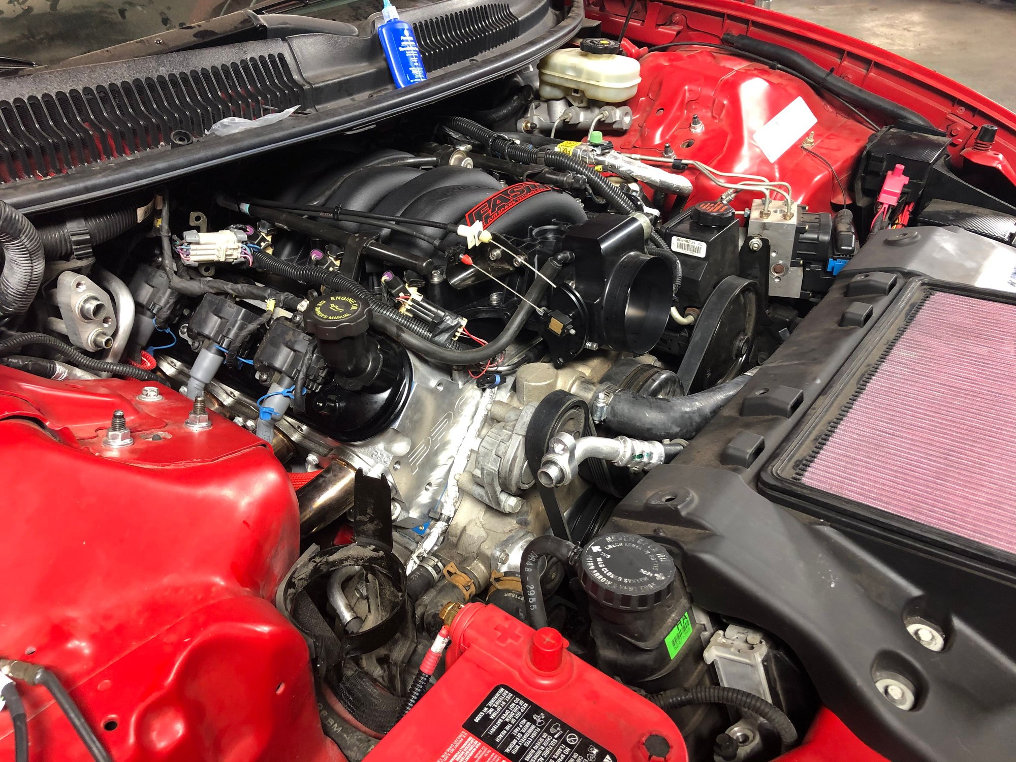

Figured i would do a little update. Fired her up for the first time.
PRC 225s
BTR 231/243 112 custom cam
Ported FAST 92/NW 92
Cant wait to get it buttoned up and on the dyno!
